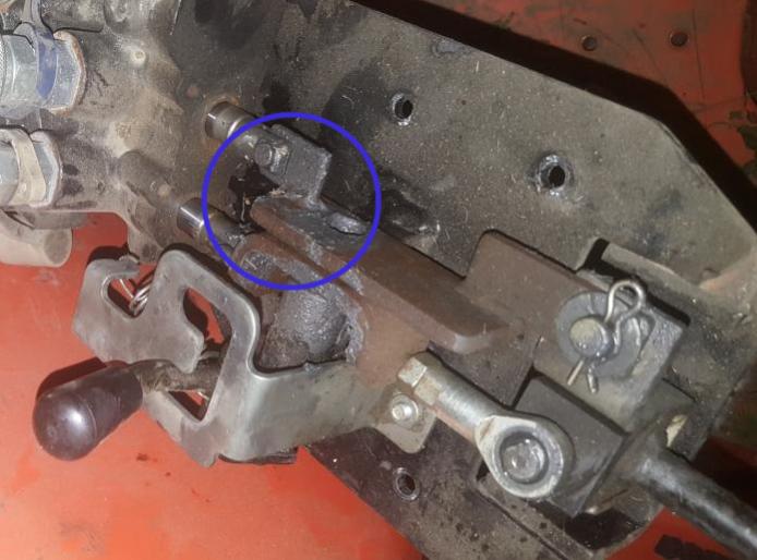

Is this (circled in blue) the part you welded?
If so, shifting the exact position even slightly will make a difference in the point that the functions actuate when multiplied by the lever length.

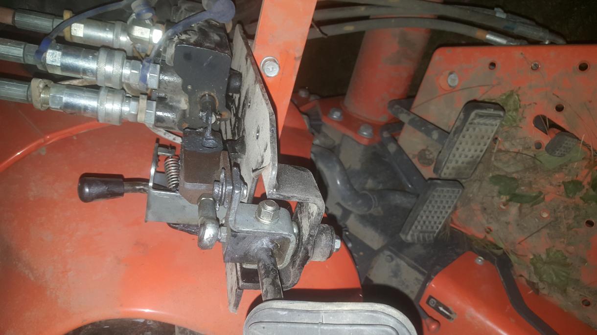

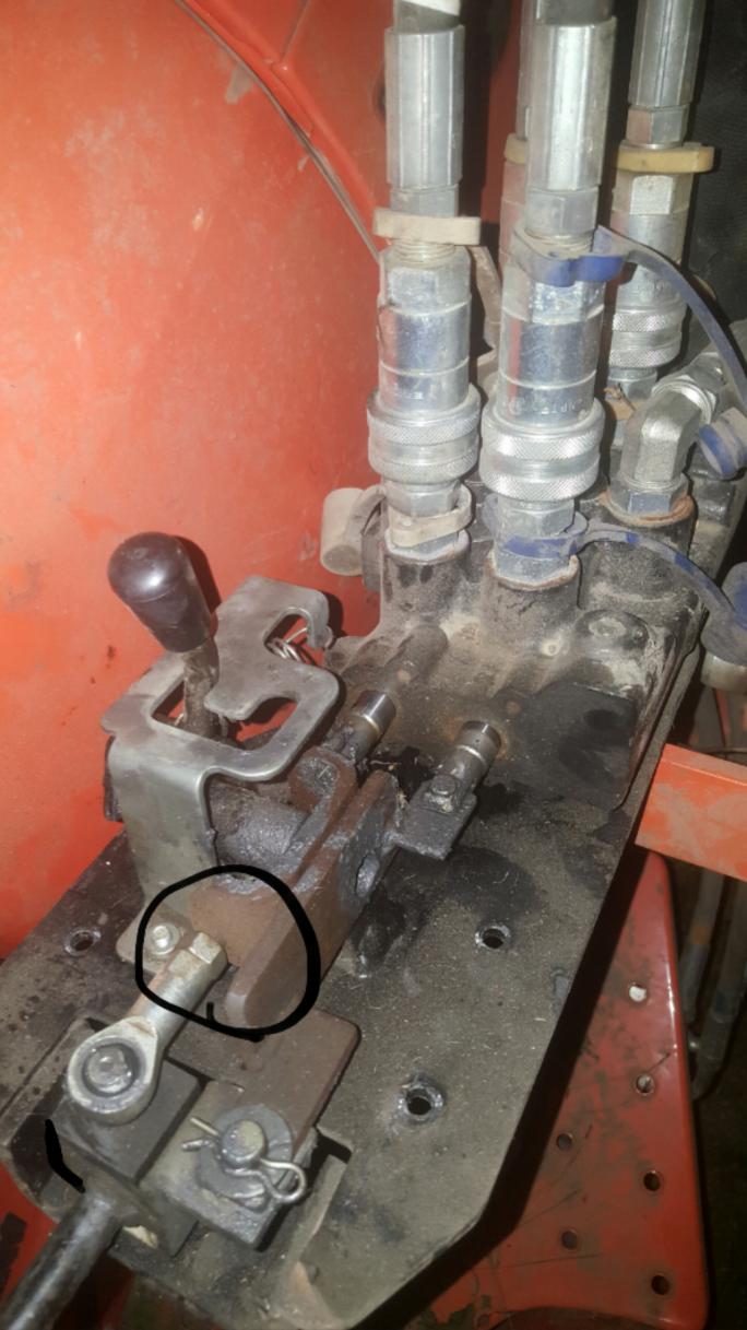

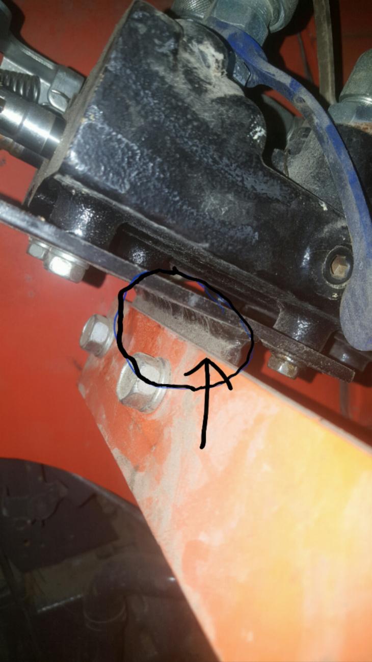

This is the bracket I welded. I never unhooked any of the those lines except for the bolt that holds the lever in place.
Is there some way that the bolt can affect the throw of the lever or the location of the fulcrum? If you look at the amount of shiny spot on the spool valve and compare that to the travel at the end of the lever, I imagine you will discover that it would not take much change in alignment to make a noticeable change at the lever.
