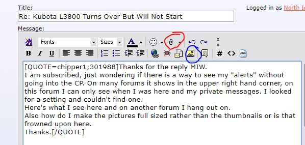

Upload a photo via the paper clip (Red circle), then scroll down the reply page and you will see the upload in orange, right click copy link address, go back up click on the Insert Image(blue circle) the paste link, done
