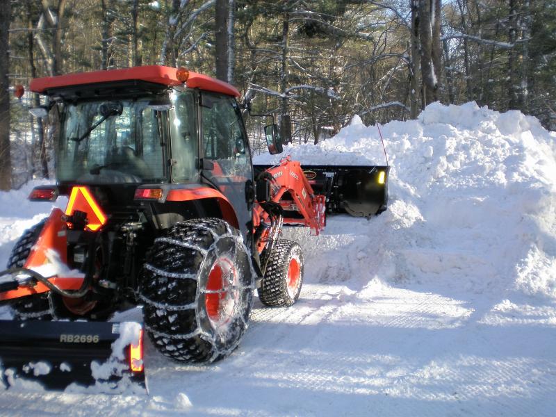

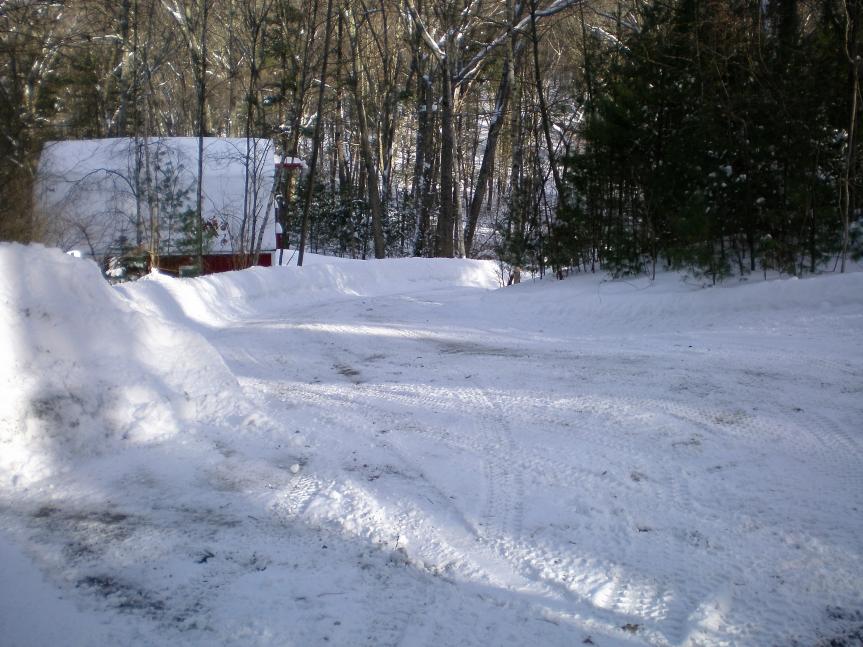

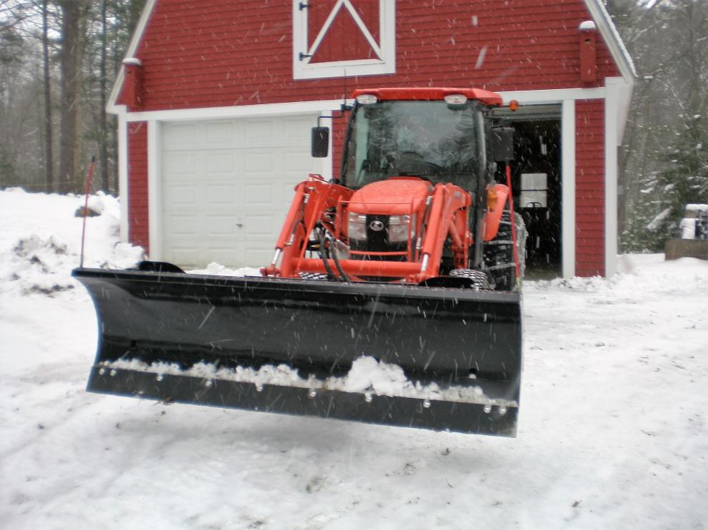

I've had my L3560HSTC for 3 yrs now and LOVE the heated cab in the winter. I always used my pick-up truck to plow and always ended up helping everyone that knew I had a plow. The trucks rotted out and I went with a front blade on my tractor. Works great along with my rear blade for smoothing out or when the ground is soft like the first and last storms of the year. My drive is close to the length of yours, 1000'. I have been toying with the thought of a rear blower, that way I can still use the blade or bucket on the front, you never know when you'll get so much snow you need to re-locate a snowbank.
