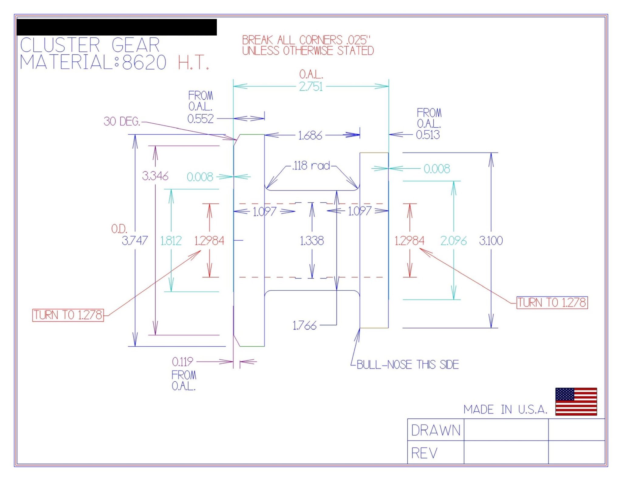

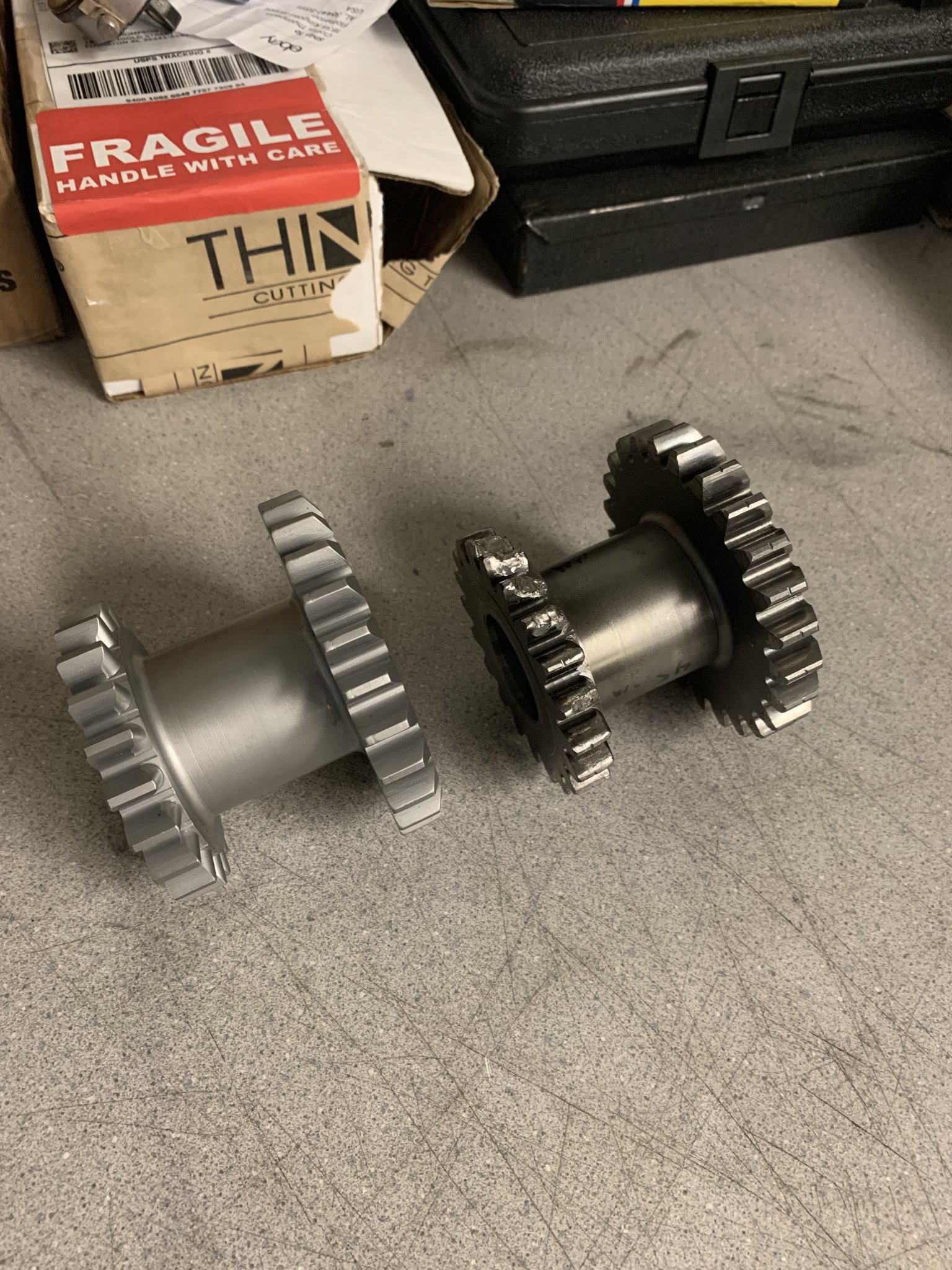

I just received the gear a couple of days ago, but haven’t had the chance to start putting everything back together. Hoping to start next week! It is absolutely perfect, looks like it came from the factory!
I also received the blank sketch as well! Doesn’t have any of the gear teeth data on it but it does give all of the specs for the gear blank.

Very nice. Cutting those compound gears can be a little tricky and expensive to make. Lots of material removal just to make the blank and typically not enough clearance to hob the teeth so they have to be shaped. I have also worked on one application where the teeth have to be clocked exactly the same to prevent binding. Did you have the teeth hardened and would you like to share how much that set you back?

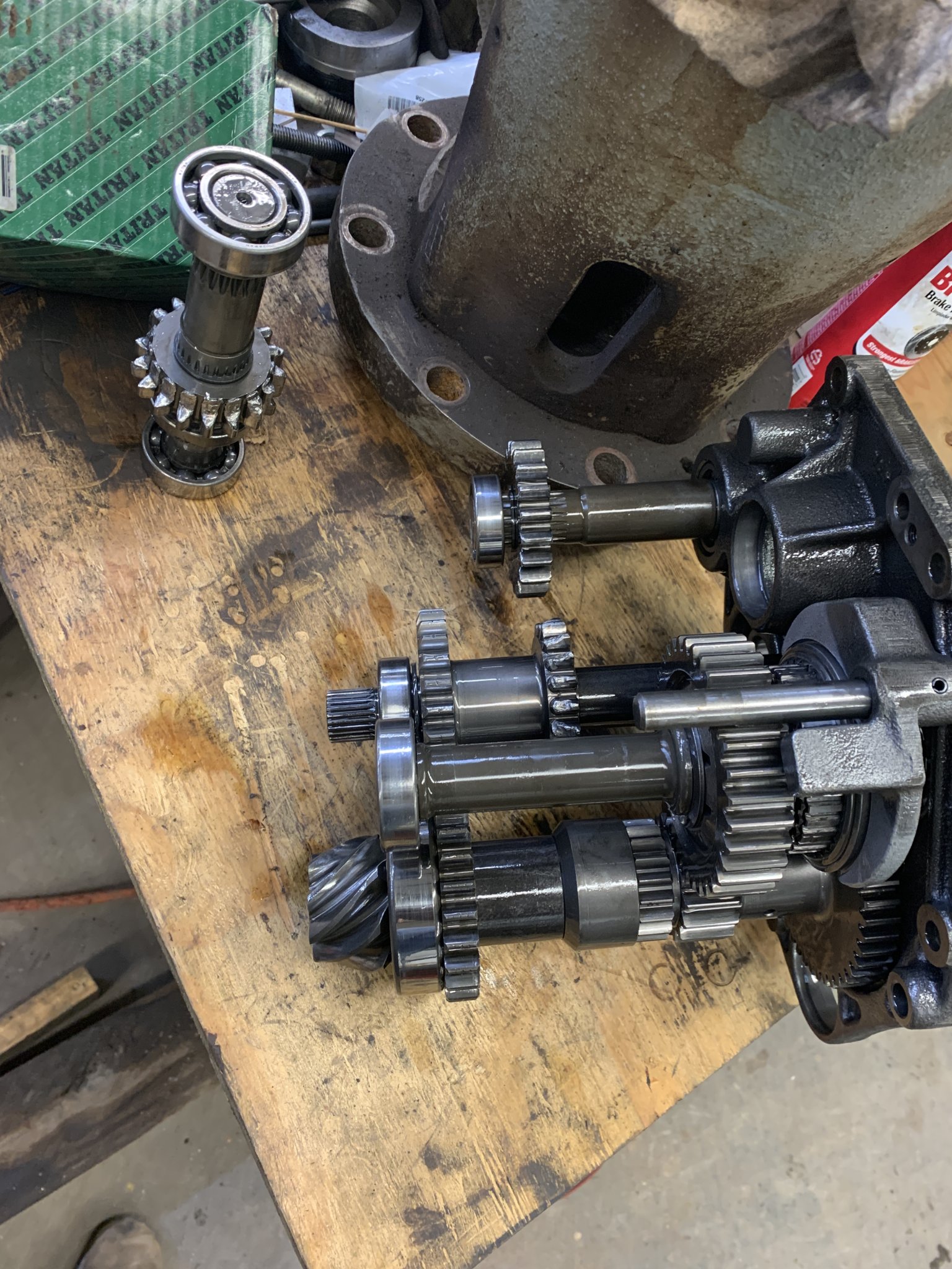

The gear was sent to a heat treating facility prior to grinding the bore to finished size ID. Total gear cost was 1850 plus tax. Close onto 2K for the whole thing by the time I got it into my hands. Since there was metal shards throughout the whole transmission/Mid case we decided to check all of the bearings for wear… They are all worn/hazy, so we are ordering new bearings for everything. At least when we are done it will be brand new! Probably going to even do a paint job!
