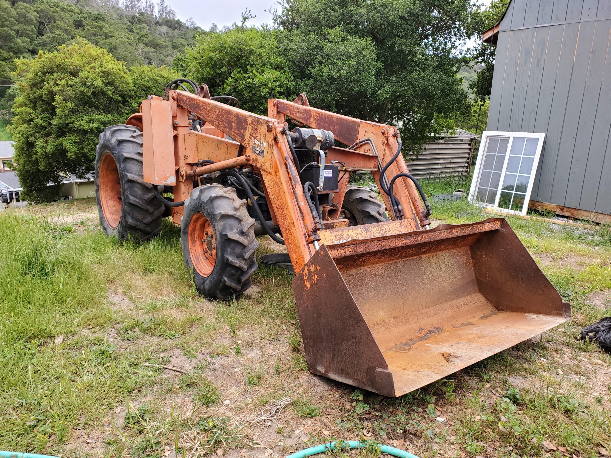

So recently bought a kubota l345dt as a project. Previous owner said it needs a New headgasket since there is oil in the radiator and grayish like liquid coming from vent tube.
Before I get ahead of myself is the headgasket the problem?
I have a new head gasket on the way and il be replacing it as soon as it gets here.
Any tips advice or comments? any service manuals available for the v1501-de engine?

I thought about removing the loader(l1720 model) looks like extra work to remove and reinstall. I might have to just raise it and chain it to a roof rafter or use engine hoist somehow

For replacing a head gasket, taking off the 1720 loader is a lot of extra work. Same is true even if splitting the tractor. Much better to leave the loader in place, with bucket raised up and supported on wood posts and/or with 2" ratchet straps from the rafters (raise it while the tractor still runs). If the job escalates into needing work on the block, the tractor can still be supported at the clutch housing for unbolting and rolling the front parts forward. Go slow, think it thru, you'll do fine.

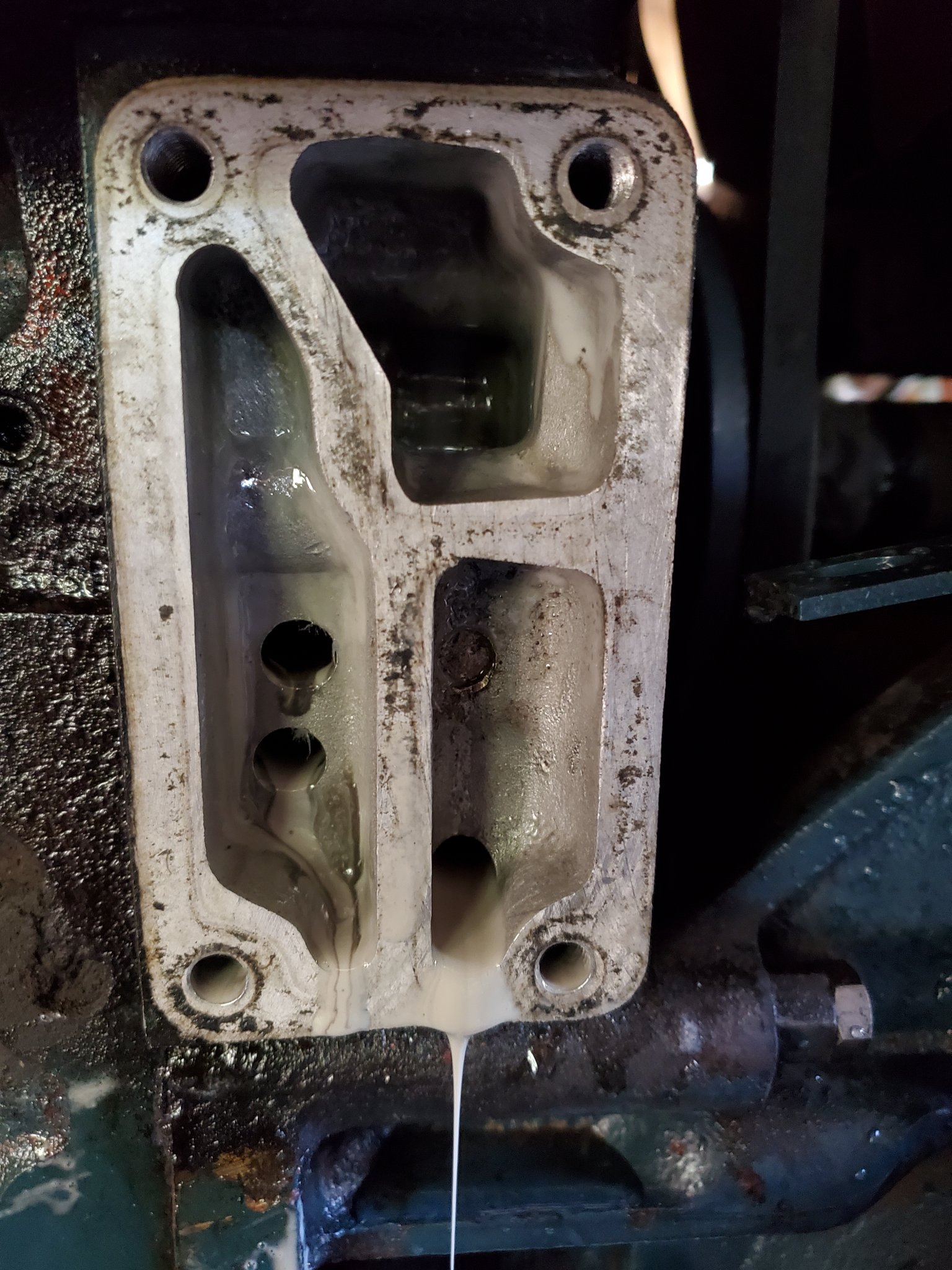

Pulled the head today. No signs of cracked head or bad head gasket. I'm thinking I might have a bad block. Any ideas? Should I take the head to a shop to have it inspected? what cost I'm I looking at ?

The blocks are never bad!
Water / coolant getting in the oil with a bad head gasket is very very rare.
It's more likely to to just burn water/coolant off.
There is a frost plug on some models behind the front gear case that can leak, also a front case seal leaking will make it put water/ coolant in the oil.
Cracks on these heads are almost always clearly visible, they will show up between the valves and the prechamber.
Take some good pictures of around the valves and I can almost always tell you if there is a crack.
Also look at the top of the pistons, one if it has a water leak will look completely different then the others.

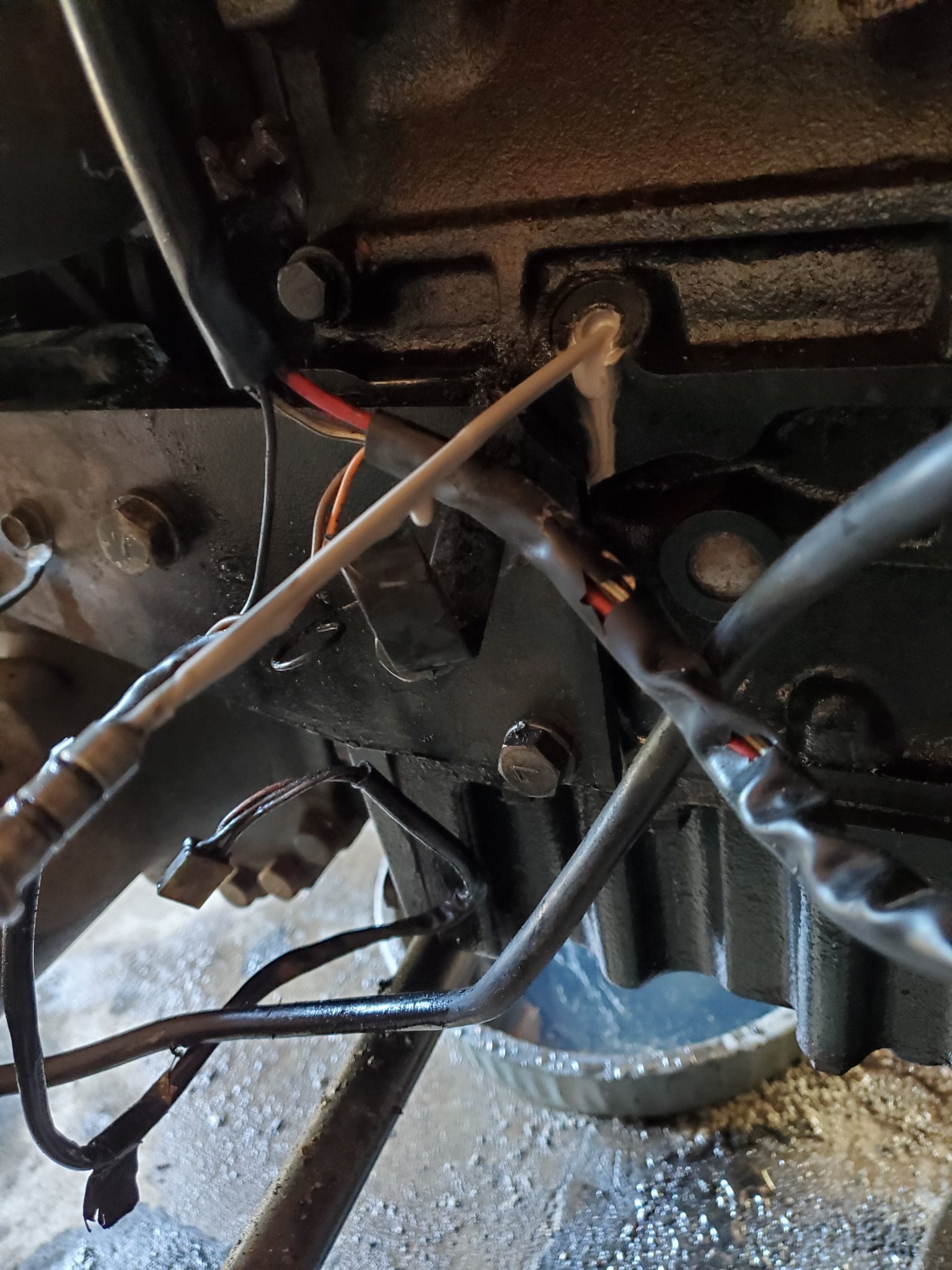

If you have shop air or a portable tank, try to pressurize the radiator (don't over-do it) and see how fast it leaks down - and whether you can locate the sound of air leaking inside the engine. Maybe put the oil filter housing back on and open the oil filler cap on the valve cover to let air escape. To leak that much coolant into the crankcase oil in a short run time, the leak is not real small.
The water pump mounts on the outside of the gear case - but the case gasket 011 seals the water pump area where it reaches through to the block. It might be leaking there ?? I don't have experience taking off that case - it looks like the axle has to move away to take it off. Maybe someone else who's been there chimes in -

Thanks for the reply. il be pulling the front gear case just don't want to pull head and again. I have 1 leaking freeze plug on the side of the engine and someone has plugged up another in past with a rubber plug. I noticed there is a freeze plug looking type of plug inside the crankcase. I don't know maybe that one inside is bad too? I don't know, il be pulling the front case soon hopelly it's not a big Job.
