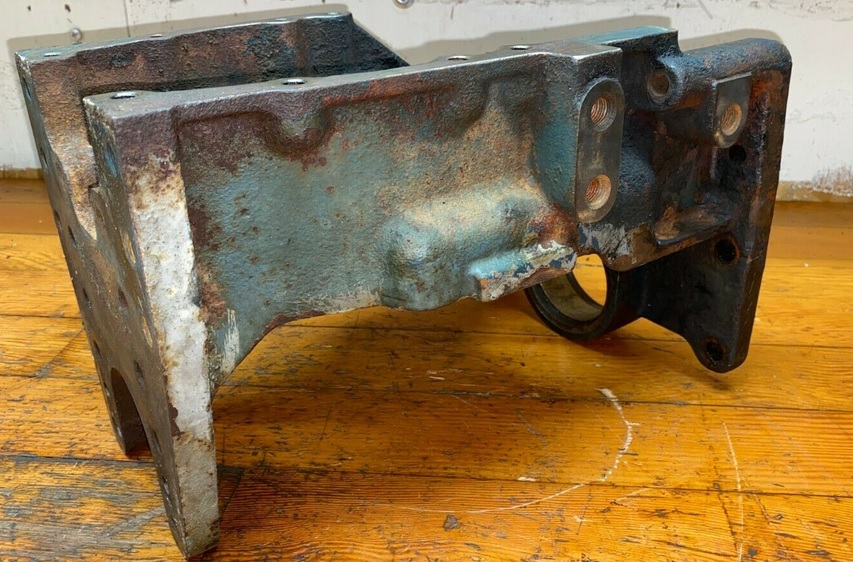

MORE on whether the front case will come off WITHOUT splitting the tractor.
The WSMs for the L345DT and L355ss have almost NO information or pictures on how the engine is supported at the front. Most engine work is only covered in Kubota's engine wsms.
In the front axle parts diagram there's a part no. 37800-44710 for the cast bracket that connects the engine's oil pan to the front axle. Later models added heavy flat plates to reinforce it - but there's still very little mention in the tractor WSMs.
It looks like it may be possible to get the front engine case off with this still in place without taking the whole front off the tractor - but I've not seen anything on TBN or OTT about it. Attached pic is from a bay auction. The 2 PDF's are from an engine WSM - but the special front bracket used on a L345 tractor is not shown. All that said, it actually looks like they intended the gear case to be removable with tractor mostly still assembled. Radiator & fan belt may have to go so the fan clears. Then the project reduces to finding o-rings, gasket, and plug(s). That would be pretty cool.
I'll ask North Idaho Wolfman if he knows and could confirm one way or the other.
Take care, Dick B
