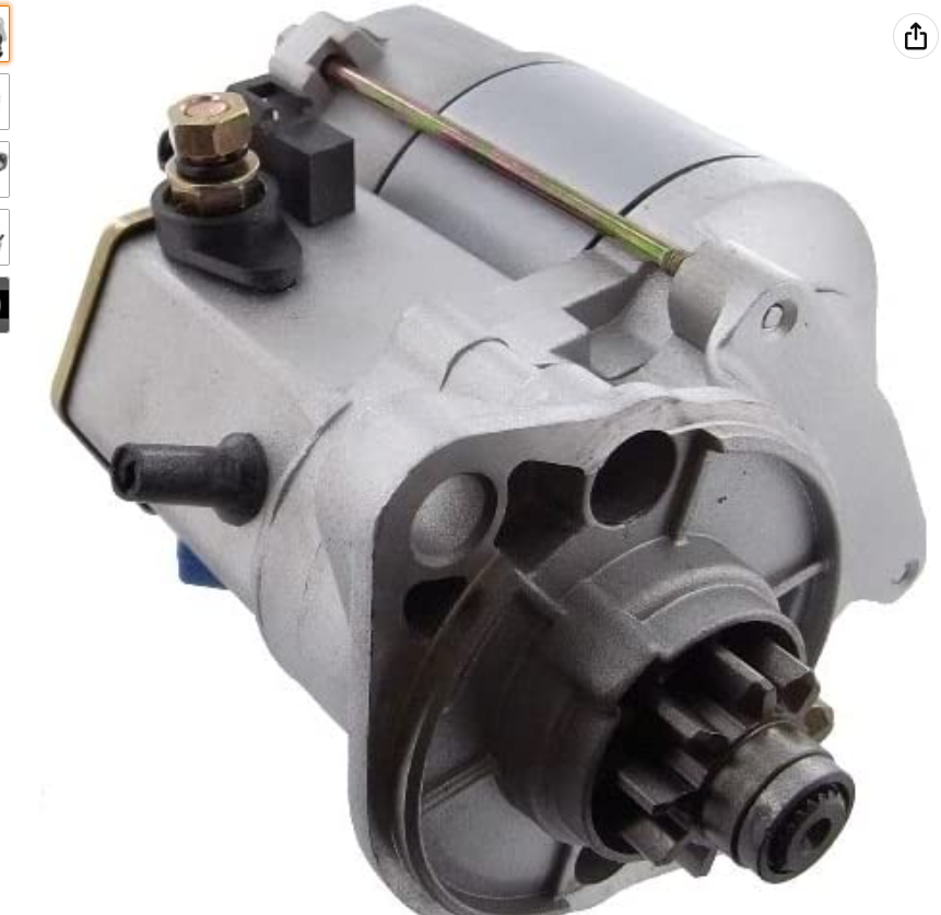

The photo below shows one side of the starter, with the terminal near the motor. The terminal to the battery is on the bottom side of the solenoid, so it's not visible in this photo. I'm running a wire between the terminal in this photo and the terminal on the bottom of the solenoid (again, with the battery still connected to the starter).

No your jumping it wrong.
Large terminal with battery connection on it, to small connection on the side with the Black wire with white stripe.
You need to check fuses and test the starter relay.

Aha! The correct method of jumping the starter worked. So, I've got a bad switch or relay. Thus far, the fuses I've checked were good. I have a few more to get to. At least I have a way to get it working. Thanks for the help!
