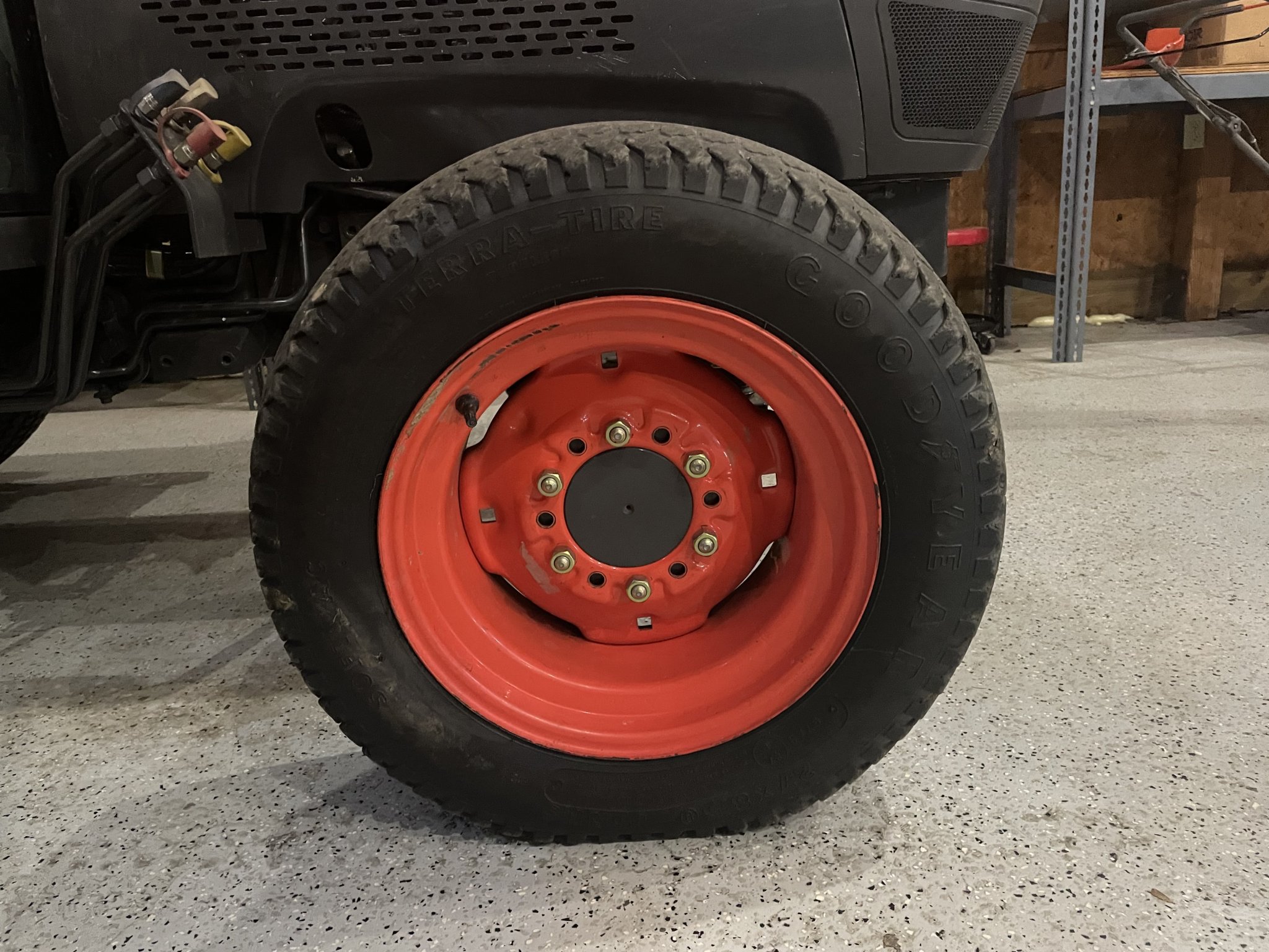

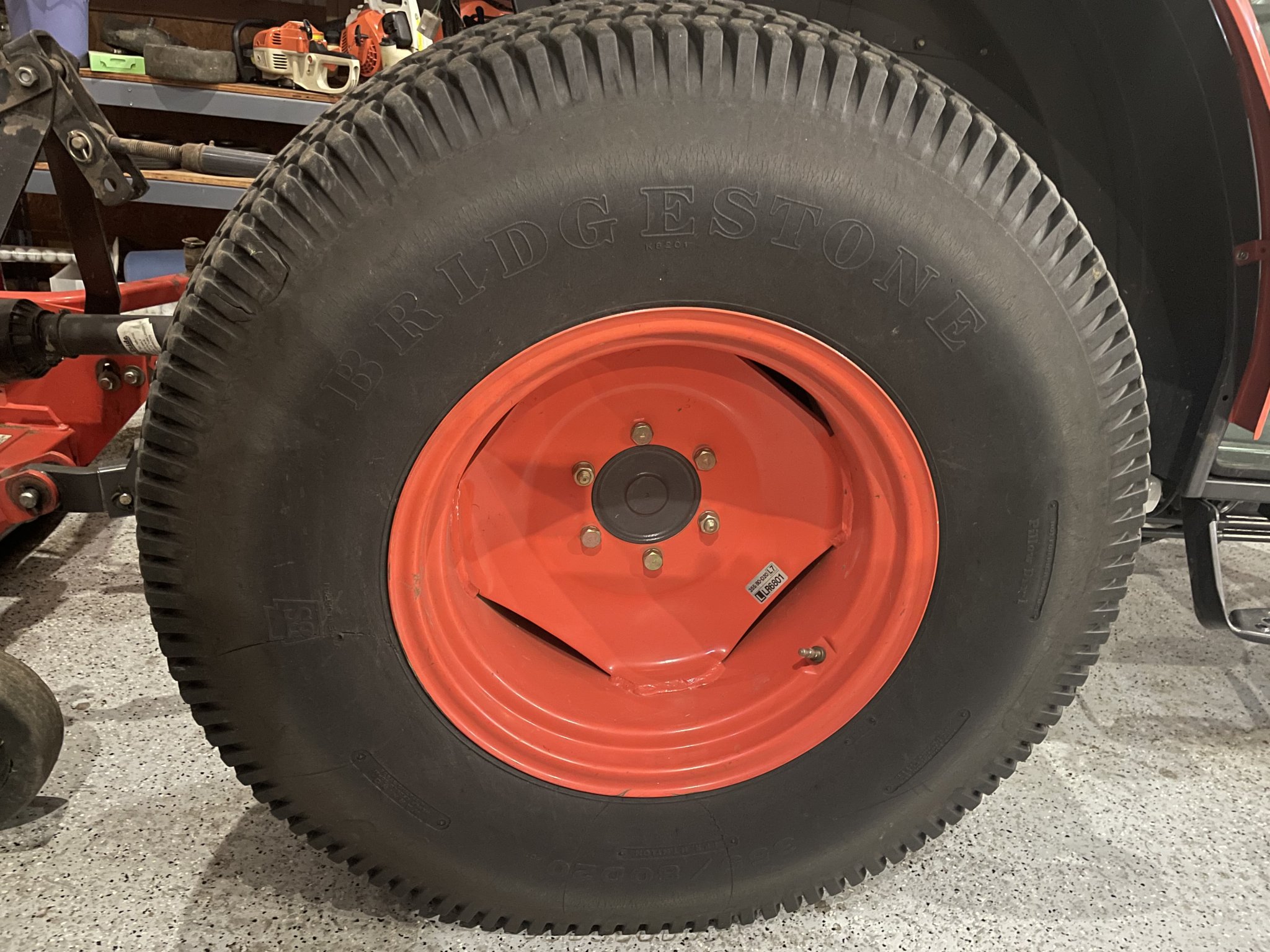

I have a 2007 kubota l3240 tractor with cab. It has the turf tires and they are worn and ready to replace. I want to go to an “industrial” like R3 or R4 tire for both front and back because I will be mowing In a more rockier terrain. Need a heavier ply then the 4ply turf tires. Having a very hard time finding them, even the local kubota dealer won’t call me back on them!! Lol. Rear tire size is 355/80D-20. Front tire are 27 x 8.50. Thanks for any help!!!!

So, looking this up.
you will need to change the rims:
Industrial front10x16.5 (4WD)
Industrial rear420/70-24 (4WD)
Interesting, thank you very much. So I need to find an entire set then that fits my wheel lug pattern…. Any place you recommend to purchase?

You might look into the newer R14 tires. They might come in sizes that fit your existing rims.
Also I hear that buying a new set of rims and tires through the SALES department as a whole-goods is cheaper than buying the same things from the PARTS Department
