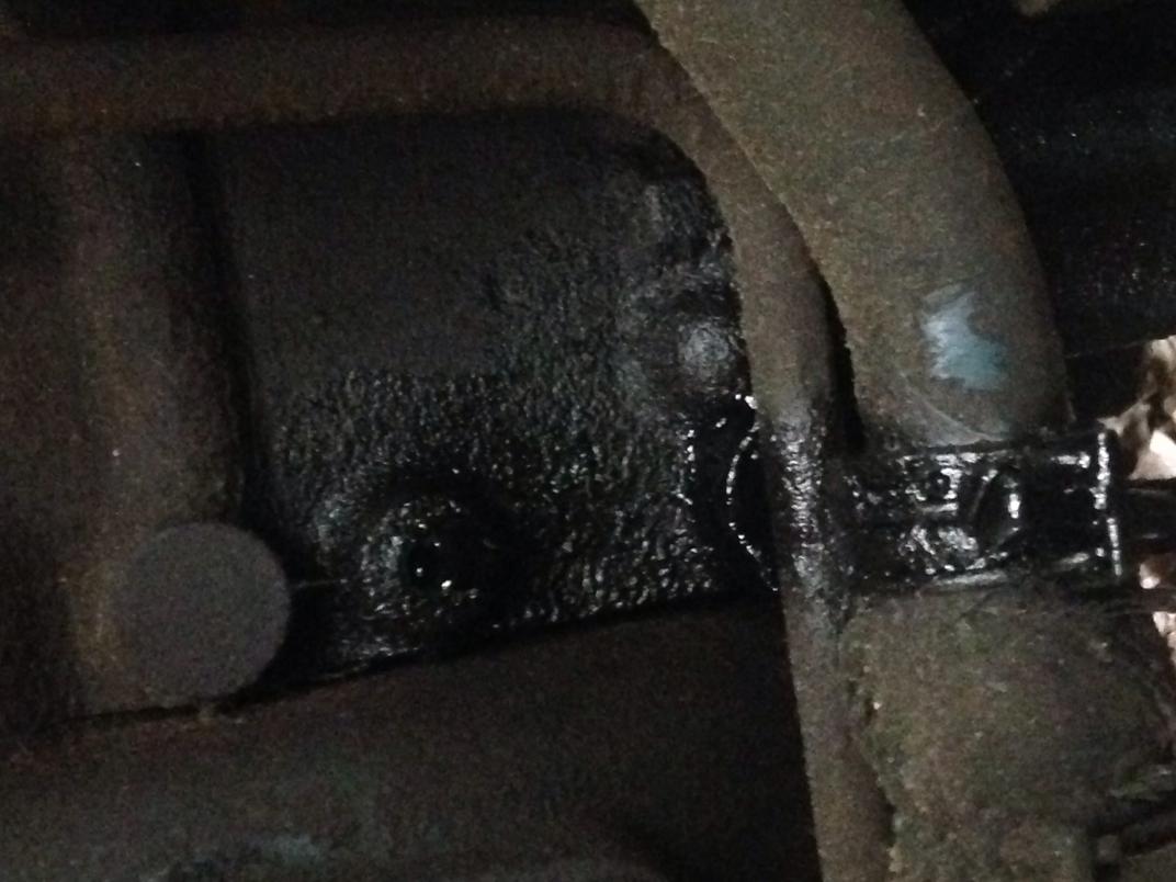

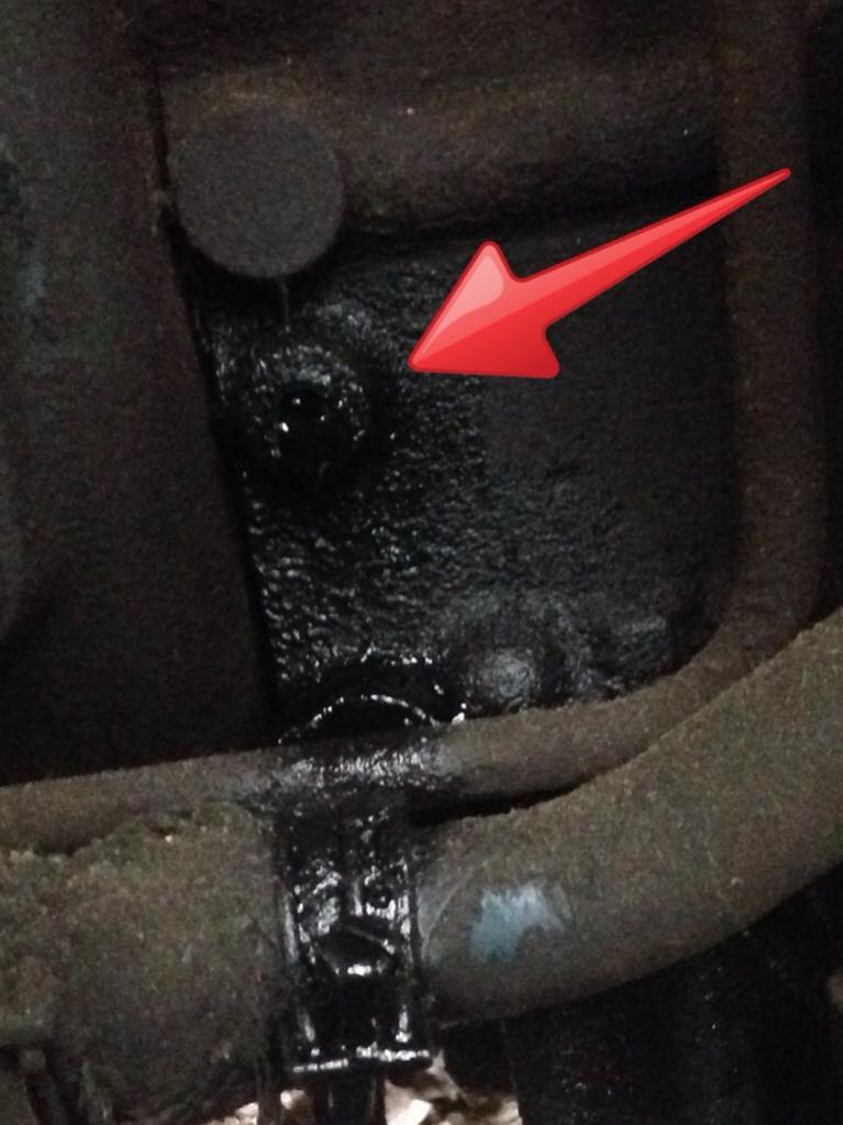

I just cranked up my tractor and oil began to shoot out from the block. I'm providing two pics of the hole it was coming from. What is this and why is it doing this? Note that both pics are turned 90 degrees for some reason.

If that's engine oil, looks like you lost a rear seal...
If it's hydraulic oil... looks like it needs to be changed! :D All kidding aside, it would be a front seal on the transmission.
Those are the good problems to have. If it's a crack in the block.. that's bad news and while you can get it repaired, it's not fun or cheap!

So if a seal is leaking it comes out that hole? I had read somewhere that the hole was for an accessory and kubota plugged it, but after years and years the plug will give way. Here's an arrow point towards where it's coming from.

If the hole is plugged with a small 3/8 inch aluminum plug and the plug is gone it can be fixed by threading a small bolt in place. Get out a tap and die,grease it well and tap the hole. Grease keeps the metal from going into the block. Loctite the bolt when you tread it in. A small set screw would also work.

Yes had a small dowel looking plug in it from the factory, not very common for them to come out but they do on rare occasion.
Just get a tap and tap the hole and a bolt or plug to plug it up.

It is called an oil galley plug. It fills a hole drilled in the block to allow oil to be transferred from one part of the inside of the engine to another. Some are like a threaded pipe plug, some are a small round slug of aluminum. I had one of the non threaded style push out of one of my B7100s last summer. Took about 30 seconds to pump most all the oil from the engine. Glad I was only backing out of the garage. If I had been running the tractor mowing I bet I would have ruined the engine.

I couldn't tell WHAT it was from the picture or that the 'hole' was the origin of the leak. Looked like it was coming out from the separation point, but yeah, it's probably that plug failing.
