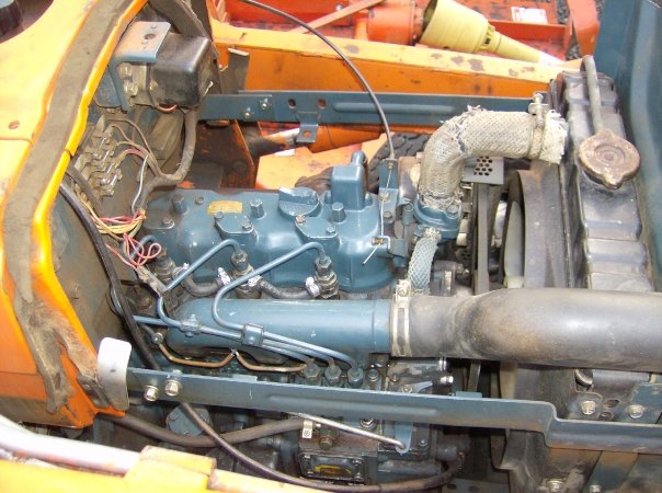

fj40dave
Sep 24, 2009
425
257
Yelm, WA
There's a little O-Ring on the mechanical hydraulic pump mounted on the engine....and when it fails, it pushes hydraulic fluid into the engine crank case.
It ends up pushing the dip stick out, and also coming out the breather tube.
I figured this out in 2010 when I rebuilt this L295
The tractor still moved though....
Does the motor start?
