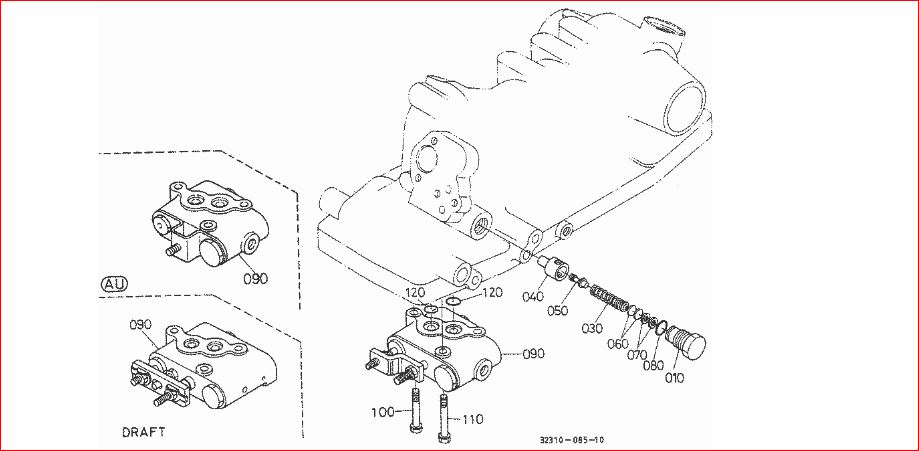

can someone tell me where the control valve is located on a l235dt, i been looking on kubota.com and see nothing that looks like whats on thier micro fish buts (maybe) show to be internal under the seat
33,049
8,477
Simple it's under the cover, under your seat.
Normally the valve is the least of your possible problems, I would be checking other things first.

This is a pic of your hydraulic system, I really need to know how they hooked the loaders hydraulic control to this system!
And yes there is no screen in your model.
