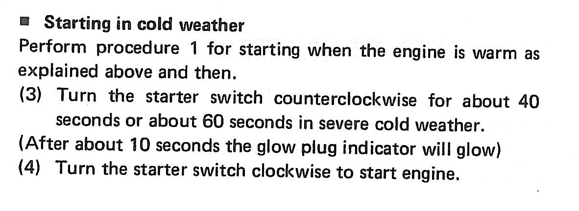

First a caution. Do not use starting fluid , quick start or ether.
The time to heat the glow plugs is often much longer than owners think because their experience is with much more modern diesels..
Are you seeing the glow plug indicator glowing red. It is a special wire like a toaster and actually glows red hot.

Hi Dave appreciate your reply. Actually the instructions left by the previous owner was to use starter fluid if the tractor had not been started for a while. As I only get up to the property about every three to six weeks I have been using this. Also he said to warm the glow plugs for ten seconds. I have tried to do this longer but it hasn’t made a difference. I forgot to mention in my earlier post jump starting hasn’t worked unless it is from a friends truck which has a huge battery bank. The only two lights on the dash are the charge and oil? Cheers Mick
