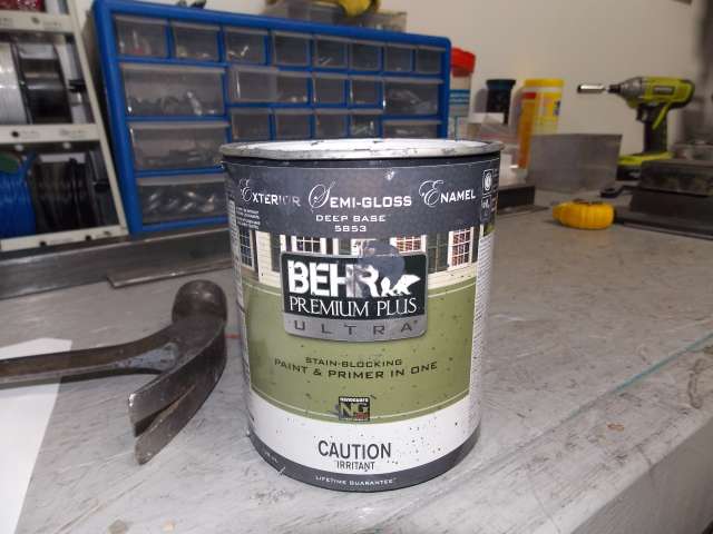

I've had real good luck with this one (see pictures) now I can't remember how I got that number but if you have a home depot in your area that is the number for the new Kubota Grey and it is as close as I ever got it to work and you have to be inches away really starring at it to notice any difference :)
Now I don't know if that would be a different number in the US ??
I did a bunch of painting on my new mods using this and turn out great, if I was to do anything different I would get the full gloss not just semi gloss
Hope this help if you have trouble reading the numbers let me know and I will scan the tag and do a better pic in "PDF"

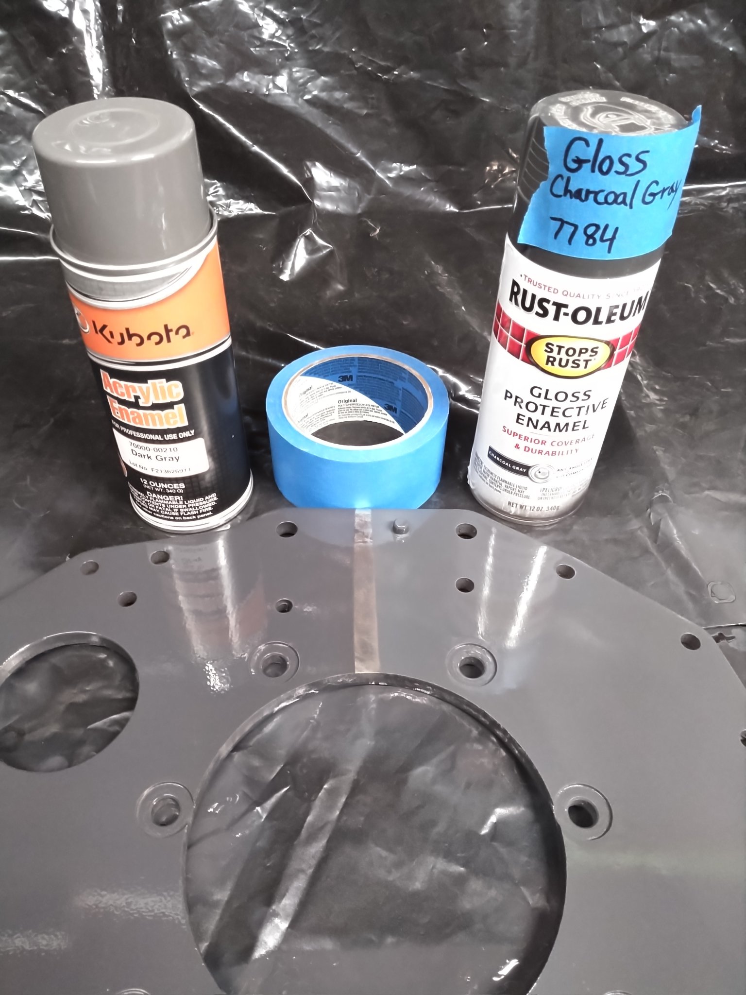

I know this is an old thread, but the fact I found it in a search on this topic means it's not dead. I decided to do a comparison of the Rust Oleum 7784 Charcoal Gray to the Kubota 70000-00210 Dark Gray. The Kubota matches the frame/engine/etc. on my 90's era B2150. The difference in real life is more pronounced than it appears on my computer screen.
