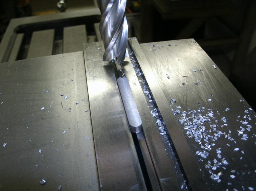

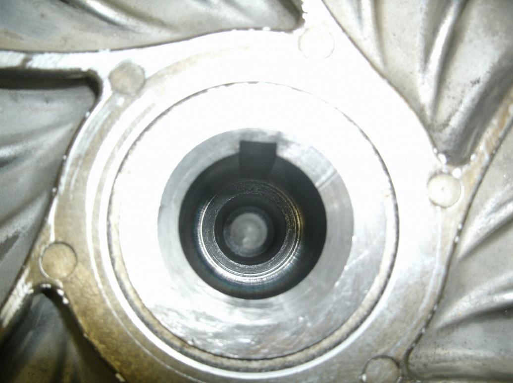

When I tried to fit the clutch to the shaft, I didn't notice that the key way in the clutch shaft was not broached to the standard depth. It was about .055" less than standard. I don't want to go any deeper in the stub shaft with the key way because I'm afraid it would crack and lead to failure. So I machined down the key and checked for fit.
That should be the program!

Congrats on a successful and clean result!
For future reference, while a slotter (or shaper) would be easiest for a job like that, you can do it on a lathe. Easiest is to take an old school HSS boring bar, the kind with square holes at 90* on one end and 45* on the other end. Grind the bar similar to boring, but with the cutting edge and clearances rotated for broaching. With the part still in the chuck jaws, you then rack the carriage toward the chuck to make the first cut. Clear the bit using cross, rewind the carriage, in-feed for next depth of cut with cross, rack the carriage down, repeat until desired depth is reached. If you can grind HSS bits, this should be straight forward, though a bit slow and laborious...
torch
Jun 10, 2016
2,913
1,173
Muskoka, Ont.
Don`t forget step 1 -- lock the spindle in position.
