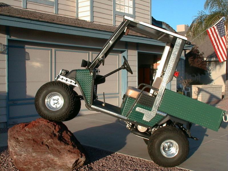

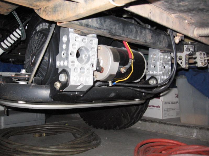

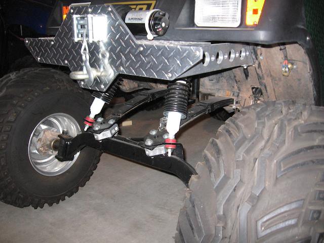

It's a '96 GXT-804 Turf Truck. Second last pic below shows one in stock form; mine had a different cab, as it was a ball picker originally. Body is all steel diamond plate, cab is steel, lots of aluminum, cowl un-altered except for added subframe for winch/front bumper mount. They are factory rated at 1000lb capacity, before my mods.
