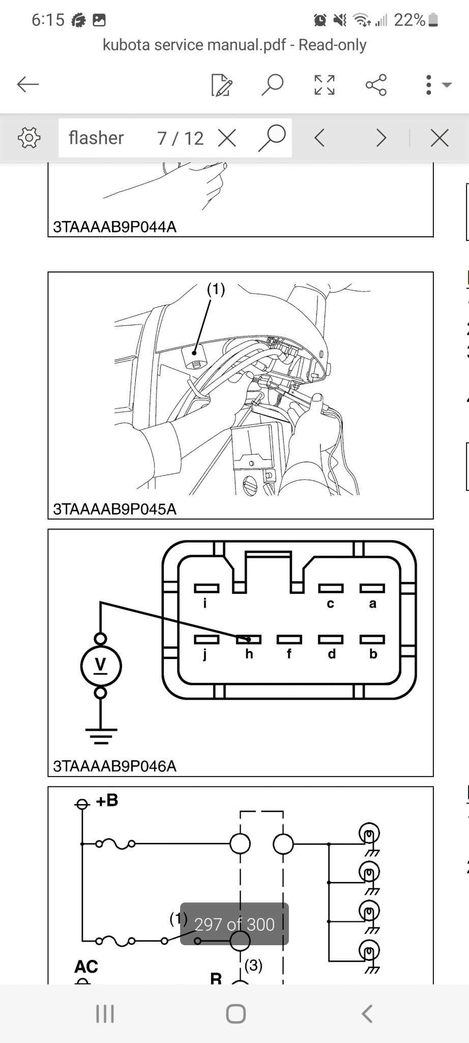

I recently purchased a 2004 Kubota BX2200 off someone. When I got it the hazard lights and turn signals did not work at all. I discovered the unit flasher is just missing. I also noticed the wire connector plug that plugs to the flasher unit looks like it has some damage. The reason I'm Posting I'm having a hard time finding the connector to replace it. I've attached a picture I found of the flasher unit and a picture of the layout for the connector from the service manual. I've tried looking in the parts manual to find the connector bit cannot find it there either. If anyone can help I would truly appreciate it.

Kubota does not sell individual connectors.
But, that is an 8-pin connector used on Lexus and Toyota. Unique keying shown on your screenshots.
One way would be to cut one off a salvaged vehicle.
Another is to match up the automotive connector for ordering from an automotive connector supply.

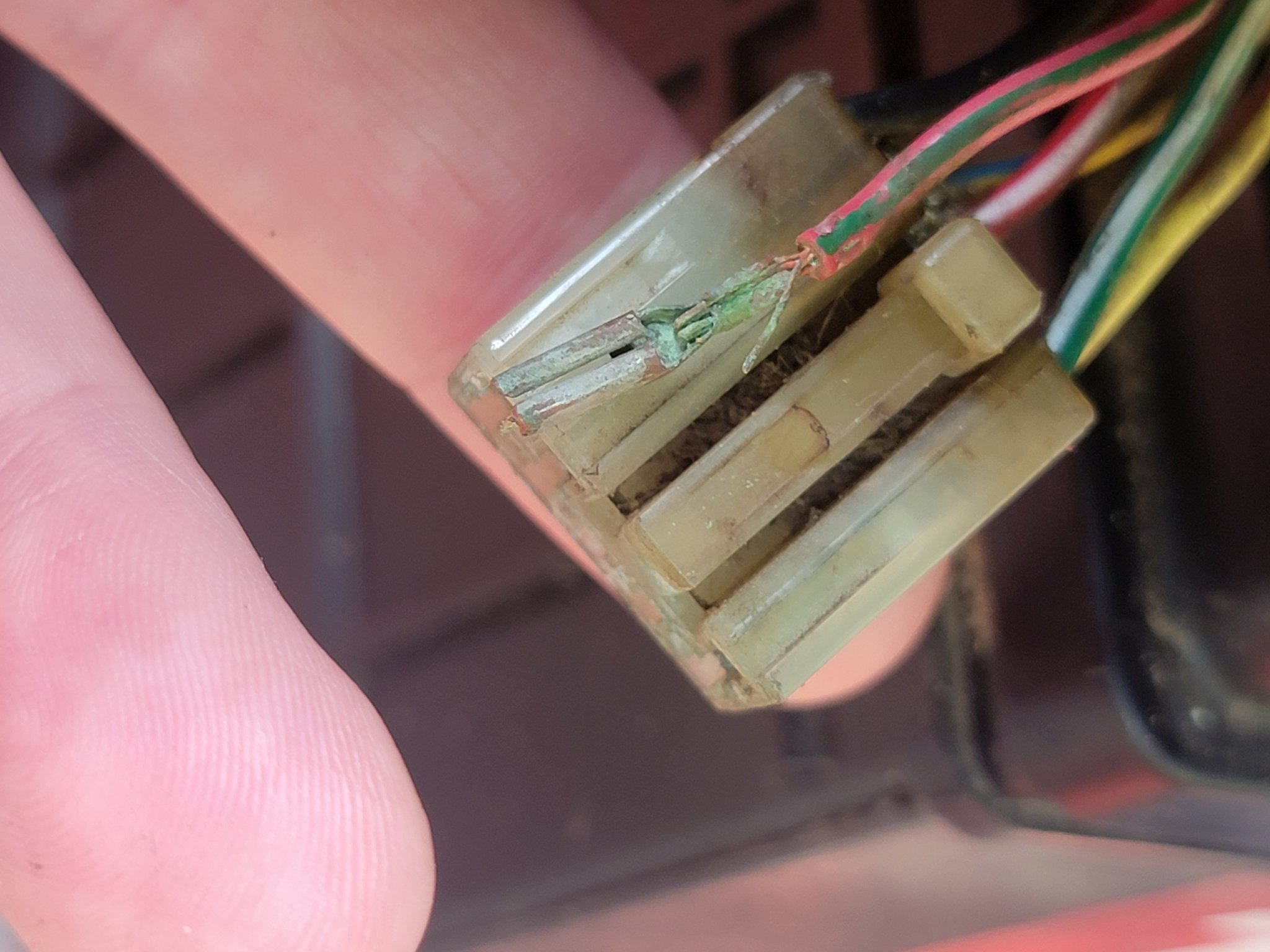

How damaged is the existing connector, picture please? Any guess how it got damaged, did the wires burn, did something get in there and ripped it out? Sounds like you need at a minimum, the flasher relay, perhaps purchase it and see if it'll will plug in and operate. Some tape around the existing connector might be better than a boatload of crimp-on splices, or the cost of a new wiring harness.

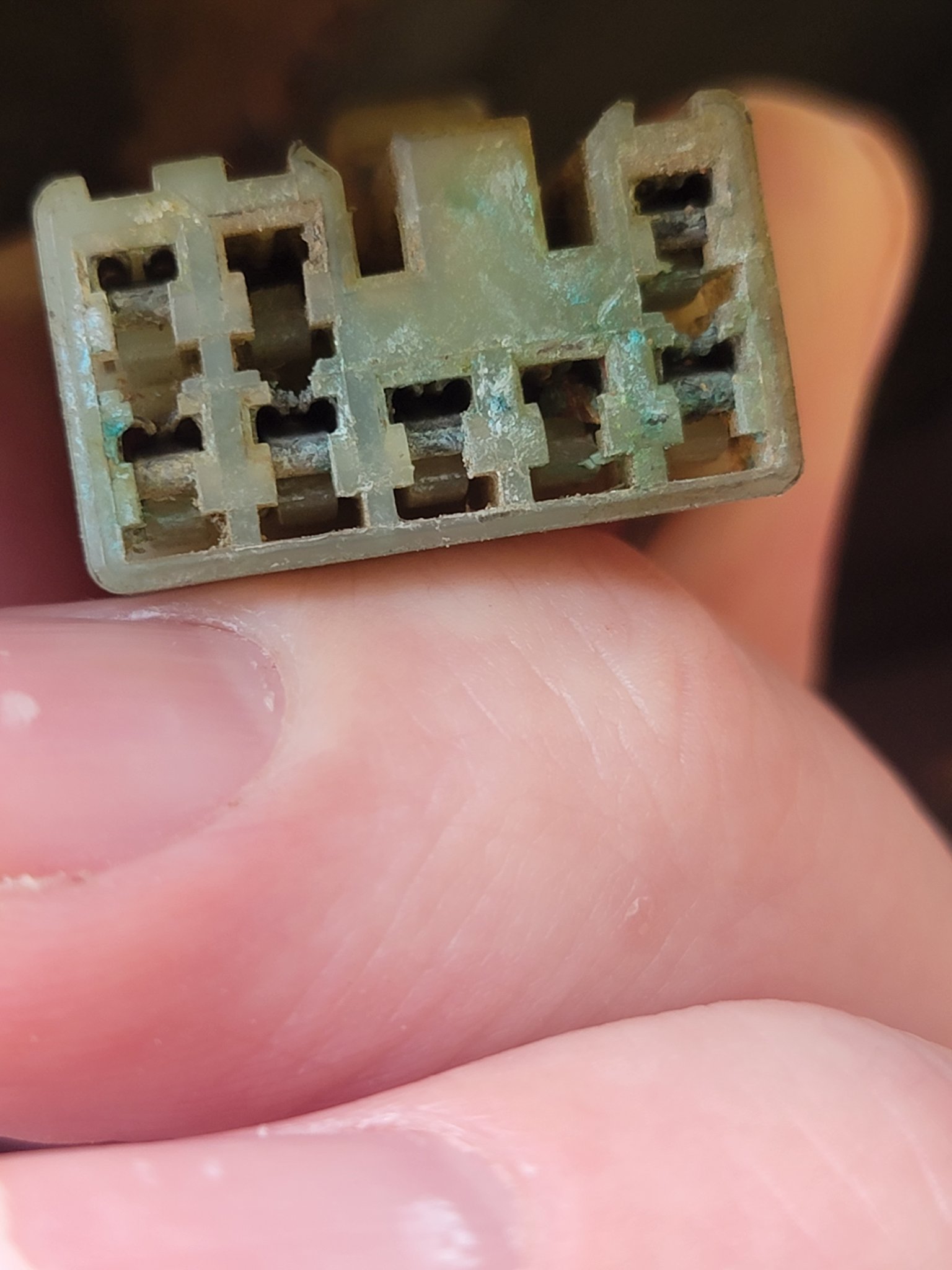

I'm glad you asked me to take a picture because in doing so I realized it may be easier to fix. The only damage I found other than some corrosion is where one of the pins would go in the female part was broken inside the connector. But I realized as shown in the picture I can just pull that one out of the housing, replace the connector part and put it back in the housing. Sorry if that doesn't make since, don't really know the proper terms, but pictures are attached.

Did you look closely at the connector to see if there was a manufacturer name or part number on it?

It sure looks like some type of corrosion was taken place. I'd inspect the area where this connector is located. Throughtly clean all terminals.
