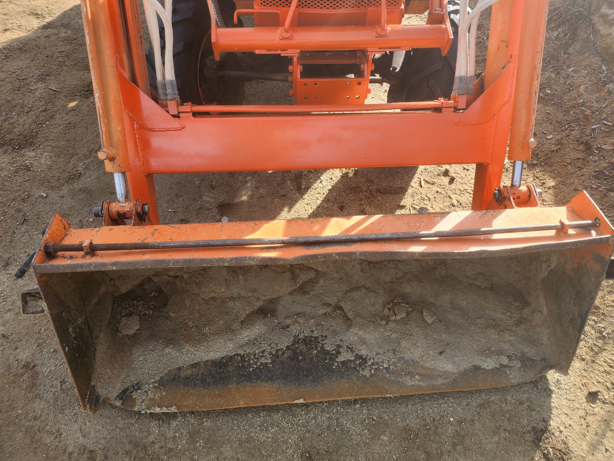

Was wondering if there is after market hydraulic cylinders for my loader on my b8200d

Doubtlessly there are “generic” cyls which will replace the OEMs…. (and of course, your loader model would likely be more descriptive than your tractor model.)

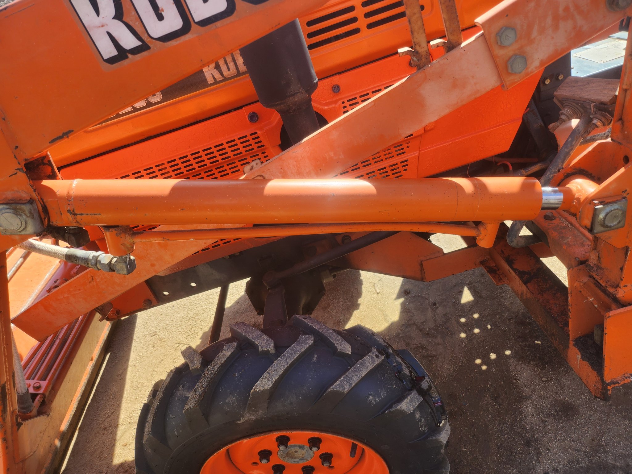

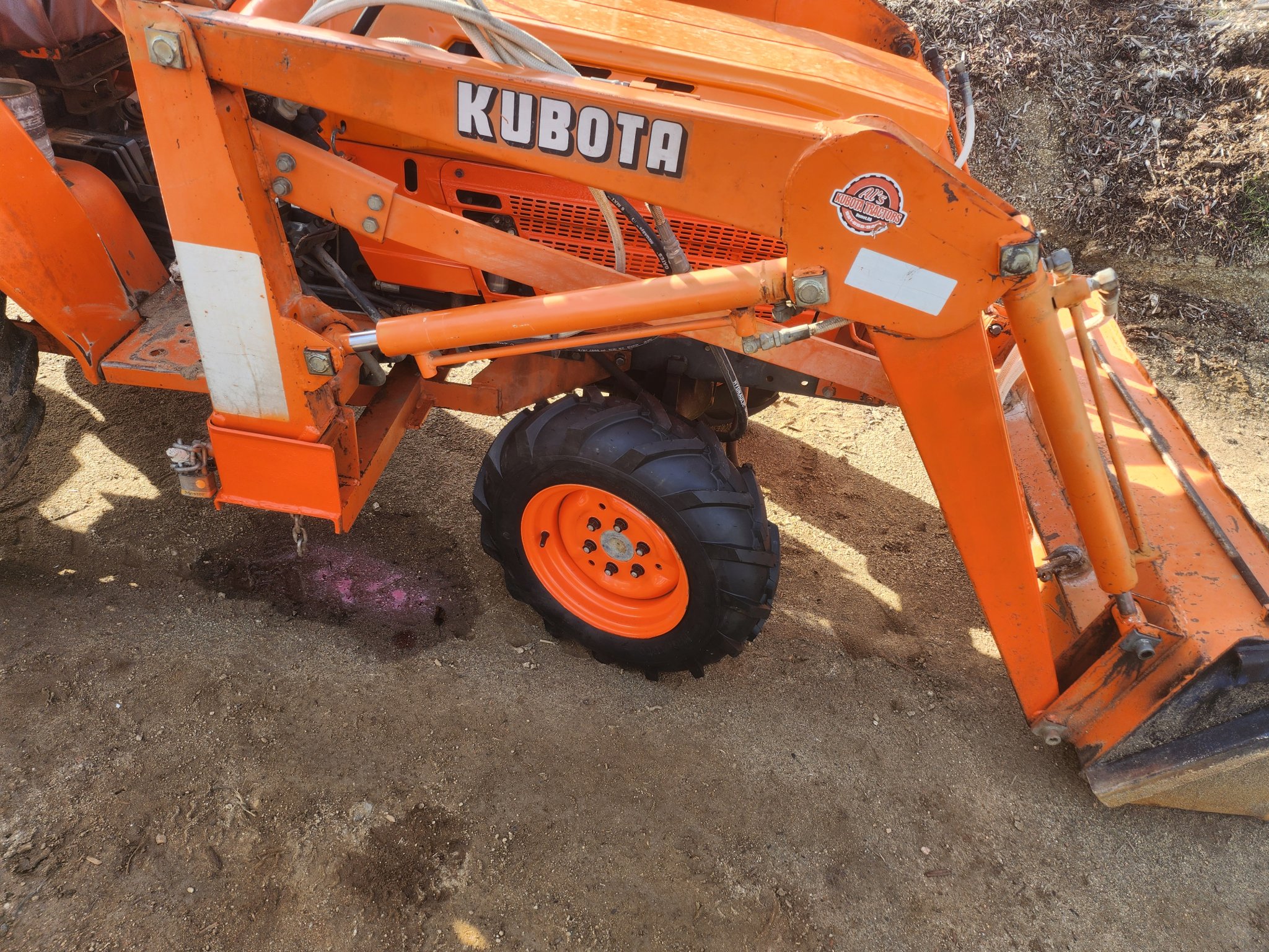

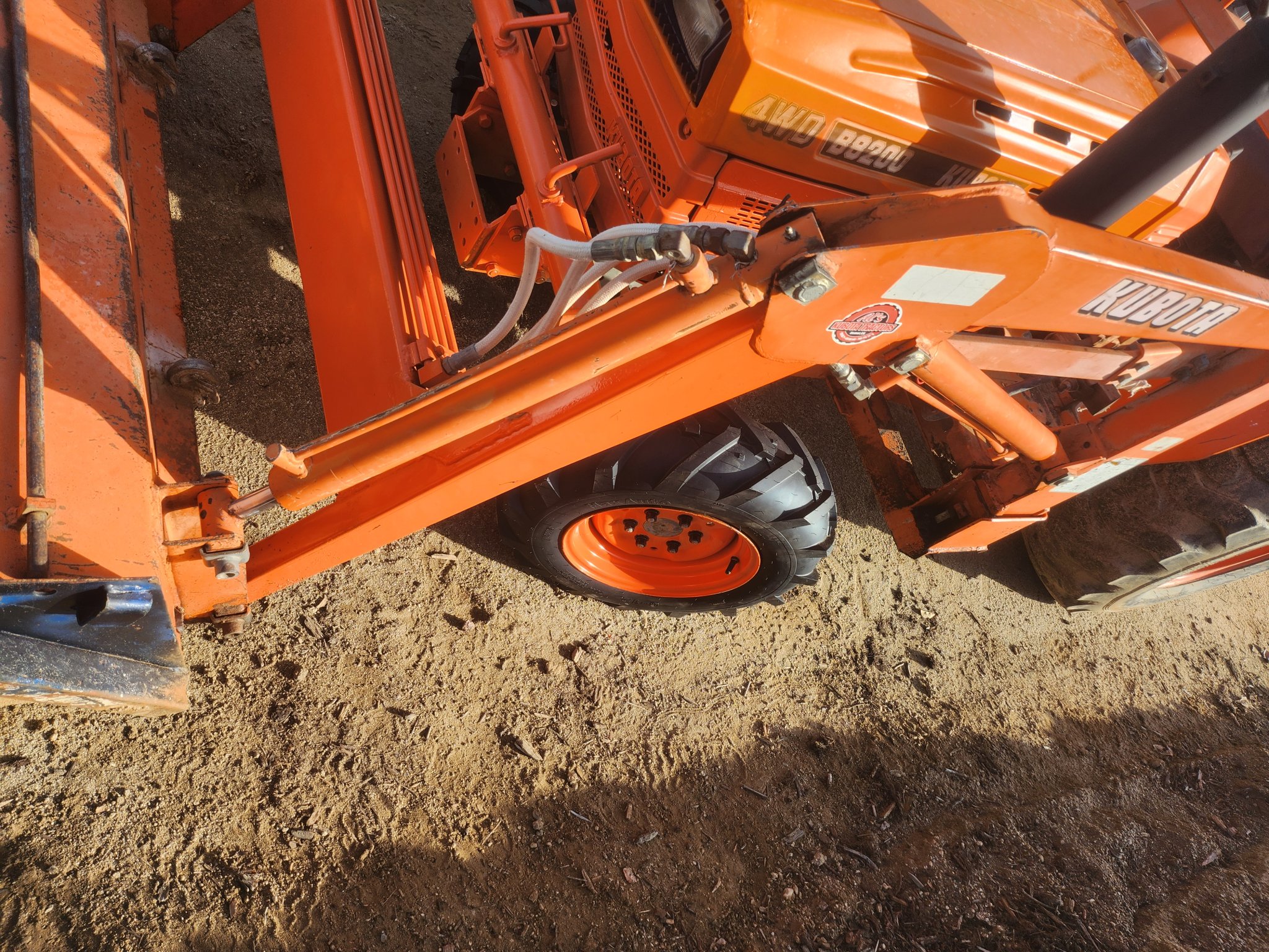

If you can take a few measurements I will try to point you to some sources. Also a picture of the cylinders so I csn see the construction as well.

You are missing pin size, retracted length and stroke for the cylinders. Those other dimensions are not needed for sourcing cylinders.

Based on dimensions I found in an older thread these should be a direct drop in replacement for the lift cylinders. The bore is larger (2" versus 1.77") so you will gain 28% more lifting power.
I suggest you double check all dimensions before buying.

How do you arrive at 1.18 diameter piston? That is the rod diameter which would be tough to do on a double acting cylinder.
The bucket cylinder kit is right under the boom kit in the link. They are ~$75 per cylinder.
