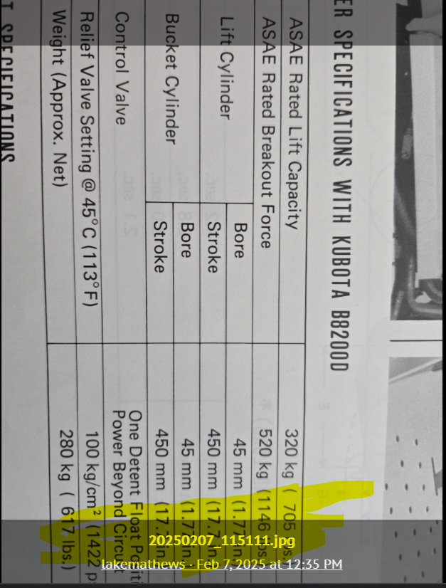

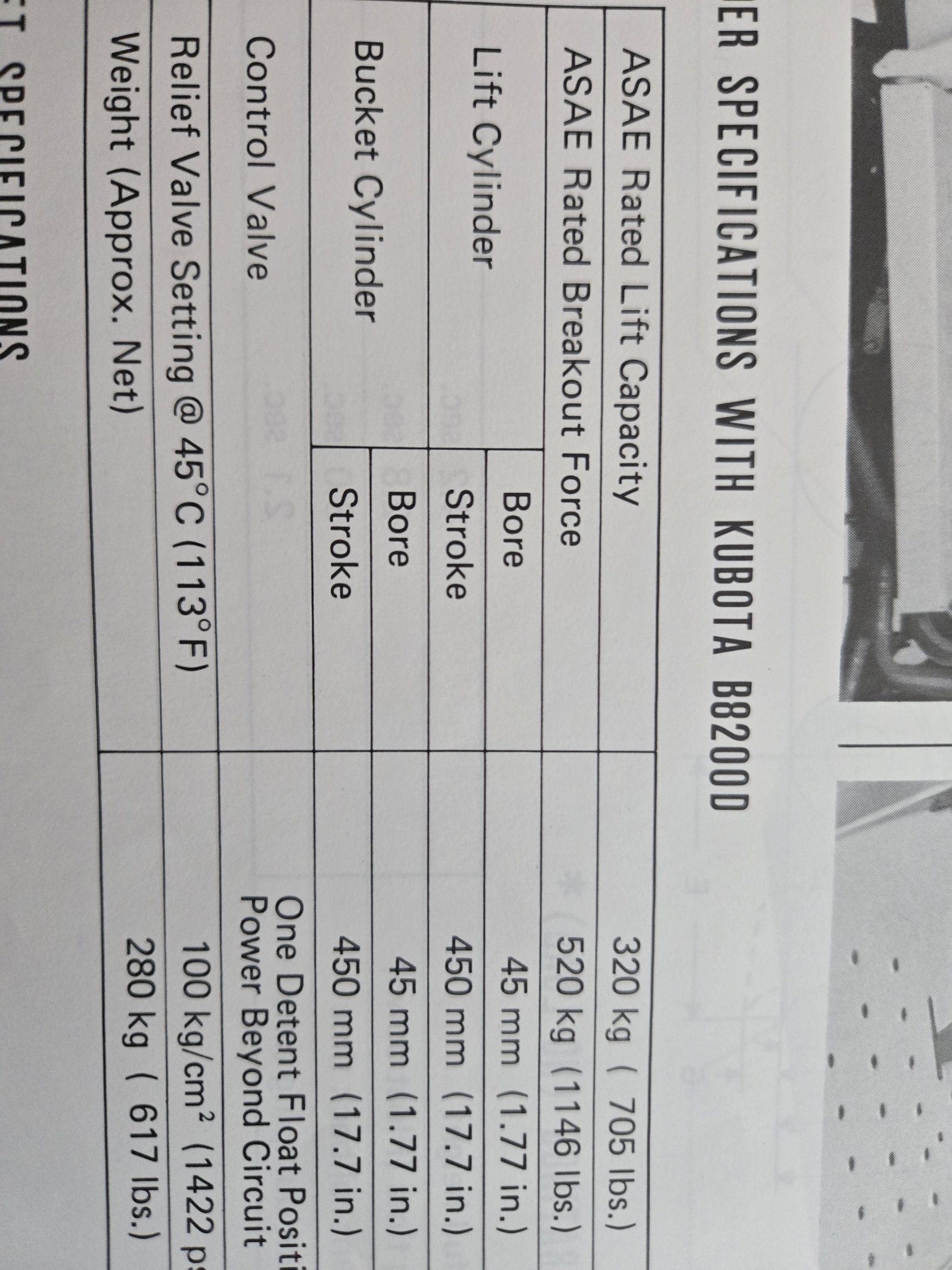

The cylinders in your picture are not fully retracted. Looks like an inch of rod exposed so I am going to call itv26" which is what other sources said. If boom fully extended is 43.5 stroke is:
43.5 - 26 = 17.5"
