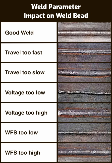

I think you should work on the welding technique before any of this stuff gets 'buried' where it would be hard to go over it. It looks to me like you are doing a lot of sort of 'heavy tacks' but almost no continuous beads. It's very unlikely you are getting the parts hot enough to properly bond the parts with and through the weld, to each other.
You probably have several 'off cuts' now of material that is not really useful for anything else. I would try just running practice beads on something of similar/same thickness to what you are welding, and then compare to some examples you find online such as this one:

Admittedly my welds are probably some of the ugliest known to man and after your post Vigo I became even more self aware and self conscious of this 😅. To the point that I came home from work and spent some time grinding a few of my "welds" down I did find the parts bonded fairly well (maybe I'm just blind) but after I ground off all the "extra metal" I found what I considered decent results, obviously I have a lot of "going over" stuff to do and a ton of grinding but al in all im not totally disappointed in the results. Below are a couple samples, I know I certainly have to go over several parts of these joints again. I really don't (surprisingly) have a lot of extra cutoffs laying around nothing has really been cut to a finished length yet except the one "cross peice" which I got at that length and didn't have to trim
None of these pictures are "final product" just showing I'm making progress a tiny little bit at a time

We’re not dogging on you, you’re already past the hardest part which is jumping in! I just don’t want you to have a surprise structural issue at an inopportune time when using the loader.
One thing you might consider.. if you are welding a thickness of metal that is near the limit of your welder, there is almost no chance of overdoing it as far as ‘blowing through’ the material, so theres very little risk to just holding the trigger down. To me it looks like a lot of starts and stops currently. In terms of making sure everything gets hot and enough material gets added, id suggest treating it more like a bull ride where the goal is to hang on for 8 seconds at a time! 😂🙌
Now that i think of it, almost all the fab projects on Youtube these days are fast forwarding all the parts where they lay a weld bead. They wouldn’t be doing that if they weren’t holding the trigger down long enough to get boring!

Also note while grinding a weld down makes it "look better" you really better off leaving it bulky and just lightly knock of the highest points.
I would personally go back and lay another weld slow and hot over the existing on the towers.
Also gussets or reinforcing plates add a ton of strength!
