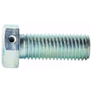

Then ask them to warranty the driveshaft, because that has to be the problem, otherwise, everyone on here that has a snowblower would be complaining about this issue. After hitting a rock and straightening the impeller on my snowblower it had a bad vibration, but it still worked well, so I never changed the impeller, nor did I ever have any Allen screws come loose from vibrations. The only other suggestion that I can make is that if the dealer is unwilling to replace the driveshaft, take it to a drive line shop and have them tap it to the next larger size, and install a bolt that has a safety wire.
