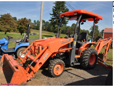

this is the B26:

the b26tlb isn’t really a dedicated backhoe, it has a three point hitch setup with a rear PTO but the backhoe is pinned right to the mainframe not to the TPH like other attachments and it has a separate hydraulic pump
34,384
9,615
Hate to disagree with you but the B26 is a true TLB (Tractor, Loader, Back Hoe).
As the BH is on a subframe 4 point mount.
But more importantly is that fact that the hydraulic pumps and systems are designed around the Loader and BH being used for extensive length of times without over taxing / over heating the system.

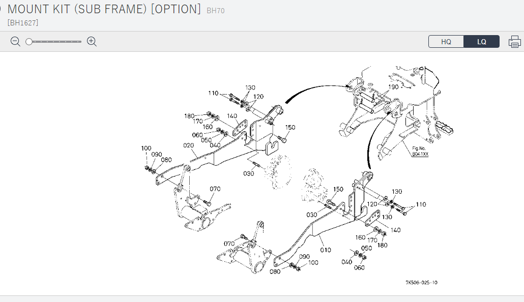

so how does the BH attach on its little sister the b2601…isn’t the BH mounted on the TPH?
34,384
9,615
It mounts to a subframe too, almost all of the BH's do now.
The TPH mounted ones cause too much damage.
What makes the B26 a TLB and not a tractor with a BH is the hydraulic system and heavier loader.
34,384
9,615
The BH's between the two are not the same, the TLB uses a much heavier built BH.
Difference is a B26TLB comes with a BH and the three point is optional.
Where the tractor, b2601, the three point is standard and the BH is optional.

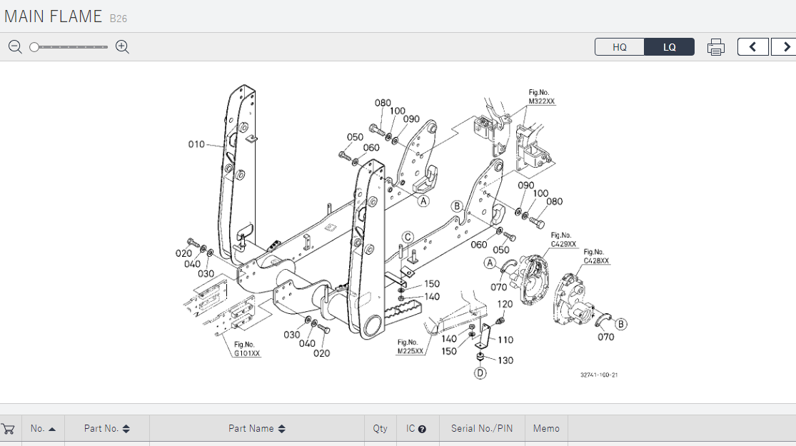

Here are the 2:
They technically do not call the mount on a B26 a sub frame, just the frame.
as it's just part of the tractor build.
And FYI they also call it a MAIN FLAME... :ROFLMAO: :ROFLMAO: :ROFLMAO:
You can see a huge difference in the two.
B2601 Subframe
34,384
9,615
Here is the page from the WSM that explains what's all involved with the system.
