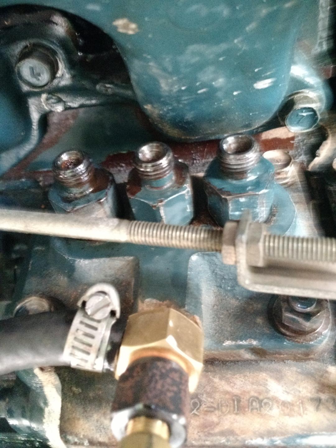

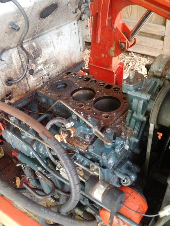

Wolfman, before I contact the mechanic, I called the rebuild shop in Orlando, Fl(Nozzle Master, been in business for more than 30 years) and the person there, quoted me that rebuilding a pump started at $350 to $700( depending on the work needed) after that, I called the mechanic shop and he told me that he will no only replace the pump and rebuild it but he will go over and cleaning the injectors and hard lines(already did myself and I was planning to replace the injectors) that was the three hs labor. About rebuilding the pump, he didn't know how bad it was so called the higher price, could be less. But I'm ready to do it myself, only need some directions(you already did). So, I remove the 4 bolts and then pull the pump up, be sure I don't mess with the shims, that's it?. Could be that the springs or the piston inside are clogged with gunk? anything else? Will the pump cohttps://www.orangetractortalks.com/forums/attachment.php?attachmentid=48213&stc=1&d=1586351123me along easily? Thanks again, Daniel.https://www.orangetractortalks.com/forums/attachment.php?attachmentid=48214&stc=1&d=1586351123
36,899
11,569
Daniel,
Let me see if I can give you the rundown to pull the pump and the injectors.

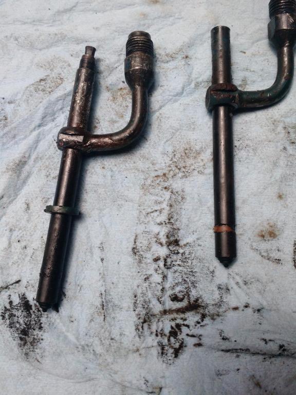

Remove the throttle linkage, remove the Intake, then loosen the hold downs on the injectors, There is a tool you can get to pop the injectors out of their holes.
Your tractor uses pencil injectors, they are not rebuildable or cleanable, most shops won't or can't test them, I just replace them as needed.
I would also replace the glow plugs while I was in this deep.
Put pieces of rag in all the injector and glow plug holes to keep debri out of the cylinders.

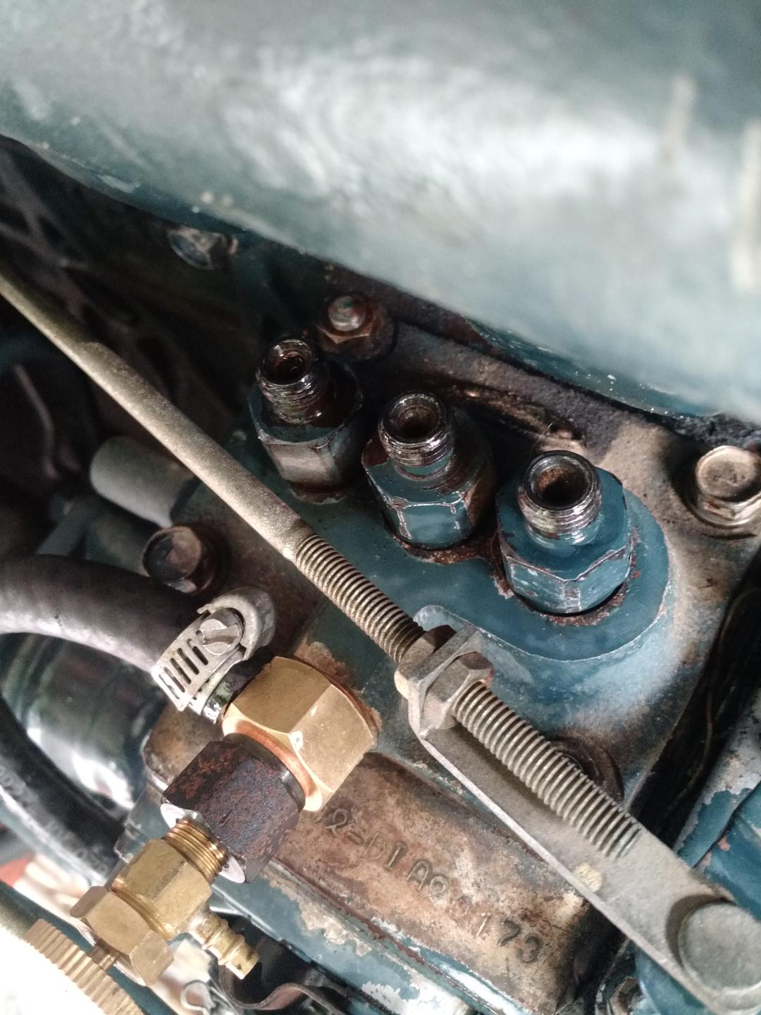

Now move to the Injection pump, pull the stop linkage and side cover off, remove the 2 bolts and 2 nuts that hold the injection pump down, pull pump up, there is a slot in the block where the fuel injection rack pin needs to fit through, you can go into the side to move the rack pin if needed to get it out.
Remove any shims ( they can be a one to a few and they can be very thin) stuck on the bottom of the pump housing and save them, these are the injection pump timing shims, and they will get reused, they are the same no matter what pump you use.
Have the pump tested or rebuilt and get new injectors and glow plugs.
and a new intake gasket.
Anything comes up along the way, just ask for help or clarification. ;)

Having a hard time removing the pencil injectors!!! I will need the injector extractor tool...sprayed PB blaster for two days, but nothing...any suggestion? Thanks, Daniel.
36,899
11,569
Having a hard time removing the pencil injectors!!! I will need the injector extractor tool...sprayed BP blaster for two days, but nothing...any suggestion? Thanks, Daniel.
My only real suggestion would be to get the tool, some are a real pain to get out!
15,035
7,748

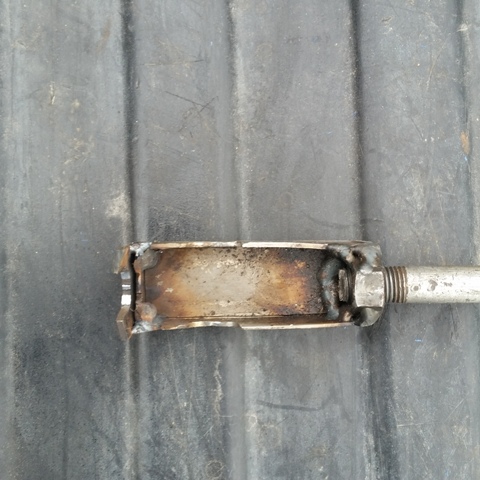

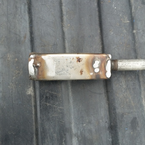

If you're up to it, you can save about $130 by fabricating you own. Doesn't have to be perfect or pretty if you're just using it a few times.
I made this one out of "stuff" I had laying around and adapted it to use on my slide hammer.
15,035
7,748
Well, you can save yourself some grief by installing good injectors back in. If you end up with some that don't work you'll get to do it all over again!

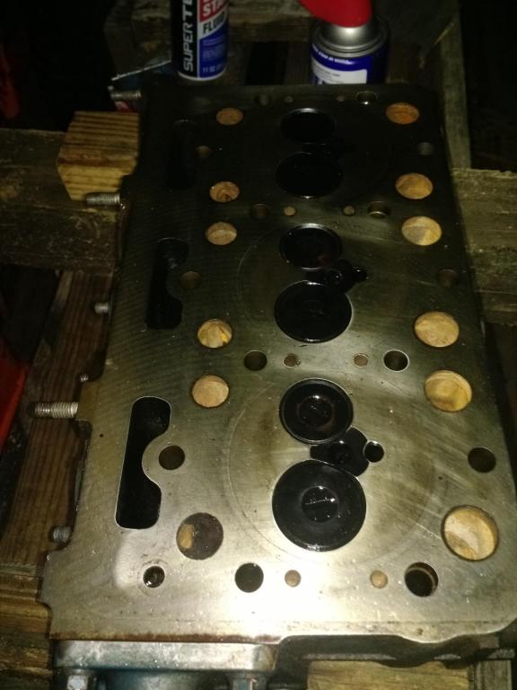

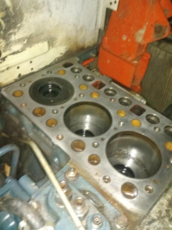

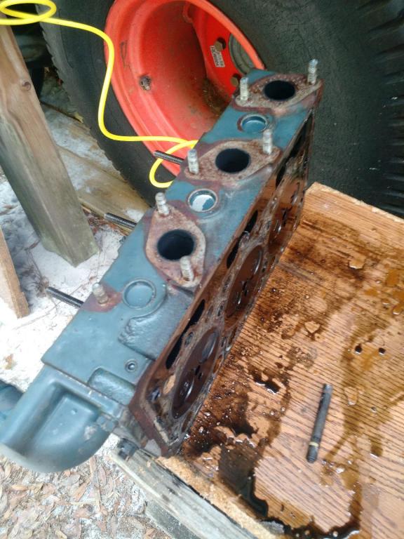

I'm thinking to reuse the head gasket(it's in good shape)but I noticed that who removed it before used black RTV...should I apply RTV??. Also, does somebody know torque specification for the Kubota L2250 head cylinder? Thanks, Daniel
36,899
11,569
No you can't reuse the head gasket, it will not seal and hold.
Make sure you use a new O-ring on the oil tube too.
Clean both the head and the block completely, use NO sealer of any kind, head gaskets are self sealing.

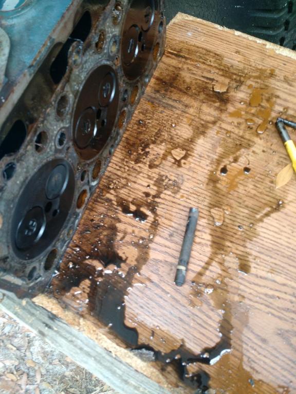

36,899
11,569
Just take some brake parts cleaner to the holes with a round brush, I use shotgun bore brushes to clean holes like that. ;)

Wolfman, there is a covered nut in the back (facing the rear of the tractor)of the injection pump, that has a little spring inside...should be remove before pulling the pump out?. Thanks, Daniel.
36,899
11,569
No, that is a speed, idle, or governor adjustment do not change it! ;)
