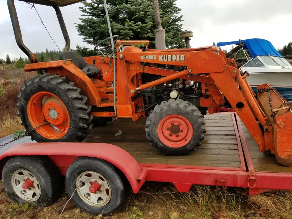

We just picked it up yesterday evening, and it comes with a second motor/transmission and rear end.
I'll start another thread looking into whether or not I could use the 245 motor in the 2250.

Question: Off the top of your head, do ya think the FEL on the 2250 would fit on the L245DT?
36,876
11,558
I will hit ya up for some help on locating parts when I get this one in the shop.....going to be a while I think.....but it's on "the list".
I think it should be able to fit, they are similar size wise, It will probably just take some rework of the mounts.
The hydraulic hookups are going to be an issue because they are totally different between the two tractors, the L245 does not have a provision for a return line, so you'll have to add an adapter to the fill port.

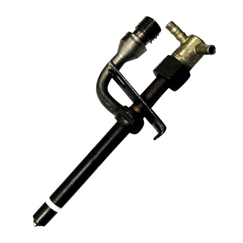

You don't remove the pencil injectors for a compression test on that model, sorry if i said that earlier, you do the compression test on a pencil injector motor, you do it via the Glow plugs, pull them all out and do the test.
If you think you got dirty fuel into the injection pump, then you will have to pull the pump and have it cleaned, I wouldn't recomend you doing it as it's got to be done in a precise manner to not mess up the timing on the pumps.
Send me a PM and I'll be able to help you out with that if needed.
The quick way to test if that is needed is to pull the injector lines off of the pump set the throttle to high and see how high the fountains of fuel are, it they are about 6" and they all look the same then your probably ok to not mess with it.
Now on the pencil injectors, you could pull them and take them to a shop and have them tested or you can connect them to the injection pump out to the side of the engine
Leave the injector line loose at first to bleed out air then snug it up and do the test.
The test is using a piece of cardboard under the tip of the injector, look for a fine mist with no dribbles while cranking, if it does that they are not clogged up.
