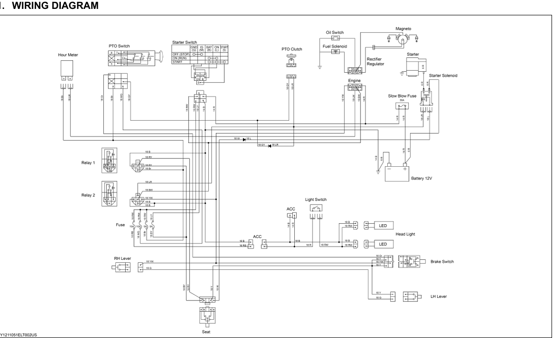

Hello Sir, I come to you for help. It would seems I am having the same issue, every time I turn the key it blows the 30a slow-blow fuse. So I pulled the pigtail off and started jumping it from the pigtail and it keeps blowing the fuse. I can't find a wiring diagram to help me figure this out. So where would you look for the this hot wire short, and is there a way to find it? I have bought a 12v light bulb to use so I stop blowing 7 dollar fuses.

Here are the two main diagrams. I had to guess, as you did not give your serial number or which engine you have.
