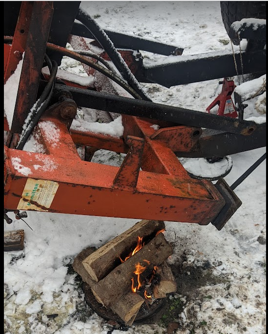

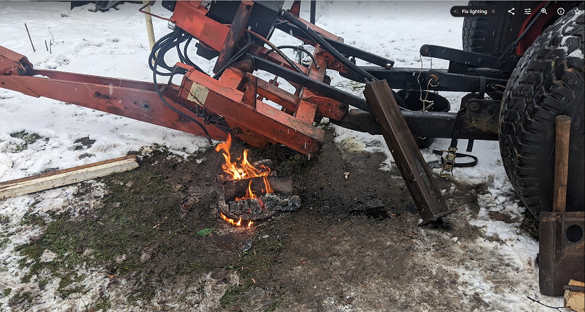

The next challenge was the leg rams, the obvious issue is that I can't simply extend them down as there isnt enough clearance, Titling the whole frame worked a treat and allowed the legs to slide out... it wasn't that easy though! It tooks lots of hammering to persuade the left leg to come out, the right leg needed even more work, including defrosting, but I got there and now have all the cylinders out and ready for the shop after christmas.
And the sweet relief of getting it out
The leg was full of liquid, no doubt a mix of oil and water which had frozen and prevented the movement, not help by the bulging of the leg post, no longer a flat slight, but bulging out and causing hard contact. this will be rectified before refitting.

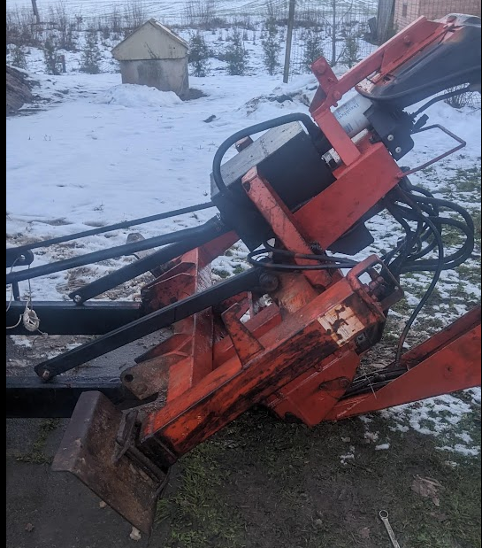

Another day of lesuirely progress on the back actor.
First job was to get it standing, so I would have access to the control valves and hoses.

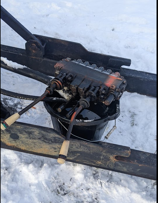

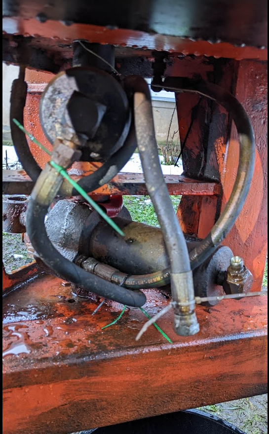

With the corrdct orientation acheived, I set about labelling the hoses on the control block. and then removing the valve block.
Valve block free.
That marked the point where all the big hydraulic parts are removed.

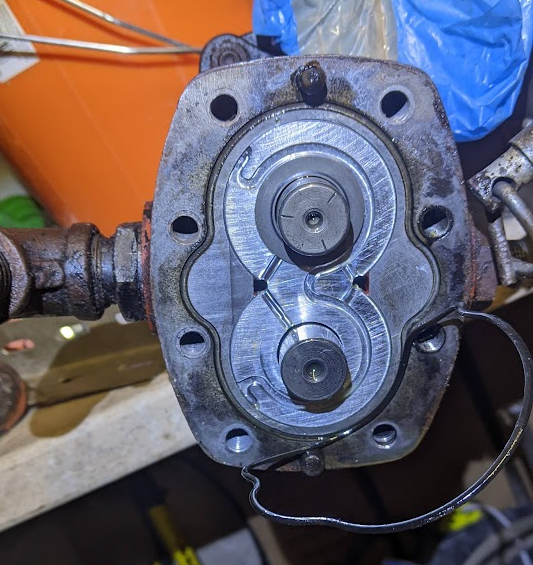

out came the bolts on the end of the pump, hide faced hammer to get the end plate off and there were the gears
All looked good there, the back of the cover plate also looked good apart from a few needle rollers that were misplaced in the removal process.

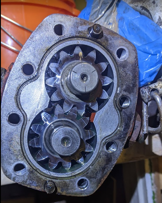

Behind the inner plate were the gears, these also looked good, and when turning the PTO input by hand there was oil being displaced, all good there.
Then I split the pump from the gearbox, so I could remove the gear for inspection, the gearbox end didnt look so impressively clean.
10,107
4,171
wow, you've really got a 'project' !!! Nice to see the pump clean inside..
you can use some grease to hold the needle bearings where they belong when reassembling. Far fewer than the DOUBLE rows that were in an old Willys transfer case I rebuilt !
If the case doesn't slide on nice and fit flush by hand, pull it off and check for a single needle bearing that's fallen down, laying flat on the bottom...BTDT... if it happens use MORE grease !

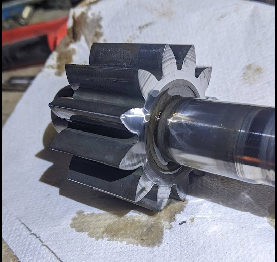

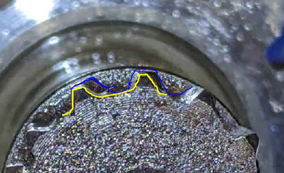

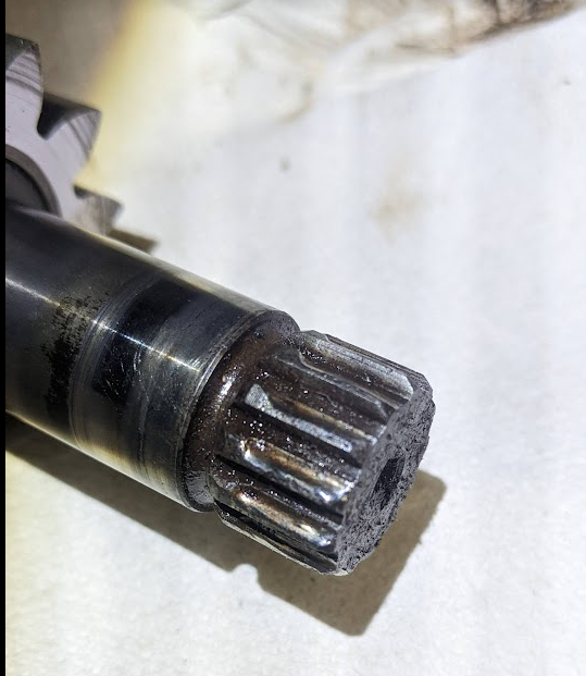

With the pump detacthed from the gearbox, I was able to push out the pump gear and take a closer look.
The pump teeth are in great condition, no chips, or meshing clashes. The bearing surface is little shiney.
I was feeling quite pleased that the pump looked to have a clean bill of health. A quick clean and I could get it back together!
So clean I did.
Oh boy!
What have we here? Or rather what haven't we here!
From the end I have drawn in yellow the worn tooth profile and in blue the approximate unworn tooth profile.
Well, that would certainly reduce the effectiveness of the pump! The gear doesn't look to be removeable, it is a single piece shaft.
The wear seems to be caused from PTO input which was bouncing around in the housing when I moved it by hand.
I'll try to get a little video for you of the wobbling.
I don't know if the shaft can be repaired, but I suspect even if it can it won't be economical. I'll have a look for a PTO pump...
