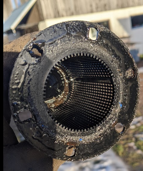

Now I was short of oil, so I thought I would top off the cylinder and the tank. off came the tank cap, and whats that in the mesh?

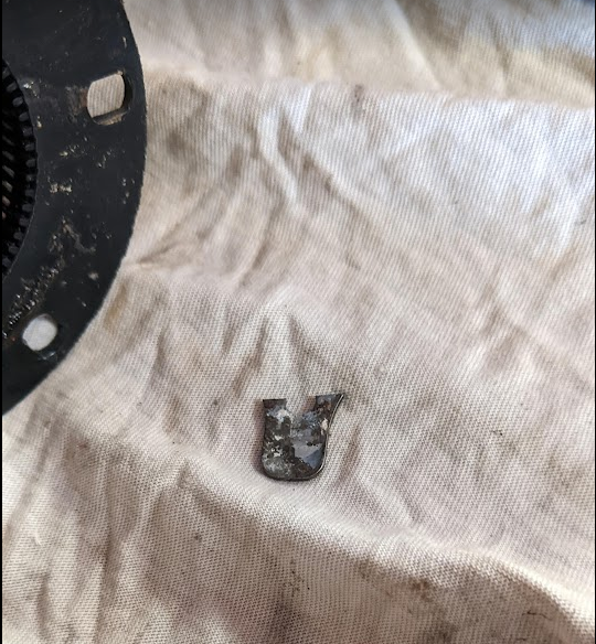

to the workshop and scrape it out.
a metal fragment about the size of a jacket zip. well, thats not great but at least it wasn't floating around in the system. Actually, what is floating around in the system? A quick dip with a magent on a stick and...

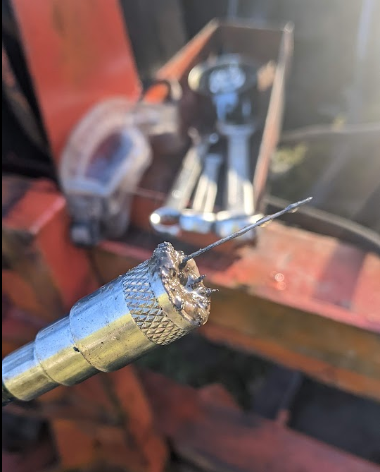

oh dear, wipe it off and have another dip
and n dips later
This looks to have some balls of metal in it, not just the swarf, but multiple recognisable balls. but from where?

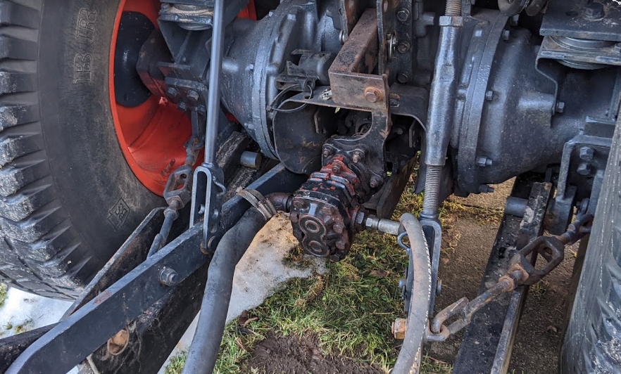

Hopefully this backhoe used a pump that runs off the PTO and not the tractor hydraulic system?
Correct, its PTO driven so all the contamination is isolated to the backhoe. A saving grace.

Almost looks like mig welding wire.in one picture.
Was that in the tank past the fill screen?

I have done repairs to lots of hydraulic systems. That looks like some odd contamination. Usually you see fine shavings. Big pieces from a small gear pump like that is using is very odd.

Yes, all those metal pieces were in the tank past the screen.
Hopefully I'll soon be able to tell you where they are from.

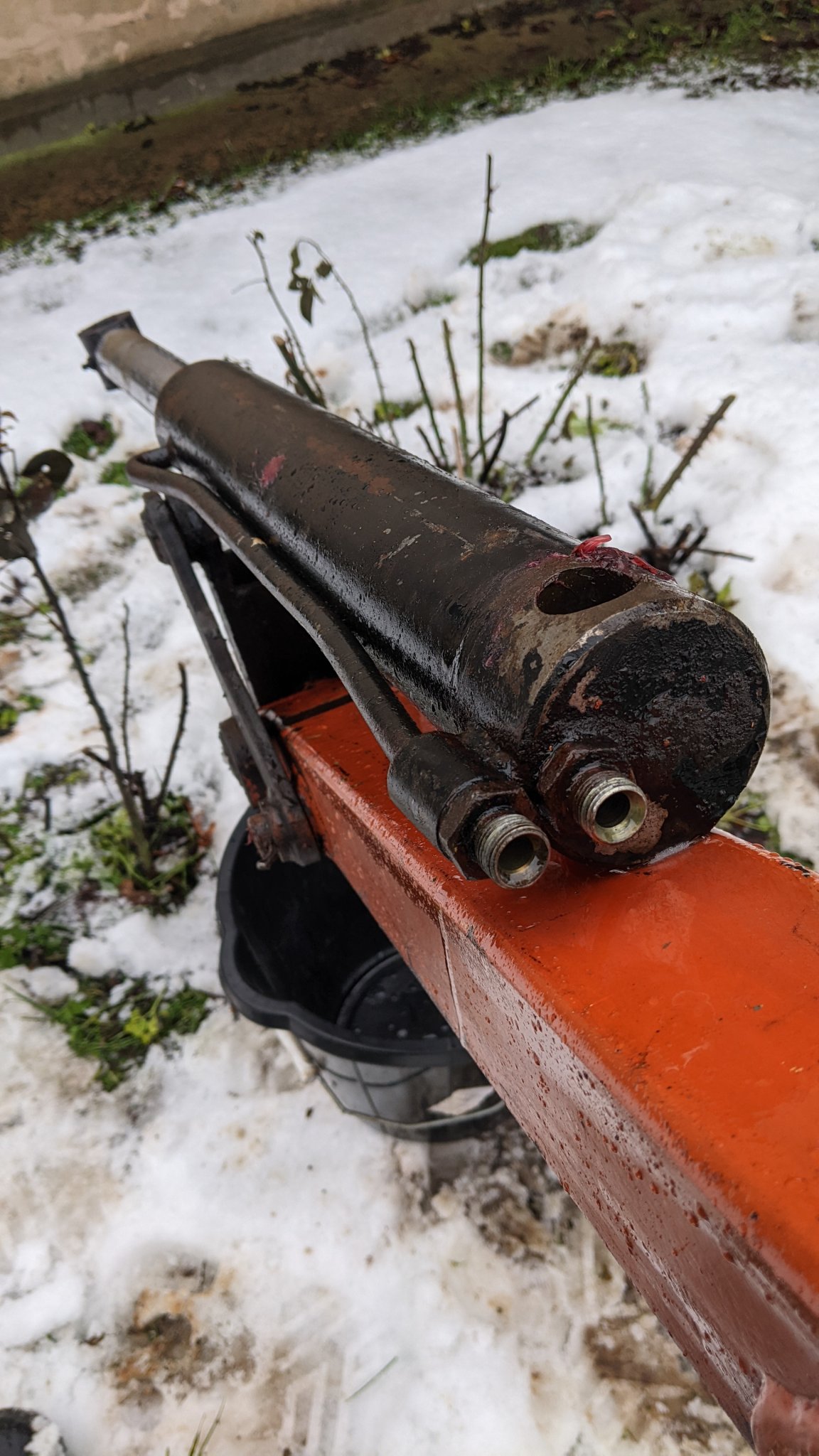

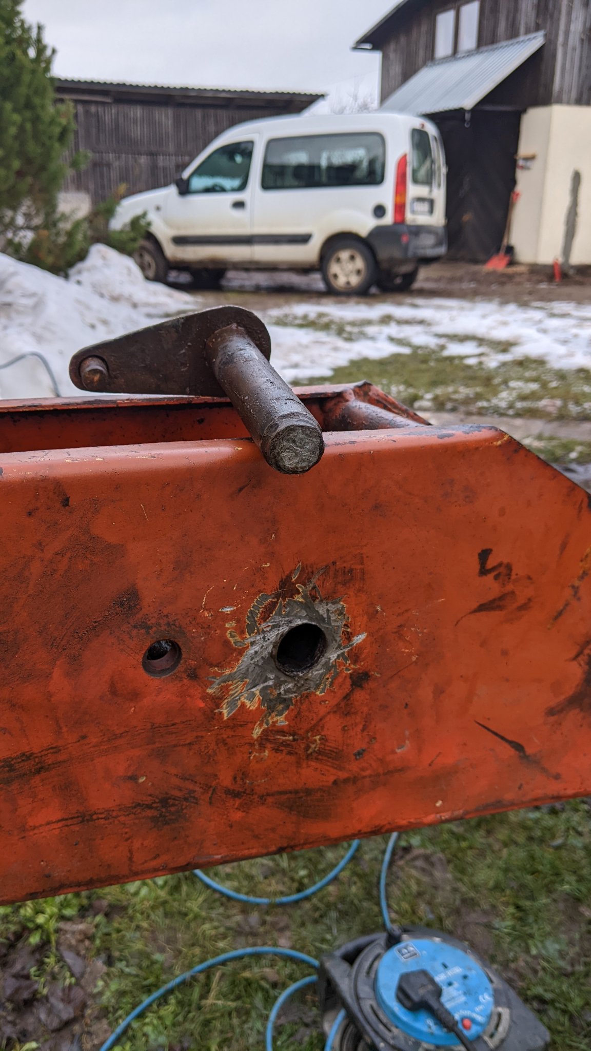

This pin took longer than the other two cylinders to remove, it looks like its mushroomed on the end and has some wear in the centre, I'll tidy it up before refitting. Boom cylinder removed!
Bucket cylinder removed, that went quite well.

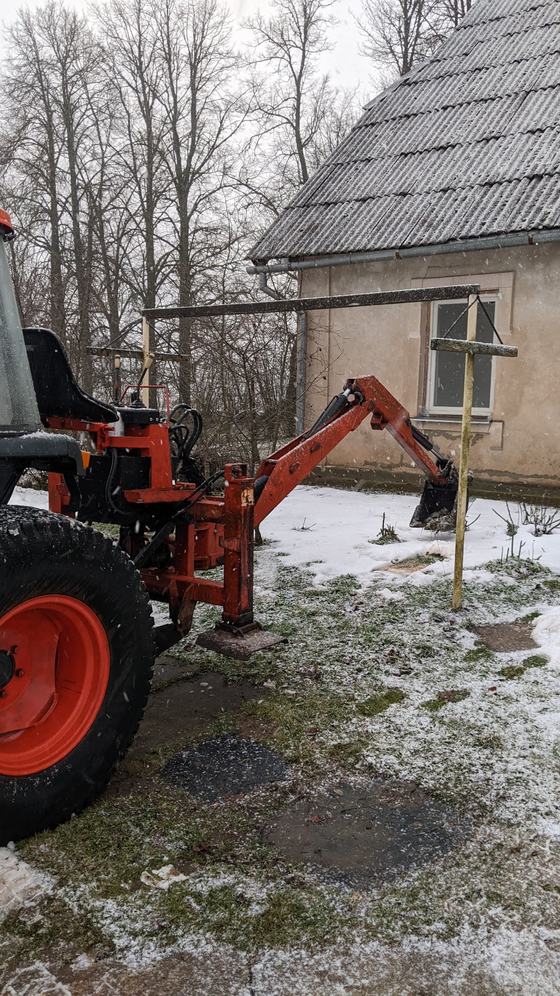

Backhoe ready for disassembly with over head gantry washing line in place.

Sounds like Mr. Fixit> Fixed it one last time, before he was looking at a lot of time and money to fix it right. Hopefully you got the BH on the cheap. By time you're done, it will almost have involved a complete rebuild.
Atleast all said and done, you'll know what you got.

View attachment 118512 This pin took longer than the other two cylinders to remove, it looks like its mushroomed on the end and has some wear in the centre, I'll tidy it up before refitting. Boom cylinder removed!
View attachment 118515 Bucket cylinder removed, that went quite well. View attachment 118517 Backhoe ready for disassembly with over head gantry washing line in place.

Does all the return oil go through that mesh? It obviously didn't catch some sizeable pieces.
Could you install a filter on the pump suction line? You need to catch that junk before the pump. Probably need to clean the valve too.
All in I could consider the backhoe to be about €1,000 worth.
Yes, it has had some abuse from previous owners. If I rebuild it I'll know what i ahve is good and get many years of good service from it.
I'm not sure how that mesh works, as it sits in the filler neck.
There is an oil filter on return line from the valve block, but on the suction line makes alot more sense

The mesh in the neck is supposed to keep 'stuff' from getting INTO the tank.Unless it's fastened somehow, you have no idea when it was installed. Since there were 'items' bigger than the holes in that screen on the bottom of the tank, it wasn't doing it's job.
