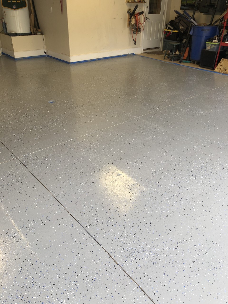

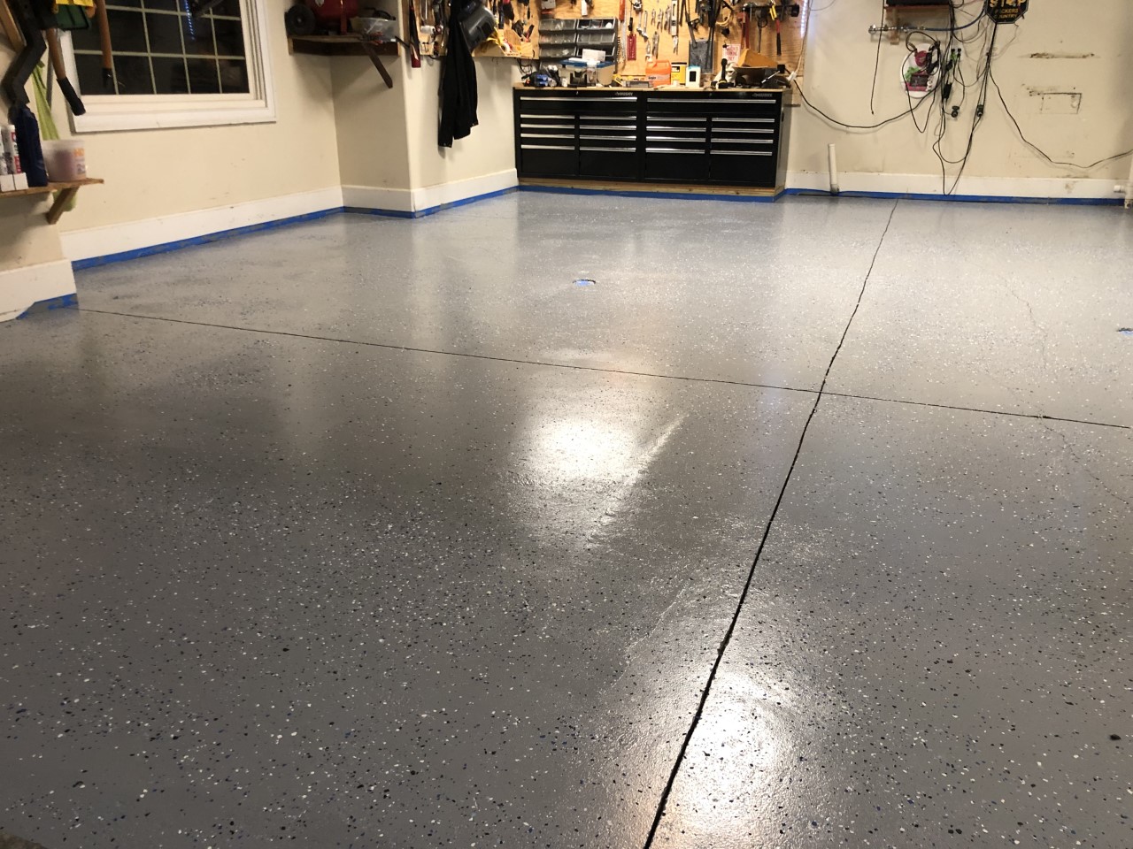

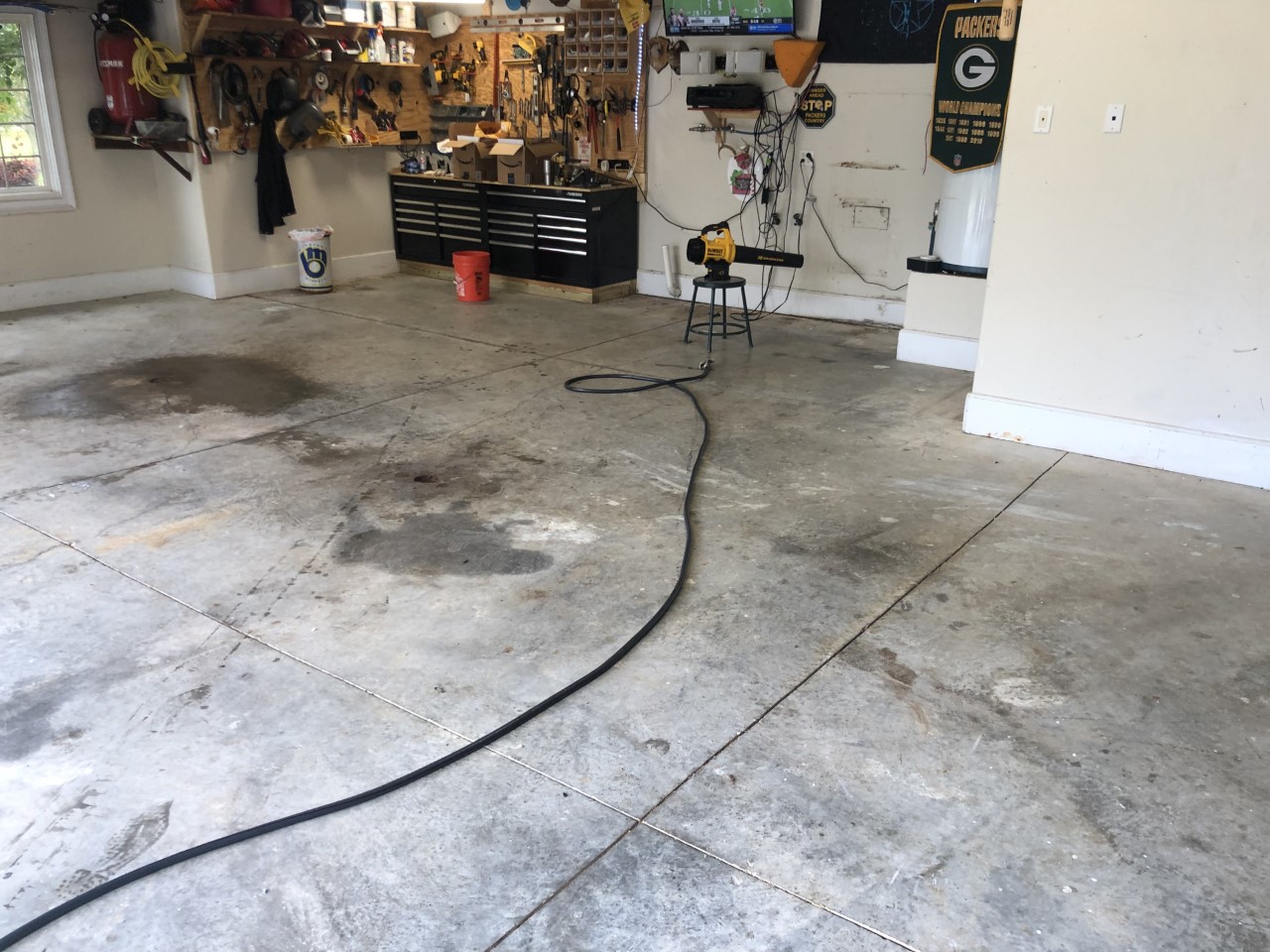

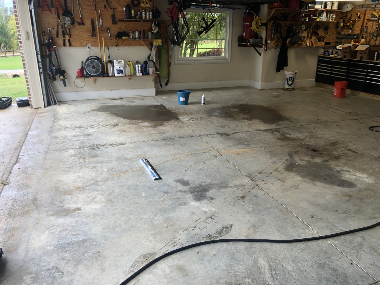

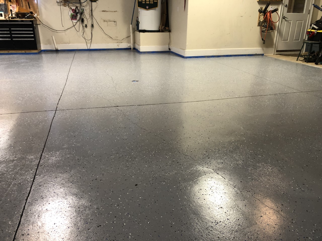

We moved about 18 months ago into a home where we have a 3 car garage. Prior to that we only had carports. Well last weekend I decided to paint the floor with the Epoxyshield and it turned out great....so far (Before and after photos below). After doing that it looked so good I figured i would paint the walls. When I was removing my flags and pictures I was astonished at the spider webs.
Does anyone have any tips on keeping them down to a minimum? We have a monthly pest control service and have no bugs in the house so I can't really fault them, or can I? I try to blow them that does no good. I sweep them but with the photos and various critters hanging on the walls you can't really get it that way.

You'll really appreciate the slick painted floor the first time it gets wet and you slip and fall on your ass and bust your melon on the concrete. Spider webs will be the last thing on your mind.............. Did that too because it looked nice. When I found how treacherous it was, I rented a floor sander and roughed it up. Been good ever since.

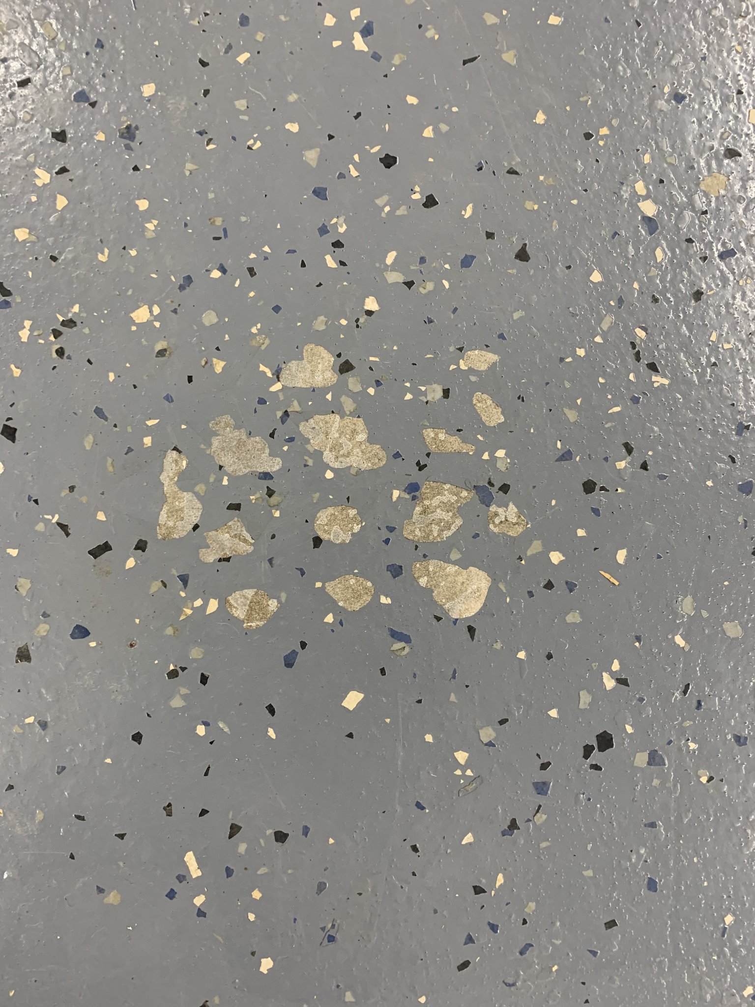

I did the same to mine over the summer. I used light grey on the walking areas and gun metal grey were we park. I used a non skid mixed in the expoy so it is not slick. I have a Kubota Side Kick I parked on it two weeks later and it pulled up the expoy shield. on three of the four tires. I hope you have better luck. As for the spirder webs I painted my walls a satin finish. Makes it easy to clean, makes it brighter and seems to keep the spider webs down.

I added a good bit of play sand in the mixture. If YOU would have taken the time to research the slipping issue BEFORE you started and properly prepared the floor and paint you wouldn't have had to 1/2 a*^ the job by 'roughing it up'. See the sand added to the mixture does the 'roughing' for you, no need to destroy the finish with a floor sander.
That's called 'common sense' and 'planning'. Like when you walk into a car dealership and the pretty painted concrete floor no one slips on...because they planned ahead and added texture, not make texture AFTER you are done.
Been raining here for three days straight floor has been very wet and haven't slipped yet not even a budge, but thanks for the concern. As usual, your comments have nothing to do with the OP and as usual add nothing to the conversation.

Your floor looks great! I use metal interior walls and find large smooth surfaces are easier to keep clean. If you live in the country then dust, spider webs and critters are a given. Buy a decent shop vac and clean regularly. If you make things so air tight to stop critters you will need some sort of HRV/ERV to keep the air fresh and mold out.

^^ that's not how it works ^^
when done properly epoxy is not slick. Using floor paint is the cheap, slippery, crappy way out. Epoxy mixed with sand and/or flakes is plenty grippy, even wet, and even coated with a gloss clear coat. sorry you took a sander to your floor... eeek.
OP, Best way to stop bugs from getting the garage is make sure all the doors are sealed completely, and do perimeter sprays inside and out with TalStar P. I have a rubber seal on the ground and on the door. Plus the entry door.
Lots of snow, rain, and fluids are spilled on my garage floor all the time

I contacted Rustoleum to see what they could do for me. My garage floor is just under 1600 SQft so I used a lot of their product to cover it. The funny thing is it only happened in three little spots the rest is fine.

Interesting. At least it is limited to those areas

The floor looks great btw. Maybe there is a clear or something you can put over the top to reduce the risk of it lifting up like what Mlarv experienced?

I thought I updated this. Restoleum came though and is sending me a coupon for another gallon to repair the spots. I used Lock Down primer and it is not supposed to be used before Epoxy just water based according to their official site. I showed them that the Lowes site said it could be.
