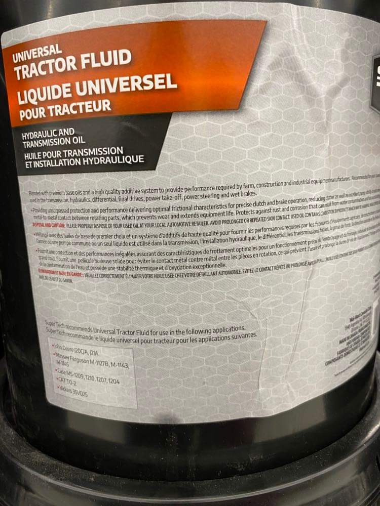

Is this oil suitable for my 2002l3710 hst??

If me I would not. few thoughts:
your model tractor carries some decent value still
walmart not know for high quality walmart branded stuff
pail doesn't say hst approved

With respect, I don't believe it is picking nits. To quote the Standards Division with the North Carolina Department of Agriculture and Consumer Services, “the lack of any specifications does not provide the purchaser with information for its intended use, nor the ability to test the product for meeting those specifications.”
Now, they were specifically referring to the so-called "303" or "yellow pail" fluids marketed as budget tractor hydraulic fluid. These fluids claimed to meet John Deere specifications when in fact they were claiming to meet a a spec abandoned 50 years ago (and actually didn't even meet the obsolete standard). They have been shown to damage HST tractors.
To extend your analogy, it is like slapping a label that states "meets Ford specifications" on a bottle of straight 30 weight non-detergent motor oil and putting it on the shelf beside the Mobil1 and Castrol GTX. Yes, all three might have similar viscosity at a given temperature, and yes, all three will work in your Model T, but that's where the similarities end. Things won't end well if you use it in your F150.
The reason we know the Mobil1 and Castrol GTX oils are interchangeable is because -- as you correctly pointed out -- they are tested and proven to meet the same specifications. Not just physical properties, but all aspects. They might use different additive packages, but they achieve the same goal in the process.
Marketing phrases like "Suitable for use where Kubota UDT is specified" or "Approved for use in Kubota tractors" (Approved by who, exactly?) tell us nothing about the product since there is no published Kubota specification.
In the case of the OP's Walmart pail, the label indicates "SuperTech recommends Universal Tractor Fluid in the following applications:..." (none of which are Kubota UDT)
Note carefully the weasel words. No where do they state it actually meets the specifications that follow them. Very much like the wording on the yellow "303" buckets that were banned from sale in some jurisdictions.

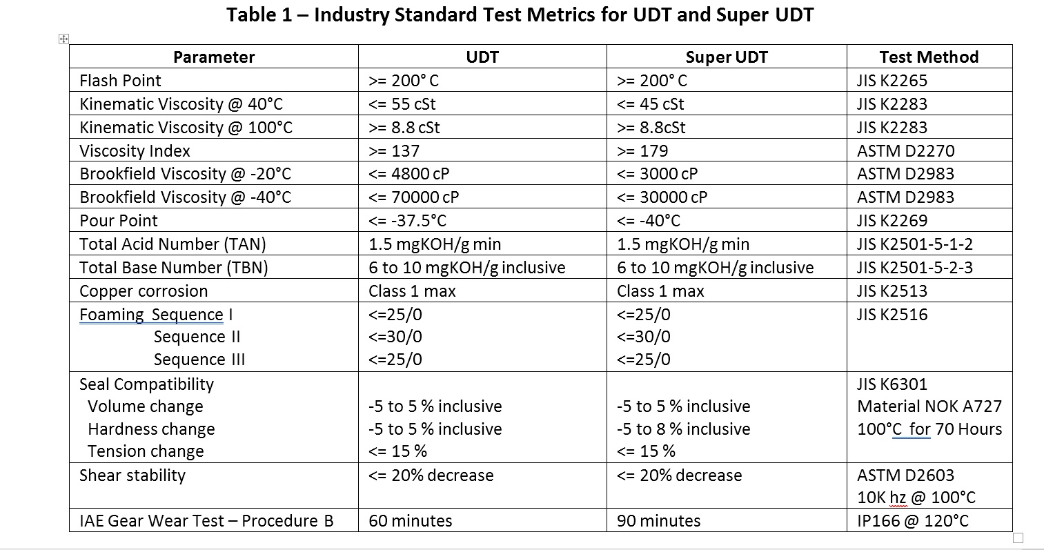

For interest sake, I attach a chart I compiled comparing the physical properties of various name-brand tractor transmission hydraulic fluids. It is interesting to see the wide variation.
Hmmm. No I won't. Forum software does not allow Excel files. Well here it is if you want to download it: Comparison Chart.

So what are the Kubota performance requirements for UDT? Here you go - straight from Kubota - nothing special and easily satisfied by any number of premium UTTOs that have probably not actually been tested against this exact table and certified by Kubota.
There is no industry standard for AW hydraulic oil but nobody gets worried about which brand they are buying to go in their high dollar Case backhoe or excavator. The reason is simple - its a low bar with very generic requirements and easily met. The same is true for UTTO - basic viscosity and GL4 performance.

@torch no disrespectf and I could have used better terminology knowing that this was going to turn into one of the infamous "oil threads" so I stand corrected in that nature. I did miss read the label on what I use and I took of a picture of it this morning that further confirms your original suspicions of my original, since edited statement. If you zoom in you can see that it says "reccomended for the following applications" and it lists standard kubota UDT as well as kubota trans/hydraulic fluid (w/e) that is.
I'm sure that label isn't printed willy nilly becuase it could invoke some serious lawsuits of it was.
But to my original point I wasn't trying to make it sound like it was the same exact stuff as the kubota udt (of any kind) I was simply trying to relay that I use it in my (year unknown) b7100 gear drive since they share the same sump for the gear trans and hydraulic sump. If I was doing more then running a hydraulic pump for hydraulic rams etc and didn't have a gear trans I would only run the actual kubota fluids since the HST'S are very expensive to fix and the juice wouldn't be worth the squeeze so to speak. Again I thought I was pretty clear on my take and referencing that I wouldn't reccomend it or any other aftermarket hydraulic/trans oil in a HST but if I was unclear on that im sure it's clear now

@torch no disrespectf and I could have used better terminology knowing that this was going to turn into one of the infamous "oil threads" so I stand corrected in that nature. I did miss readthe label on what I use and I took of a picture of it this morning that further confirms your original suspicions of my statement if you zoom in you can see that it says "reccomended for the following applications" and it lists standard kubota UDT as well as kubita trans/hydraulic fluid (w/e) that is.

Interesting chart, BTW. That is the first time I have ever seen something from Kubota specifying their requirements. Very useful. Where did you find it?
I have friends in high places :)
I have posted that chart (my creation) before along with this link.
I made my living as a researcher and data is what drives my thinking. When I was working I could get access to SAE publications for free - now I have to pay out of my pocket. I purchased that (copyrighted) report and used it as the basis for the "public domain" chart. The SAE report is not expensive ($35?) and if you want to know exactly what Kubota was after with the development of SUDT buy a copy and read it - several times. In a nutshell they wanted an oil with improved cold weather pymbality and filterability along with increased water tolerance. Thats what separtes it from ordinary UDT and generic UTTOs. John Deere's J20D formulation is similar and CNH has a formulation which they market as Ambra Ultraction SSL. Ultraction SSL was developed and is blended for CNH by Viscosity Oil and may be best of the three. Other than that there is not much of that ilk available.

I find it fascinating that apparently Kubota's fluids don't fully meet that spec.
Comparing your chart to the published physical properties that I was able to find online, the viscosity of SUDT-2 @ 100°C spec is >=8.8cSt but the published value is 8.1cSt. The viscosity of UDT @ 40°C is supposed to be <=55cSt, but the published value is 60cSt.
I wonder if the spec was changed over time? Or if manufacturers just could not meet the full specification? The only two fluids that appear to meet or exceed the SUDT-2 spec for viscosity are Chevron All-Weather THF and Co-op Super T-HF SB. I have no idea if they meet the other criteria however.
My UDT data is the is from 1998 and that difference in KV100 viscosity is not significant.
Chevron AW THF Is supposed to be a J20D fluid. Good luck sourcing it. Same issue with CNH Ulraction. And if you do find either they will be more expensive than SUDT2.
