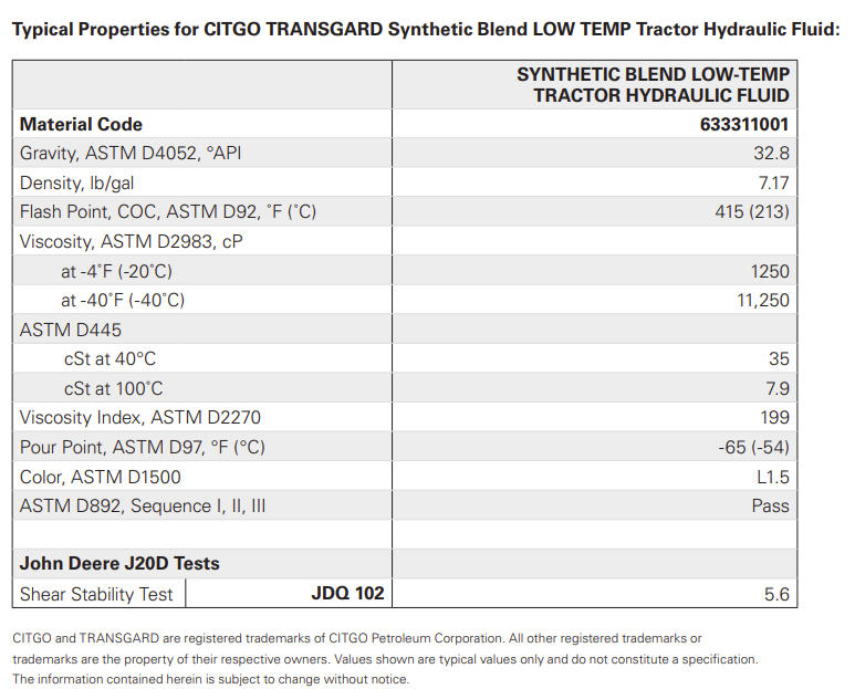

The thing that separates UTTO from conventional gear and hydraulic oil is viscosity index. Traditional gear and hydraulic oils are monogrades with a VI around 100. The defacto industry standard for UTTO is 130+ which makes these oils multigrades.
Oils like SUDT2 and JD J20D are cruisning way up there with VIs at or near 200. That and their ability to suck up and dissolve not disperse/emulsify water is what separates them from the middle class.

Interestingly I stumbled on this while looking up the source for Wallyworld THF. Looks like Ciitgo has a J20D/SUDT2 clone. Mighty fine looking PDS. I will bet it aint what Wallyworld is selling and probably not cheap if/when you find it..
