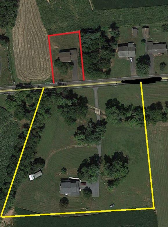

That sounds like a nice size to me. I have about 3-1/2 acres (outlined in yellow) and my neighbor has about 1/2 an acre across the road (outlined in red). Our lot has a number of trees, a creek, a couple sheds and some rocks to mow around. Neighbor has a few trees.
I use (and dearly love) an L3200 with a 6' RFM for both properties. I can do mine in 1-1/4 hours if I hustle, or over 1-1/2 hours if I get anal and do diagonal passes. It takes all of 20 minutes to do the neighbor's place. That includes cut, trim and blow the grass off the sidewalk and driveway.
I always have the entire FEL and frame off unless I'm using it for something. It's too easy to get the loader off to have it along for the ride/
