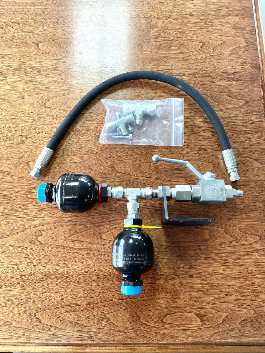

I’m also in the camp of slow and steady for the win. But if you have an issue with a hydraulically supported load combined with uneven terrain causing unacceptable bounce, a check valve isn’t the answer. Accumulators are made to address that exact issue. Many large commercial loaders include them as standard equipment. Having the ability to valve it in or out of the circuit is useful if using forks or something similar where precision is required regardless the load on the hydraulic circuit. For something like that, the accumulator can be a bit irritating.
When I was transporting logs out of the woods with the grapple on my L, I considered getting one for the loader boom circuit but when I got the skidding winch it changed my process such that the accumulator was a solution in search of a problem for my purposes.
Example of an aftermarket product aimed at utility tractors:
