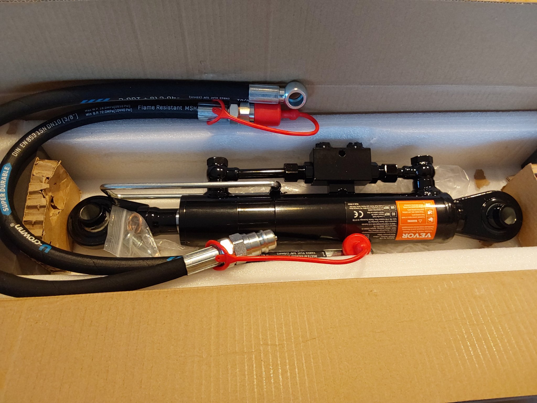

I can't wait to try the toplink. Wound up getting it for $127.00 after discounts and points when the new stock arrived. Hope it works good being so cheap with hoses and qiuck connects. The stump grinder pto needs to be set to 17 degree universal angles so have to come up with some kind of gauge for repeatability.

Well it finally arrived and looks really nice. Cold is back so going to wait until next week to try it. Looks really nice and came with decent looking Chinesium hoses. Hopefully it swaps right in.

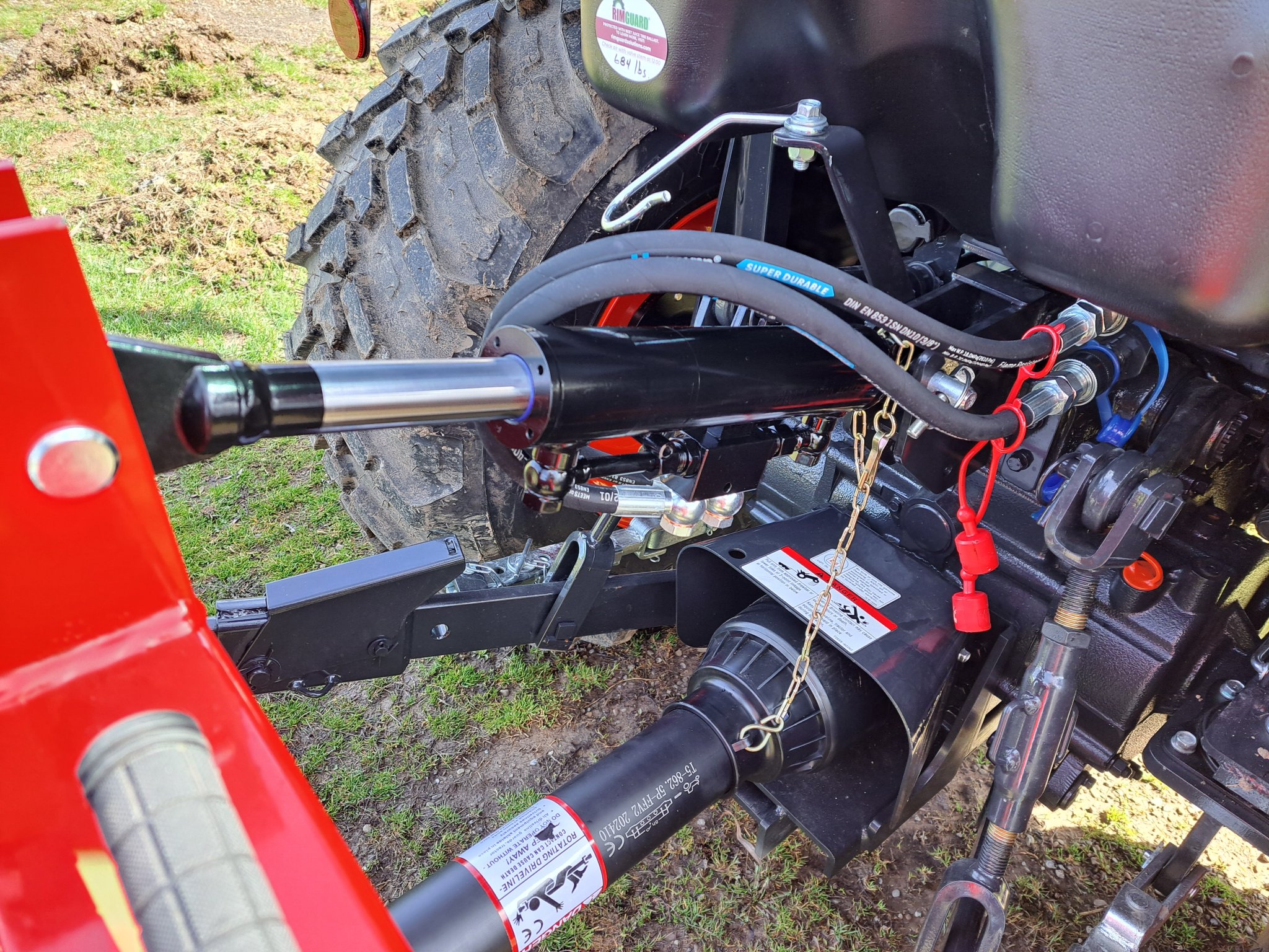

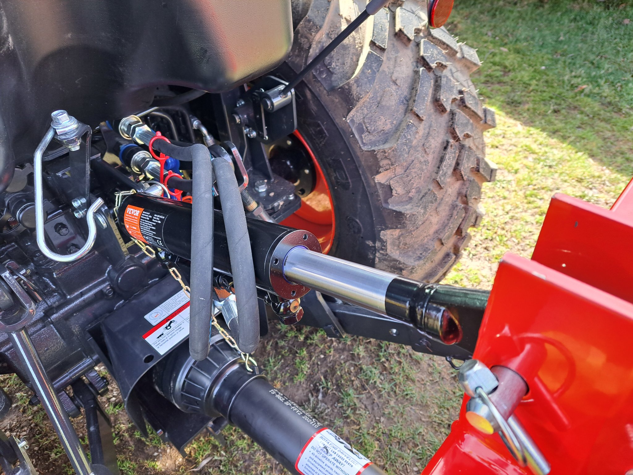

Top link fit on with a little grinding. Bushing was a little wide for the mount so had to grind about 1/16" off it. No leaks and works. If I try to extend it full speed it's a little jumpy. Go slow and it's smooth so seems like the lock doesn't like fast. Mounted it with the lock block down then looped the hoses over the top that keeps them easy to plug and out of the way. I'm happy so far, wish it would dry out enough so I can try it. More rain and snow on the way 😬.

would it have been better to mount the top link cylinder where the lines/fittings would be on the top instead of the bottom ?, this way it would give you more room for the lines.
I tried that first and found the hoses hard to plug in plus the lock block was vulnerable. This works best for me but it is easy to flip also.
