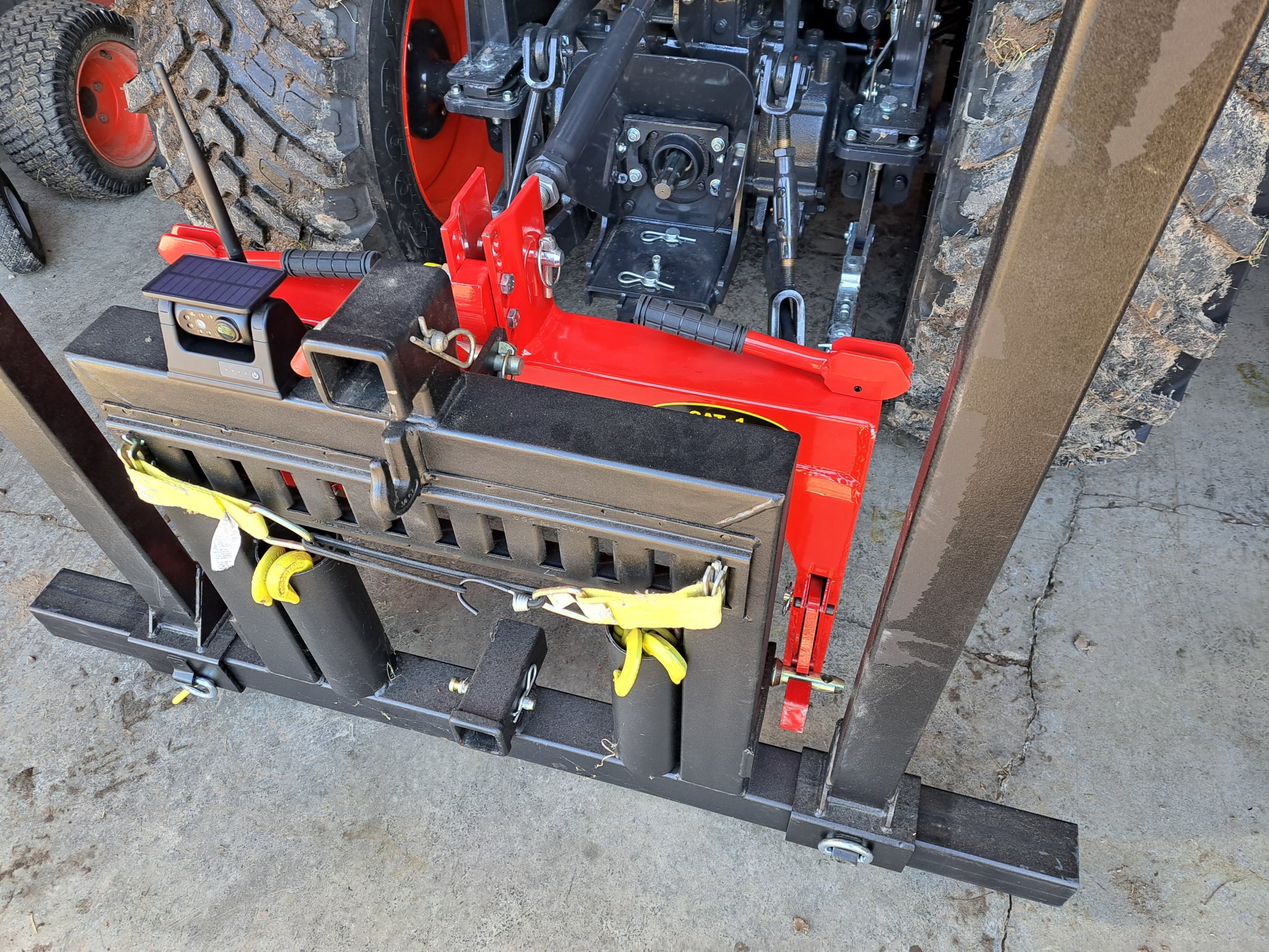

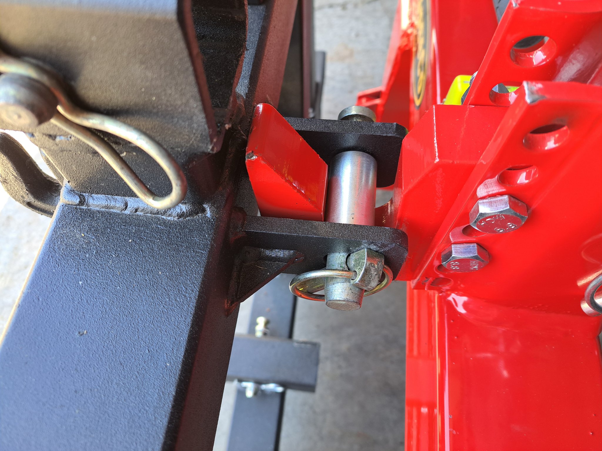

Well couldn't wait any longer to try it and it was over 50 degrees so I took the blower off. It's quick hitch compatible so will go right back on if we get a big one. Hitch is very nice but after measuring my trailer mover, 6 ft rake, sickle bar,and box blade are too narrow to use with it. Guess I'm eventually going shopping 😄. Tossed on my pallet forks and they fit good but had to move the hook up. Measured the width with the screws removed and it's 2 inches (50.8mm) so probably going to make some pins to replace the bolts so I can put some UHMW washers under them and just use standard hitch pins with the spring loop for finger access.
One thing I noticed is that the top slot is really big for a cat1 pin. I slipped a cat 2 bushing on the pin and it's still oversized. Guess that's to make it easy for alignment.
At this point, just the forks and 30 cu ft dump box fit it. I'll probably stretch the rake hitch and replace the box blade along with replacing the sickle bar with a flail mower. Is it worth it? I think so but not a simple universal answer for those of us that bought implements 25 years ago.
The top hook is intended for an 1-1/4" CAT 3 pin. Notice the CAT 3 bushing on the top pin of my Land Pride SB1574 snow blower. Also, the bottom 1-1/4" pin on the Land Pride RCR1884 rotary cutter that drops into the top hook of the QH.

I definitely will have to make some cat 1 to cat 3 bushings or machine a smaller hook. What a crappy design. They say no bushings required with this one 🤔.
Yeah, it's a messed up world. My Everything Attachments box blade and land leveler have CAT 2 pins (1in) for the hook when using a QH. I use them in combination with a QH but never bothered to change out the bushing for a CAT 3 for the top hook. 😂😊
Another job to add to the list. CAT 2 to CAT 3 bushings.

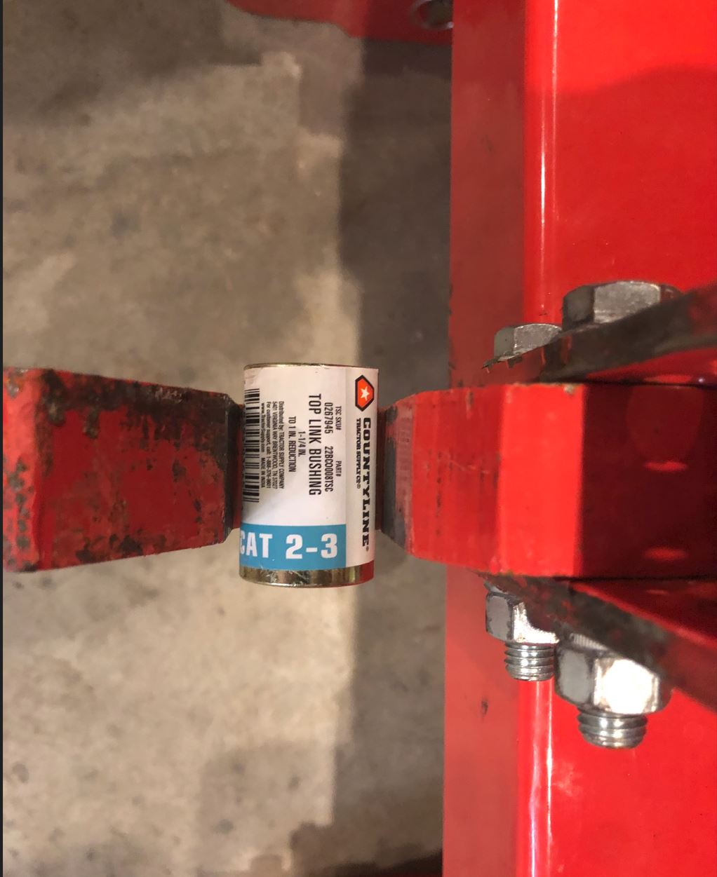

I assumed that your attachments were all cat 1 compliant. Now I feel bad.
You should just need to add a cat 2-3 bushing to take out slop if you so desire. I generally don't on most of my attachments.
For the really odd ball, you can use something like this:

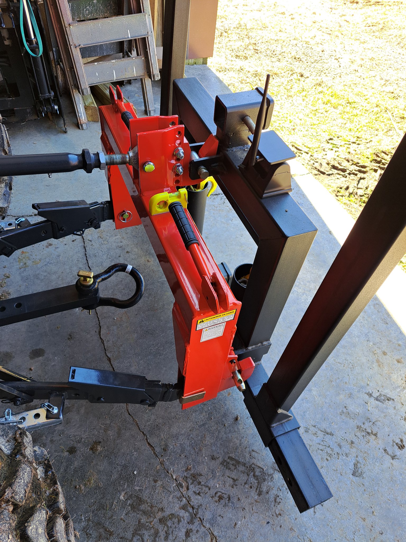

Boy is this sweet with attachments that are made for it. Got the stump grinder yesterday and took 15 seconds to hook it up. Still need to get off for the pto, but that slips in easily. I like how the top link has multiple holes so the implement matches my other attachments. Top link is supposed to be here Wed. Definitely worth it in the end after a couple surprises.
