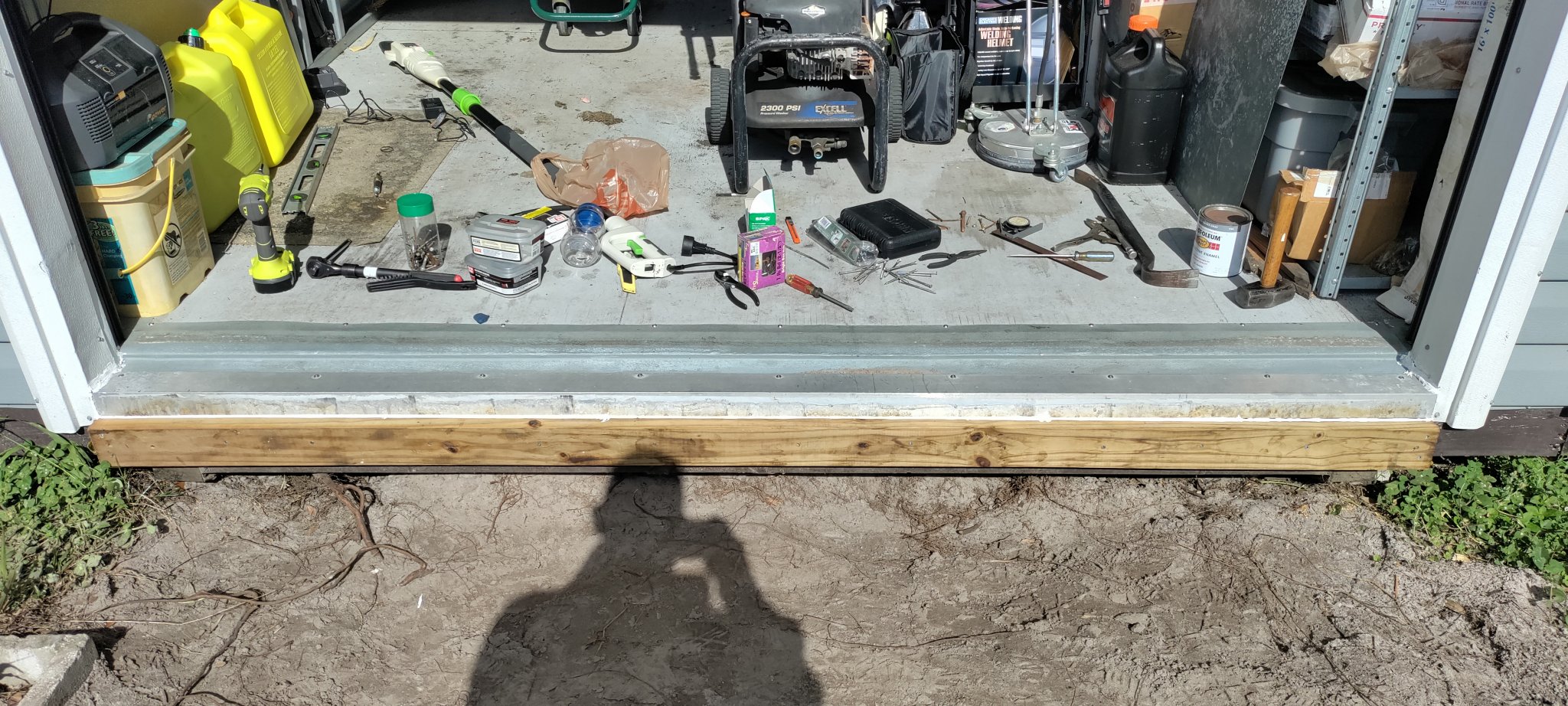

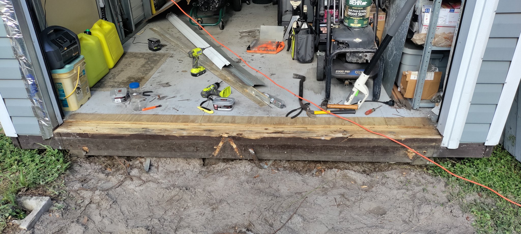

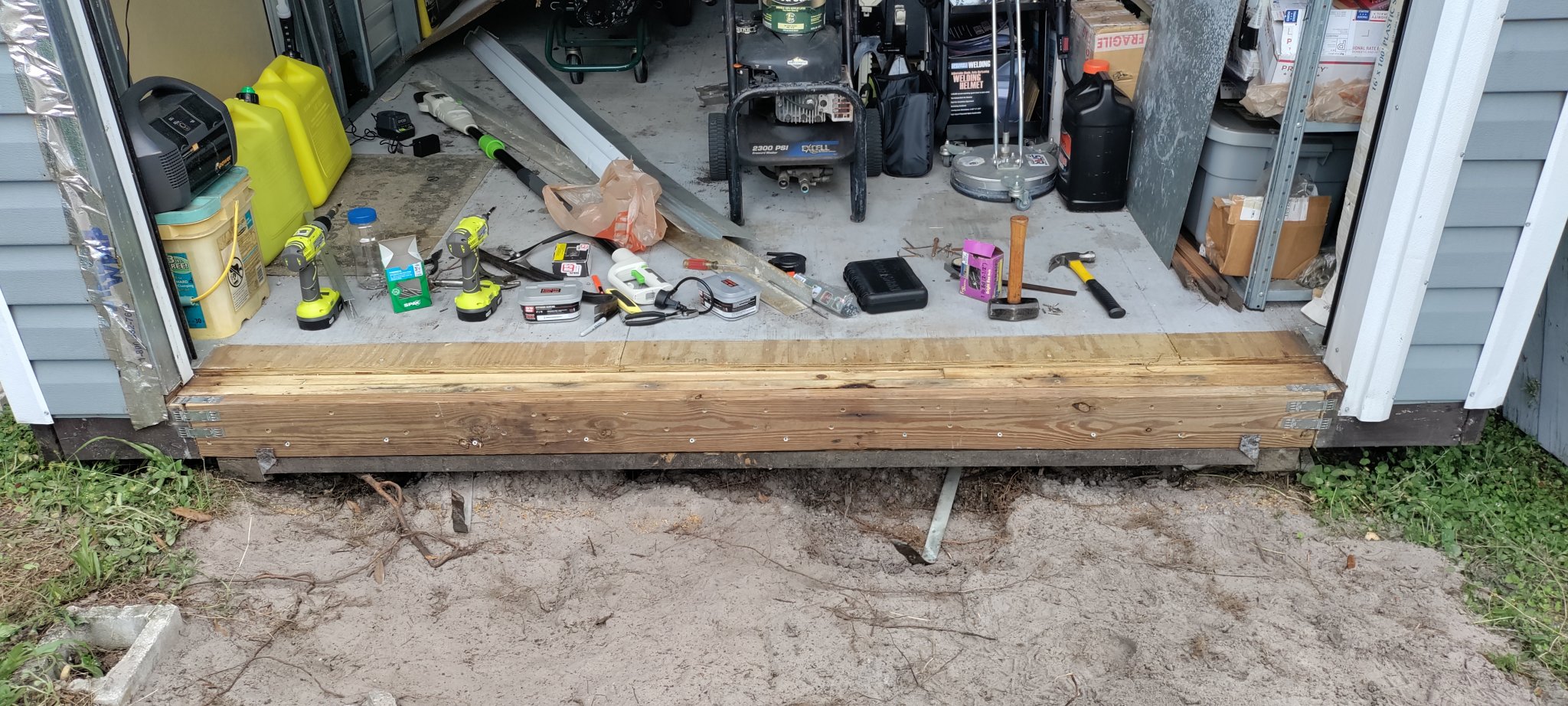

My only comment would be to put some support in the center of the joist where the ramp attaches to. My 12 by 16 shed id only supported from the ground on blocks on the skids. It turns out that after a little over a year I noticed the edge of the floor flexing as I came off the ramp and onto the floor with the tractor. I expected to find rotten wood but after peeling the aluminum cover, I found that the edge of the floor was made by sandwiching three 2 X 6 'S and the outer one had a defect and cracked the second one was fine but the third had a splice right where the crack was on the outer one. I spliced in new outer piece over the skids and also dug a hole and put a (dead) concrete bag with some blocks and shimming to prevent any flexing of the joist in the center. Replaced the aluminum cover and the ramp support and ramp. No more flexing of the floor.
