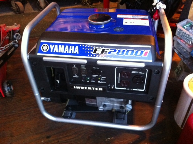

My Yamaha is the same way. Quiet, fuel miser, will run all the refrigerators and freezers, computer, TV's until the power came back on or I decided to get the 12Kw out. None of that matters now though since we went Generac 24K standby.
But yes, Inverter technology is nice to have.

My Yamaha is the same way. Quite, fuel miser, will run all the refrigerators and freezers, computer, TV's until the power came back on or I decided to get the 12Kw out. None of that matters now though since we went Generac 24K standby.
