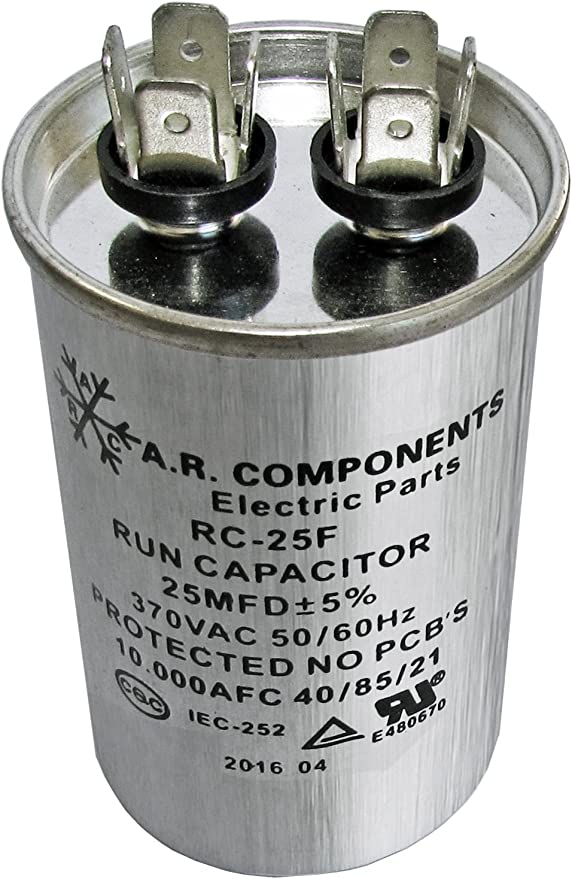

There’s another, ever RARER failure-mode that can occur with portable generators. The voltage output may disappear and the little drill-motor “fix” doesn’t work. Inside the “control-panel” of the portable generator you may find a small capacitor/condenser…. a little metal ”can” or cylinder…might be about the size of a D-cell flashlight battery…. and it may have failed. (This sort of thing might already be familiar to you when your home central air cond unit ….which has a larger capacitor the size of a shaving-cream-can….fan-motor/compressor-motor fails to start/run.)
The typical portable generator has a capacitor rated at about 25 uf (micro-farads) … and (less-importantly ) which can operate at up to 300+ volts. If that capacitor/condenser fails the portable generator may fail to excite/initiate….until you replace it with a good one.
This occurred to me on a camping-trip thru Jackson Hole. We were camping on BLM land and needed our generator as it was HOT and we wanted air-conditioning. No one in Jackson Hole had any idea what I was wanting…. until I found there was a water-well drilling service in town.
I pulled up to their maintenance shop and asked if they had any run/start pump-motor capacitors. Yep…they had a large selection…and they wanted an outrageous $60 for one that was ..close but not exactly correctly-rated…. theirs was 40 uf… but I bought it and installed it and the little generator made 128 volts for the rest fo that trip.
When I was able to get to a Whole Foods (Amazon Drop-Box) I ordered/received ($11) the correctly-rated 20-25uf capacitor…which fixed the little generator …puts out exactly 120 volts again. That was 4 years ago and still running fine.
