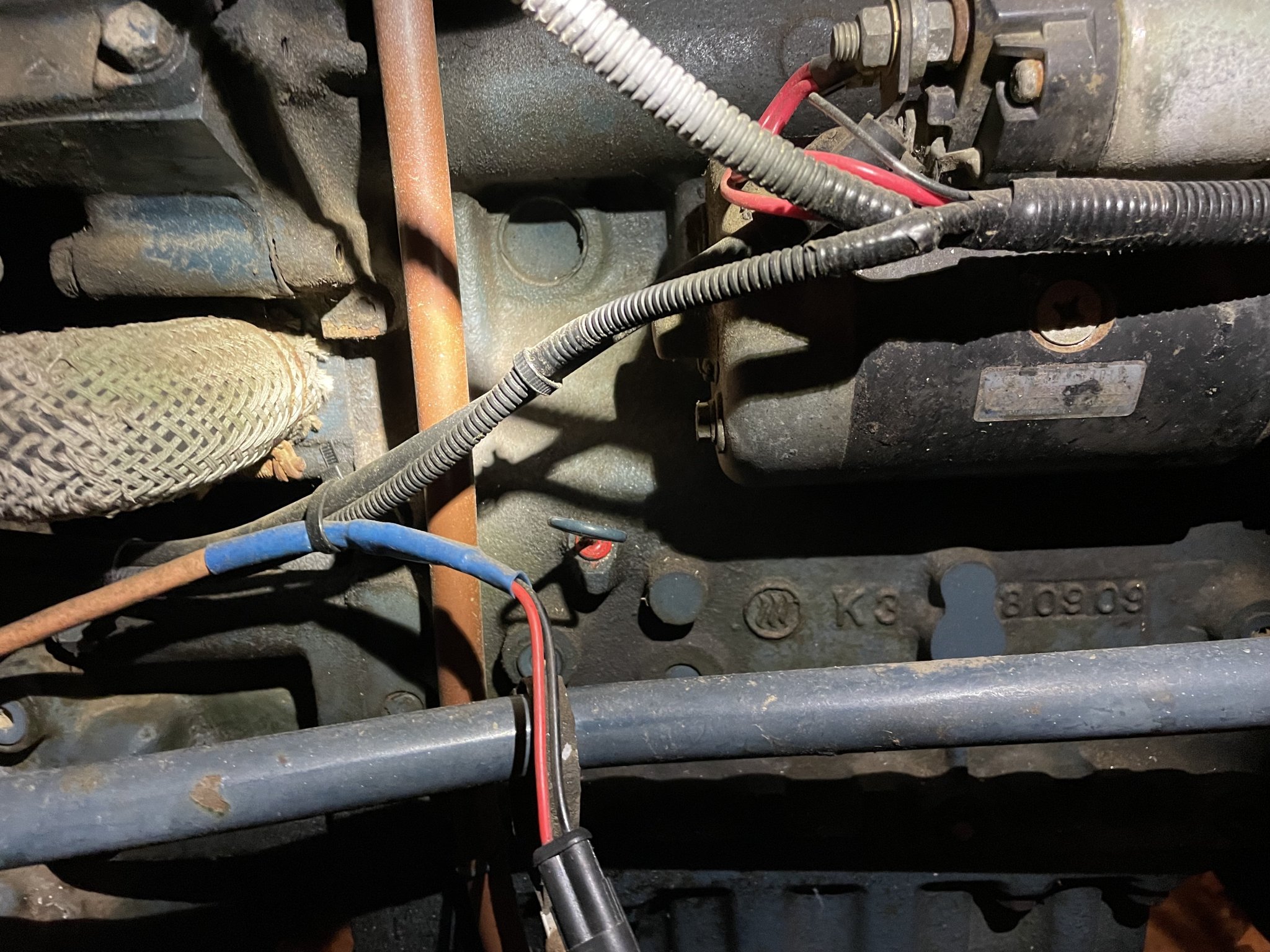

I'm looking to install a block heater in my L245DT. The ones I've seen online go into a freeze plug hole, but unfortunately, all the instructions I've found assume that the plug is removable with an allen wrench. What I have looks like a pressed in cap. You can see it here, looking at the left side of the engine just in front of the starter. (that orange wire coming in from the left attaches to the battery to hook up a trickle charger, in case you were wondering)
Is this in fact the freeze plug hole, and if so, how do I remove the cap? If it's threaded, then I should be able to unscrew it by tapping the edge with a hammer and cold chisel. If it's not, then I shouldn't be thinking of putting a block heater there, yes?

Yes that does look like a pressed in not a threaded freeze plug. You will need a block heater that has a expanding rubber seal to goes in the hole after you pop out the sheet metal plug.

To remove a pressed in core plug, take a punch and hammer and hit the plug along the left or right edge of the plug. This will generally "spin" the plug so that it is on edge relative to the hole. Remove it with a pair of pliers. Of course, you'll want to drain the coolant before you do this. My Kubota block heater has a threaded steel insert that I drove into the core plug hole and then I merely threaded the block heater into that and installed the electrical cord. Took me about a half hour including draining the coolant.

I installed a freeze plug block heater when I first had my Kubota delivered. My freeze plugs are pressed in. I used a 1/8” drill bit dipped in heavy red grease ( to collect metal shavings) drilled a hole in the freeze plug, after draining some antifreeze. Using a slide hammer, like you use to pull dents on sheet metal, removed the freeze plug. The heater element taps back in place in the freeze plug hole, using a brass punch.
It warms the engine in 15 minutes amazingly well. On single digit or negative days, I’ll plug the tractor in, enjoy a warm cup of coffee, then start the tractor.
It took longer to drain and refill the antifreeze than installing the heater.

Don't drill the plug, too easy to drill right through the cylinder wall right behind the plug.
Just tap it sideways then pull the plug out with a pair of pliers.
