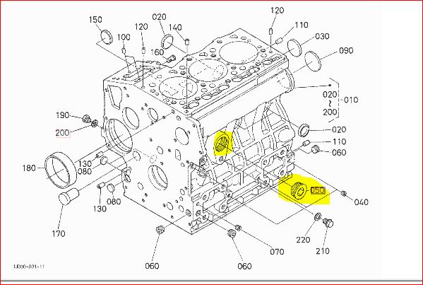

I called my local Kubota dealer today looking for a engine heater for my BX2670 and they said the parts book doesn't list one. Any suggestions?
36,878
11,559
I called Kubota checking on an engine heater for my BX2670 and service said they don't list one in the parts book. Any suggestions?
Go take a quick peek under the hood (left side), you should have a plugged hole like this (in yellow) 17mm Allen wrench. Heater is P/N 70000-73274

Ill bet the counter person looking up the parts is about like a lot of counter people at a lot of auto parts stores. they only know what they see on the computer screen. When I called parts at Kubota to check stock, they showed that thread in model for my BX. I asked if there was an adaptor for the block temp sending unit, as it is where he showed the block heater to thread into. He was holding the part, and thought the knurled rings that hold the wired plug clip in place was threads. The thread in type would be a cinch to install.
