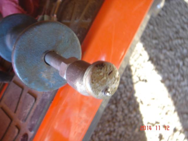

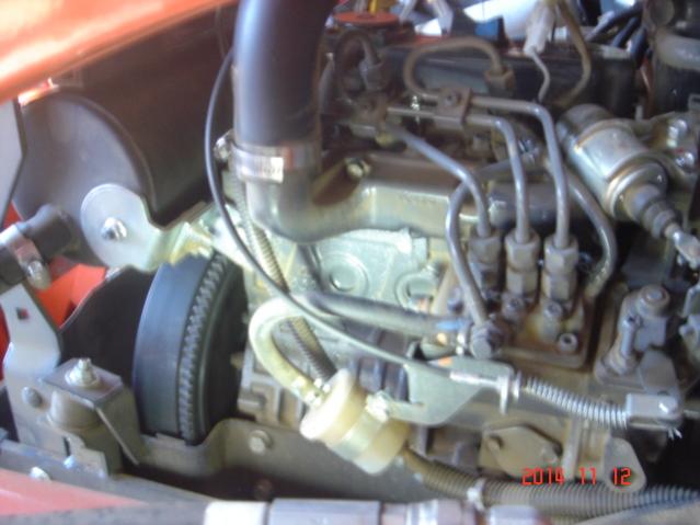

unsure about this procedure, but a quick and easy install. heres the part and freeze plug location. DSC04152.jpg
bearskinner
Sep 1, 2014
925
238
N. Idaho
popped out the plug with a slide hammer. tapped in the heater element with a socket and extension. ty wrapped the wires from moving, plug sticks out below the shroud for easy access. DSC04159.jpg
I was a little paranoid about messing with a new tractor (only 28 hours so far) but its easy to get to and a quick and easy install. If I can do it anyone can. no leaks, topped off the antifreeze, ready to go
