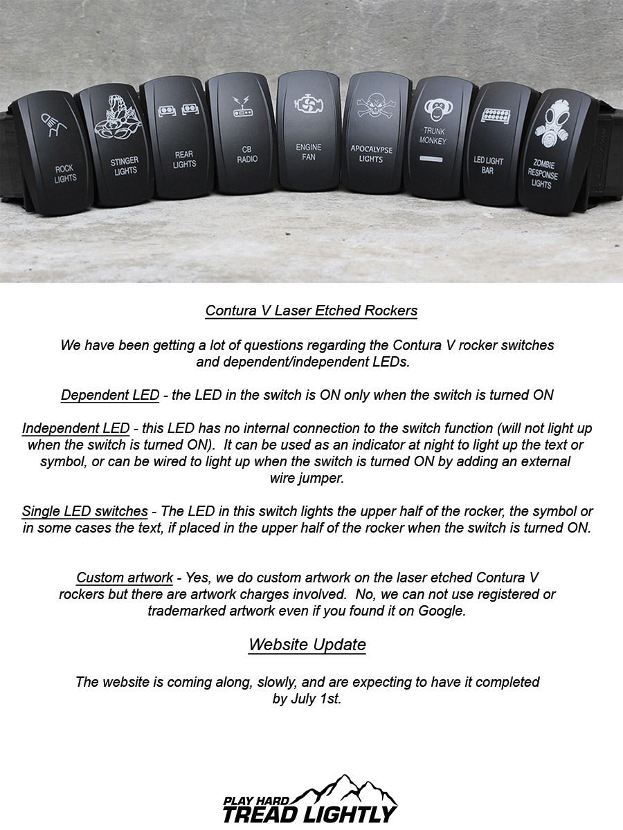

And the switches I am going to use for them.

The rock lights work GREAT. Really light up the area under and all around the tires and I can look down at my tires at night and see exactly where they are. I need to change the mount for the one on the RH side, as the brake pedal bars hit the top of it when pushing the brake hard. I just angled it down a little more for now (don't use the brakes much at all with the HST) but I'll do something more permanent soon.

Mind if I ask where you got the lights and switches?

Got the lights off Amazon, from TUF LED. Got the switches from OTRATTW.

ZOMBIE response lights,,,LMAO Wonders if you could mount them on a Ma duce,,,,lol
