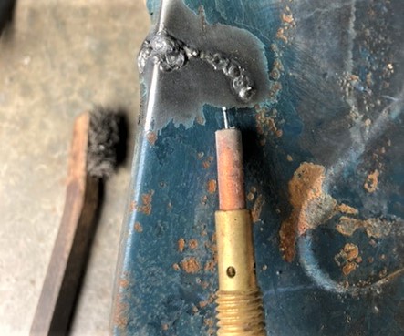

Dan_m, Good ‘enin. By no means whatsoever, am I a experienced professional welder. So take what I profess with a very small grain of salt!!
I mainly use a older Lincoln 125 Plus buzz-box to do my “around the house” welding. Usually 1/4” or thinner. My observations have been in not so much “the welding machine” as more the kind of flux-core wire thats being used. I mainly weld low-carbon steel and use
the .030 E71T-11 wire, which is “all position-multi pass” and is a regulated and certified wire. The other wire which is more commonly found, is the .035 E71T-GS, which is a single pass wire, that is not regulated or certified. Harbor Freight has sold tons of this with their machines. I’ve found that a much nicer and stronger weld can be had with the E71T-11 wire.
Also, make sure to be using the “flux-core tip” on the end of your gun. The welder usually will come with a larger gas-style tip. You most generally have to purchase the flux-core tip, which makes it much easier to see the puddle. I know you asked about “welders”, I thot I’d give a few thots that might just make that HF welder perform perhaps a bit better till something better comes along!!! Just one old man’s opinion!! Take care. Semper-fi & This We’ll Defend, Mike
