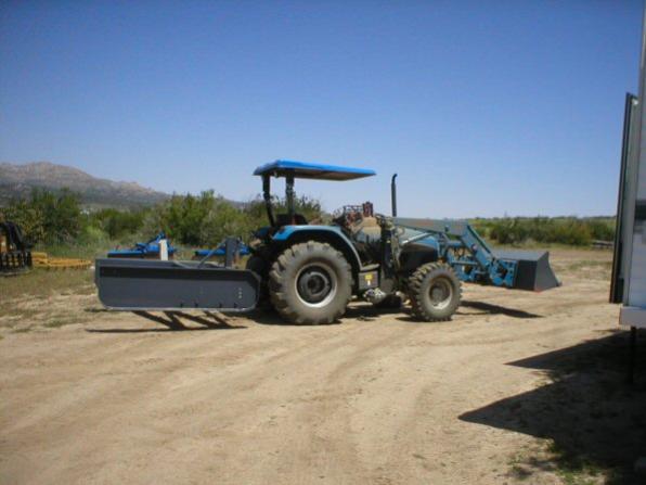

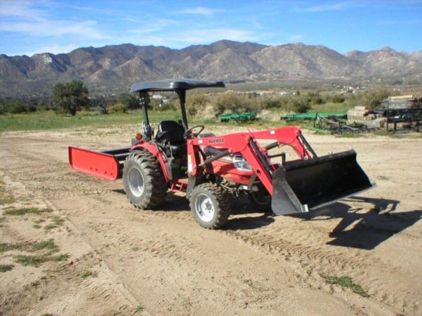

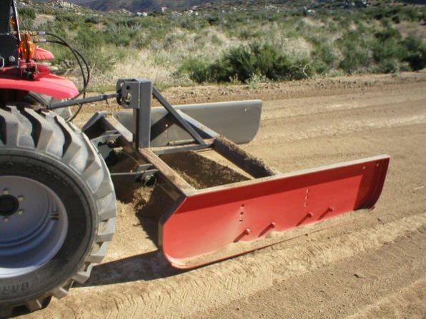

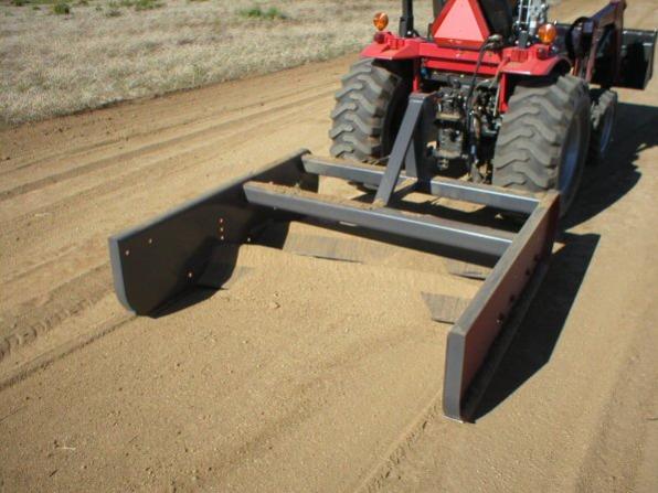

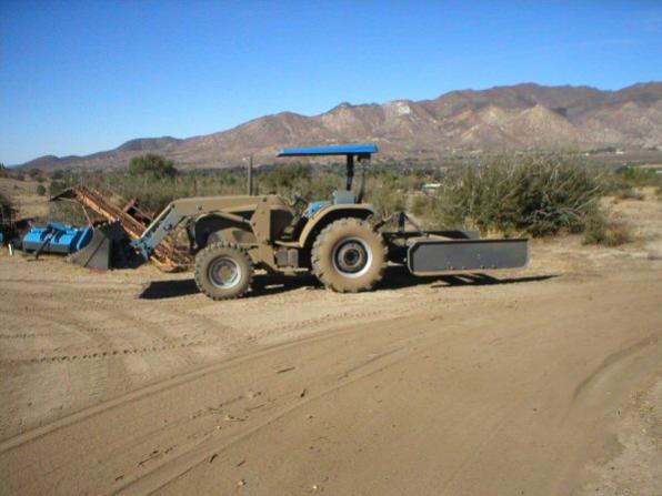

I think what you will find is that the LPGS that have the scarifiers are lighter in weight. The people that are happy with their LPGS that do not have scarifiers either have heavy units and do not need the teeth or their ground does not get rock hard.
I have 2 different units, a 5 footer that weighs 800lbs and a 7 footer that weighs 1400lbs. My ground can get pretty hard, I do not have any problems grading. From what I can tell from reading about other users, if you have a unit that weighs 150+lbs per foot of width, there is a good chance scarifiers are not needed. ;)

The sides on my 7 foot LPGS are 7 foot long. You will be hard pressed to find any that are that long today. Most are about 5 feet give or take 6". The longer the sides, the flater your surface will be.
