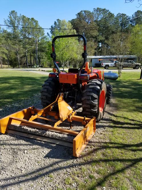

Below is what I use and have a mile of mixed gravel and sand/clay for my roads.
I maintain once a month and it takes me about 5 to 6 hours. I find it best to maintain rather than let it get bad.
My scraper is 6 foot, I did pull it with an L3400 and it was all it wanted as I try and keep material in the scraper to allow for filling in holes along the way and low spots. I now use a L4600 and it carries it well.
It does take time to get it set so I dedicate a top link to the implement. When I take off the plane I leave the link with it.
