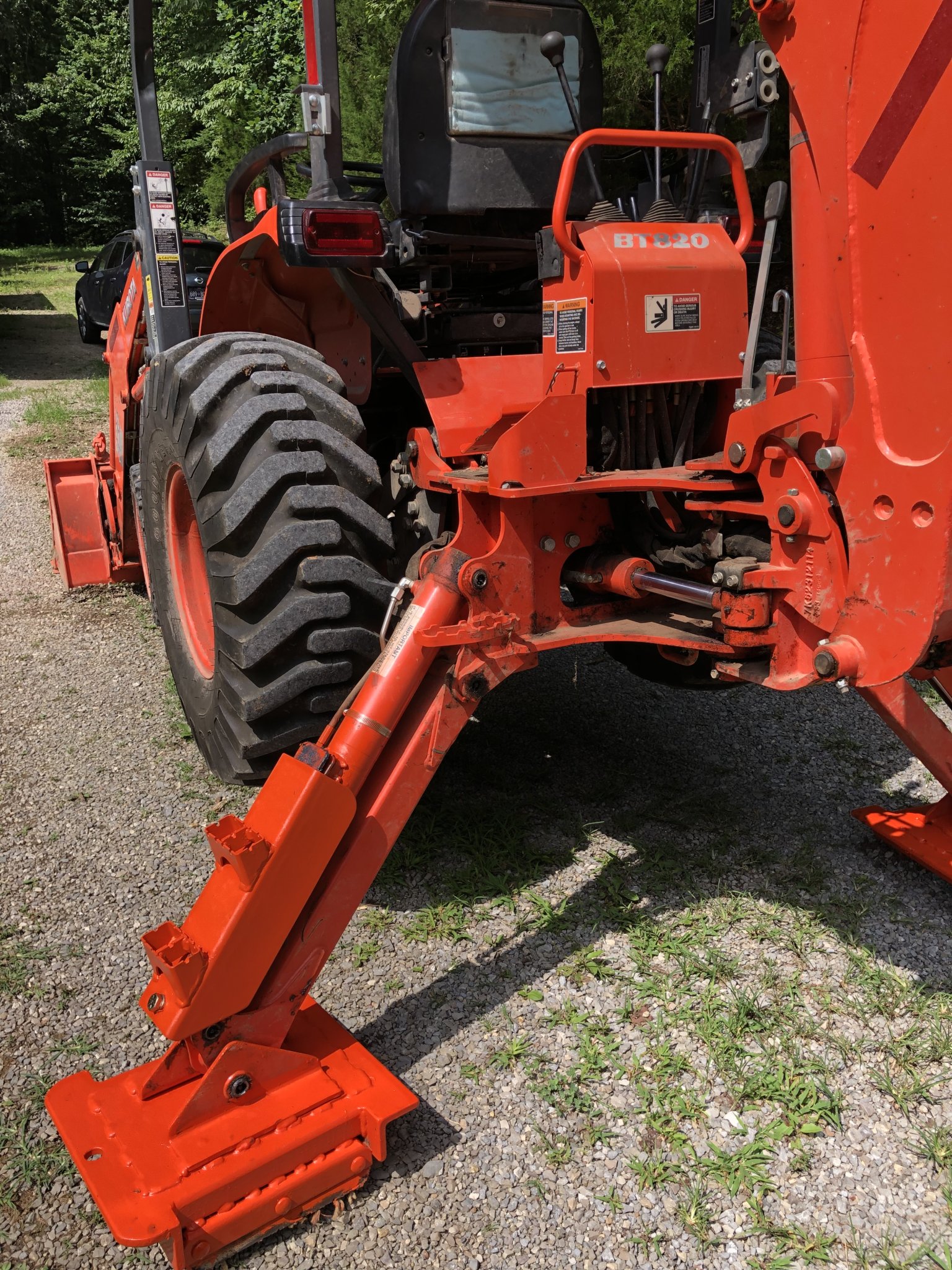

Added extra steps to stabilizer cylinder rod guards on B26. Wider and higher pads, so helps this ole man climb up and down. Hope yours has an ample hand grab bar around the controls.
