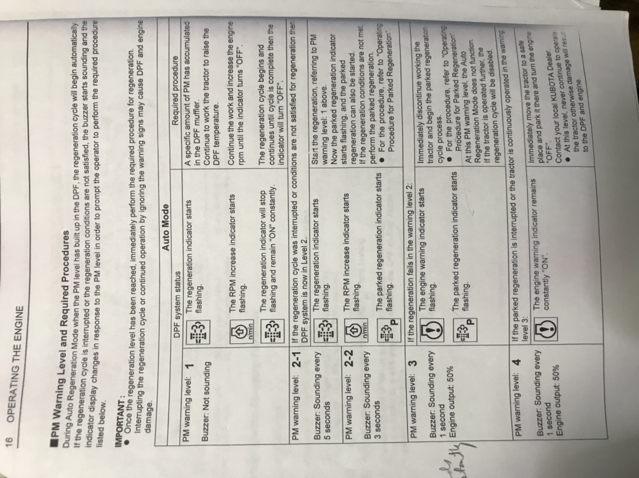

You can see from this table that right now the critical thing to know is whether the engine warning light is flashing or on constantly:
Notice that if flashing you cannot do an auto regen. If solidly on you are dead in the water. It mentions that if you continue to operate the tractor the regeneration cycle will be disabled.
I think you have reached a point where you are going to have to take it to the dealer, but let us know which puffer lights, buttons are illuminated and how fast the buzzer is sounding,and whether the engine warning light is solidly on or flashing.

Thanks for the conversation. The engine warning light is number 6 on the dash and is not flashing and the beep is per second.

If the engine warning light is solidly on, and the beep is one per second you are at level 4 soot accumulation, and it will require a dealer laptop to get it to regenerate. With luck you will not have to replace the dpf filter, but the sooner you get it there the better. It may be that you got into this predicament because one of your lights wasn’t functioning correctly, but the dealer should be able to go through the history in the ECU. Please let us know how what you find out.
