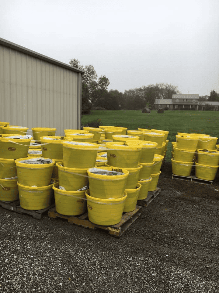

14,366
6,633
I use protein tubs with the top cut down, if need be, to fit under the tractor. Anyone with cattle will have some laying around. They will hold 20 gallons.
