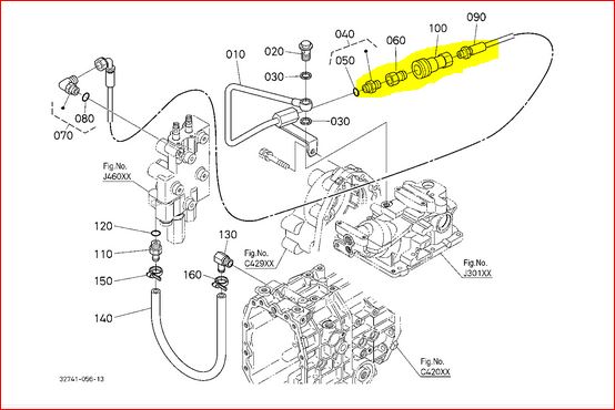

If it's off then check the feed loop, on the rear of the tractor, it will be a hose with a quick connect coupler make sure it completely connected to the male side.
If it's on check both the in and out lines to make sure both sides are connected.
I would disconnect and reconnect the fittings. ;)

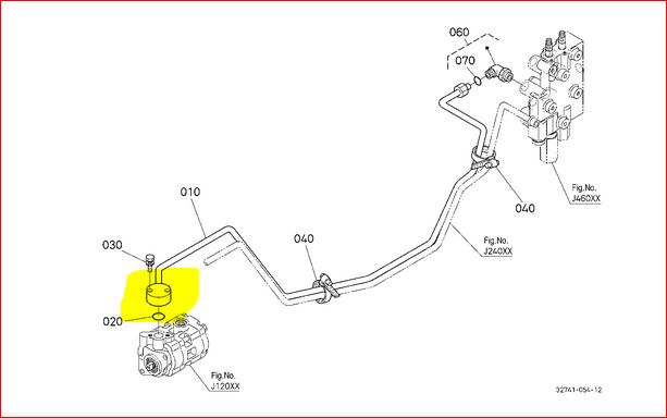

Only other explanation is that the hydraulic pump or drive has gone out, again very rare!
One move would be to loosen the output line from the pump and see if there is any flow from the pump.

If it does it again, look at the suction line from the pump down to the tank, (Yes that model has a tank on top of the amount in the case) because if it's sucking air that will lead to a ton of issues down the line. ;)
The line might not show an external leak, but because it's a suction line it will suck air into the system, so look for loose fittings, clamps, hoses, seeping leaks, or wet spots.
