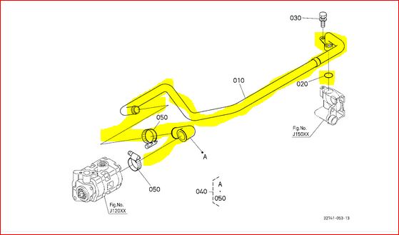

I have the repair manual. I took the rubber elbow off on the suction line and it appears to be ok (I ordered one anyway). So I put it back on and loosen the line at the cylinders to bleed off any air i could find. Took it out last night and used it everything worked fine. Come home from work today and same thing. Nothing works on hydraulic side. Steering is a little tight on the HST side but starts working after turning left and right a few times. Its not a little bit of air getting in, It is so much air the fluid gets foamy. I've got the O*ring and rubber elbow ordered for it guess Ill wait for them to come in and change them. Is there any where else it could be getting air in? I've changed the fluid and both filters (hydraulic and HST) and checked to make sure the old gasket came off and that they are tight. The O-ring should be below the fluid level of the tank, but I'm going to change it anyway. Thanks
36,519
11,283
I would pull the whole line out and inspect for wear or a crack, and replace both the 90 hose and O-ring.
Also pull filter and make sure there is not an extra gasket stuck in there.

OK I have taken the the suction tube off and inspected it. I also replaced the o-ring and the rubber elbow with new hose clamps. I also removed the hyd. pump and disassembled it. Inspected every thing inside and put it back together. Bleed the air off it worked great. Lots of power. parked it over night and when I came home from work, I started it up and no hydraulics. the steering is a little tight until I turn it several times and get the air out. The HST works also. But nothing else work. Front loader, backhoe stabilizers or 3 point hitch. After it sits it loses its prime. Why? here no hydraulic oil leaking out from anywhere The hyd. pump has 2 sides. 1 for the HST and steering and 1 for the other hydraulics. the HST side does get some air but still works the other side nothing works till I bleed the pump to get the air out. Any ideas?
36,519
11,283
When you pulled the line did you pull the filter and check for double gaskets or anything else to keep it from sealing?
Your next step is to send the pump to be tested, when they go bad they can cavitate and not create suction.

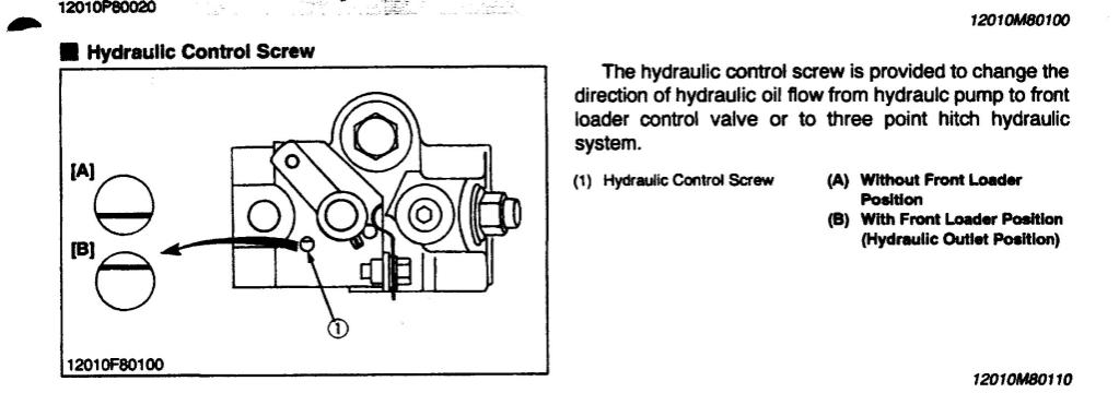

One other thing to check, not sure if the B26 has this, but many others do, ensure the hydraulic control screw is in the correct orientation, check your workshop manual, this is a pic of mine. Also if you have any quick disconnects on the FEL or on the hoses/lines supplying the FEL valve block, disconnect and reconnect each quick coupler to ensure they are fully seated home.
