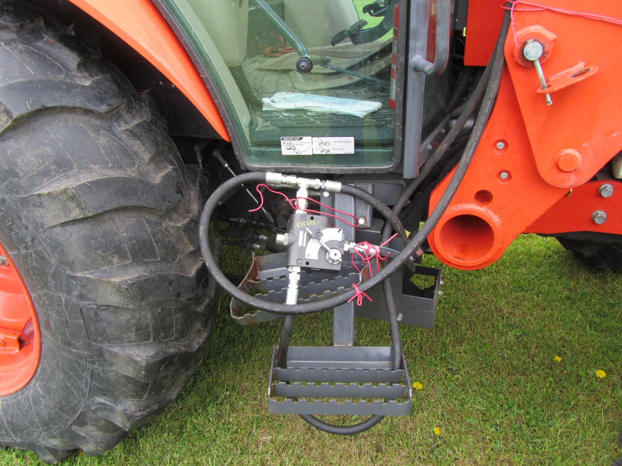

First to get this out of my mind, you do not need a motor spool. The rotating components in the motor are small and light plus the motor speed is slow.
With the pressure compensated flow control, the benefit is my rear remote with detent will stay locked in the ON position and the pressures the valve sees are lower than the kick off pressure.

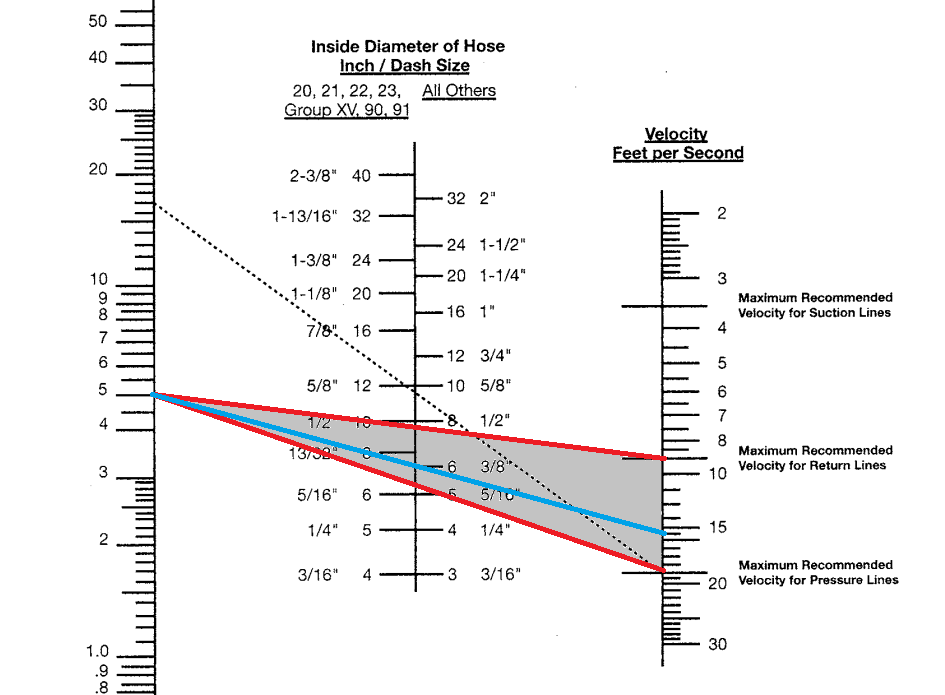

Open center system with a fixed displacement pump so unlikely the hose is restricting flow. Plus website says you only need 3 GPM which is well within the ratings of 3/8 hose. Your tractor should be able to deliver its full 5 GPM flow through that hose.
Here is a nomograph from the Parker design guide showing recommended hydraulic fluid velocity for hoses. The shaded area reflects the minimum and maximum velecities for the 5 GPM flow. The blue line shows that at 5 GPM the velecity is a very acceprtables 16 FPS. From a differrent table in that same document - at 5 GPM the pressure drop across 10 ft of 3/8" hose is 18 PSI - insignificant.

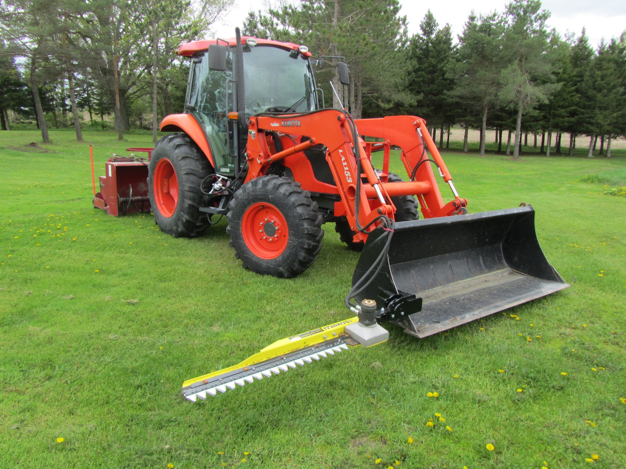

I took the Samurai to my daughter's place to trim along her driveway. She lives right out in the woods and various sorts of brush and woody weeds have encroached enough to become an issue
Whilst working with it yesterday, I discovered a bent (!) knife on the moveable bar that was causing frequent jams. I cleaned that up and things improved noticeably.
Today it worked quite well, as long as I went very slowly and didn't try to cut anything over 1/2 inch or so. It worked particularly well in vertical mode for trimming overhanging stuff.
Running it off the rear remote has one big advantage: The ability to reverse it. I got hung up a few times with thicker brush hiding in the weeds and was able to back up slowly while changing directions on the motor and get free without having to get out of the tractor.
In horizontal mode it's very difficult (if not impossible) to get the mount tight enough to keep the bar from moving. I did sandwich a couple of pieces of 1/4 aluminum (all I could get my hands on at the moment) between the mount and the bucket side which stiffened things up quite a lot, but if you're not VERY careful to feather the control when adjusting bucket height any bounce will cause the mount to slip and the end of the bar to sag.
I got the bar stuck on an unseen bit of wild cherry that was too big to cut and when I got it free the moving sickle was jammed again. Traced that to another bent sickle section. I've emailed the company to see if perhaps I got a set of blades that weren't properly hardened. I was able to straighten it and get back to work.
Finally, I'm thinking this might be a good excuse to get a blank SSQA plate and weld the mount to that. Couple of advantages to that in my mind: A) stiffer and B) a dedicated mount where all I have to do is disconnect the hoses and lift the latches.
I'm also mulling over the possibility of using a hydraulic cylinder to switch back and forth between horizontal and vertical modes (and obviously any angle in between). Not only would that make life a LOT easier when switching, but it may well solve the problem of the bar not holding position. Need to think that through a little and perhaps that'll be a Winter Project.
