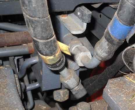

It's a cab tractor so access may be an issue, but I'll see what I can come up with. I'm VERY interested in a second rear remote as I'd love to have top-and-tilt for my box blade anyway.
Well nothing is easy when working with a cab tractor so don't worry about the pictures. The B2650 loader valve and plumbing is similar to the B2601 but I can't find info on an OEM remote kit for it with or without cab. Here is what they are using on the B2601 with ROPS. Any similarity to what is on your B2650?

Best I could do. Looks like it'd be an aggravating project!
Looks like our posts crossed. That looks very similar to the B2601 setup and aggravating is putting it mildly. Whats up front for the third function? That might be an easier way to tap into the flow especially since I just looked at the manual and now see how the Samurai mounts.
